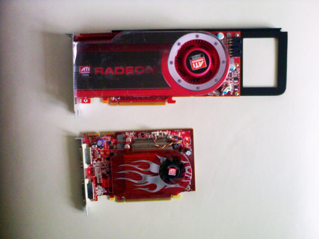

WideEyedFox Posted September 29, 2009 Author Share Posted September 29, 2009 She's a big b*tch compared to the stock card (see pic) Had to get her to wiggle her hips a bit to fit inside. Once in and firmly tightened up she looked great and goes like a racehorse. Snow Leopard cost me £319 (£39 licence + £280 graphics card). Thanks Apple. At least I'm working again now though. I was having to use either my MacBook or a laptop running Windows 7. Link to comment https://www.insanelymac.com/forum/topic/188881-mac-pro-no-display-graphics-card/#findComment-1284662 Share on other sites More sharing options...
