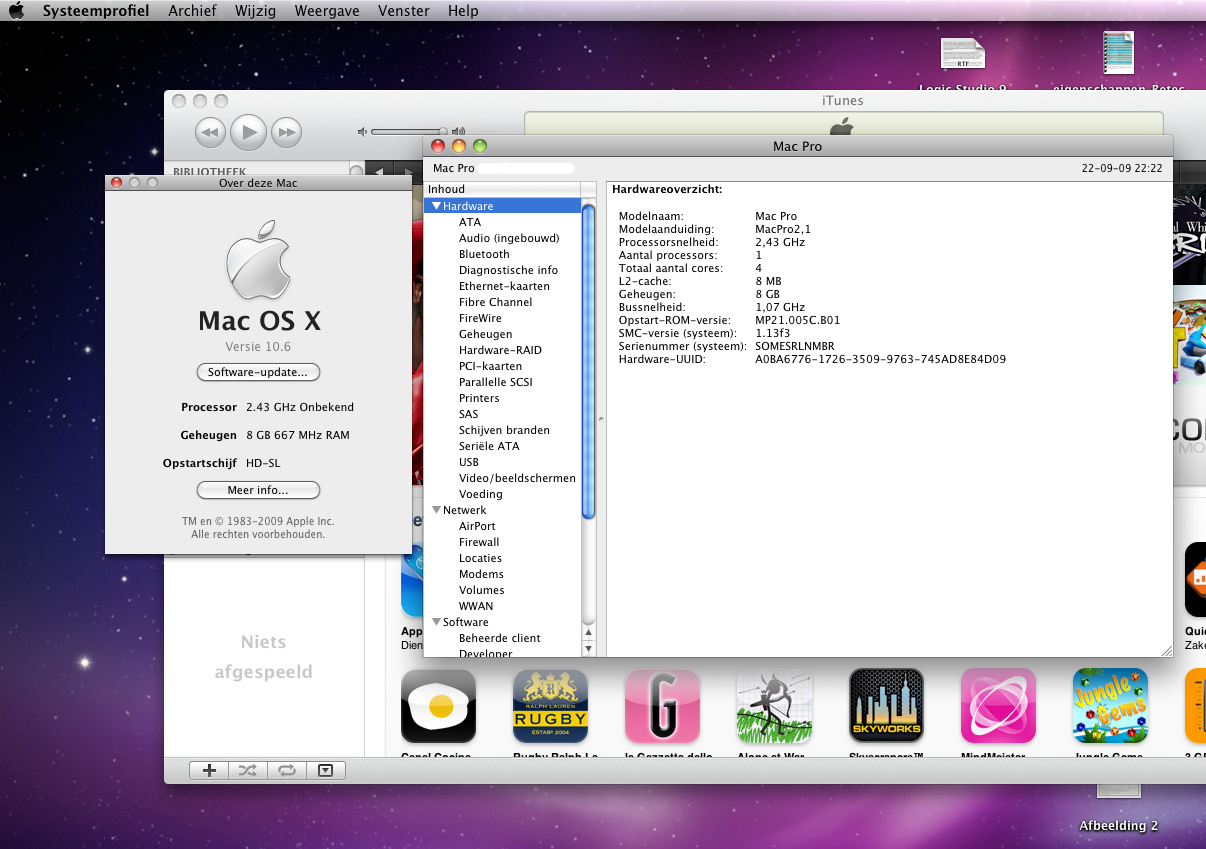

sukkel Posted September 23, 2009 Share Posted September 23, 2009 I'm running with the same MoBo, have no problems at all, except the audiohack has to be done. Did you made a DSDT-Patch? After patching DSDT the computer runs even better as with OS10.5.8 (Also with DSDT-patch). I use Chameleon 2RC3 and only the important drivers for SL: AppleACPI2NUB.kext dsmos.kext fakesmc.kext IOAHCIBlockStorageInjector.kext NullCPUPowerManagement.kext, OpenHaltRestart.kext, PlatformUUID.kext SleepEnabler.kext The Asus EN9600GT-Silent video is working with a string in the Boot.plist. I've installed this system yesterday and I'm just busy figuring out yet how to handle audio. If it is possible, I want to make it work with only DSDT-patch, and/or a string in the boot.plist. Is it me, or is Snow Leopard looking brighter as Leopard? Link to comment https://www.insanelymac.com/forum/topic/187017-ga-p35-ds3r-v10-no-sleep-1061/#findComment-1278417 Share on other sites More sharing options...
