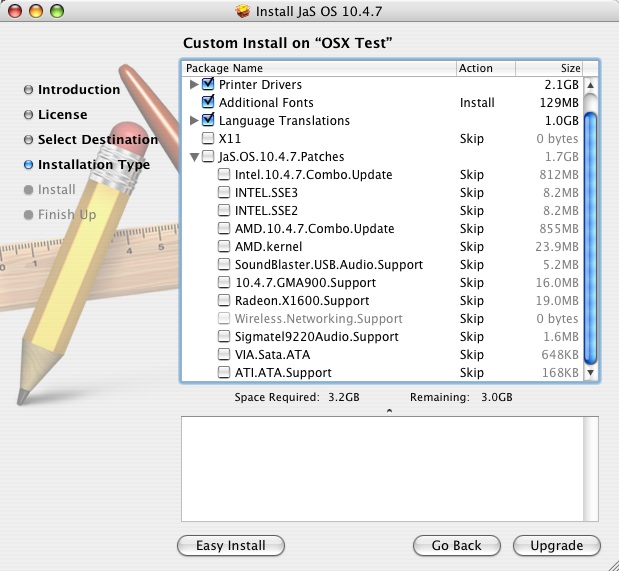

Rammjet Posted August 26, 2006 Share Posted August 26, 2006 During the installation, what packages did you select under Customize? Link to comment https://www.insanelymac.com/forum/topic/17680-problem-starting-up-osx86-after-installation/#findComment-174628 Share on other sites More sharing options...
dublea Posted August 26, 2006 Share Posted August 26, 2006 Ok, I got the JaS 10.4.7 ISO image and was able to get into install, partition an existing HD that I have set as primary. It installed without a hitch, rebooted and I get all text when booting, without even using -v command. Here are just some of the error's I'm getting... (the (Time&Date) just is the time and date I get these messages) (Time&Date) kextd[30]: kld_load_from_memory() failed for module /System/Library/Extensions/NVDAResman.kext/Contents/MacOS/NVDAResman (Time&Date) kextd[30]: a link/load error occured for kernel extension /System/Library/Extentions/NVDANV40Hal.kext (Time&Date) kextd[33]: kld_load_from_memory() failed for module /System/Library/Extensions/IOPlatformPlugin.kext/Contents/PlugIn/ACPI_SMC_PlatformPlugin.kext/Contents/MacOS/ACPI_SMC_PlatformPlugin (Time&Date) kextd[33]: a link/load error occured for kernel extension /System/Library/Extensions/IOPlatformFamily.kext/Contents/PlugIn/ACPI_SMC_PlatformPlugin.kext (Time&Date) kextd[40]: kld_load_form_memory() failed for module /System/Library/Extentions/NVDAResman.kext/Contents/MacOS/NVDAResman (Time&Date) kextd[40]: a link/load error occured for kernel extension /System/Library/Extentions/GeForce.kext Language Chooser seems to have failed; defaulting to English localhost mDNSResponder-108 (Dec 25 2005 11: 57:53)[46]: Starting localhost diskarbitrationd[52]: Unable to mount /dev/disk0s1 (status code 0x00000047) localhost DirectoryService[61]: Launch versoin 2.1 (v353.2) localhost mDNSResponder: Couldn't read user-specified ComputerName; using default bMacintosh-000000000000b instead localhost mDNSResponder: Couldn't read user-specified local hostname; using default bMacintosh-000000000000.localb instead localhost mDNSResponder: adding browse doman local localhost mDNSResponder: Couldn't read user-specified ComputerName; using default bMacintosh-000000000000b instead localhost mDNSResponder: Couldn't read user-specified local hostname; using default bMacintosh-000000000000.localb instead localhost /System/Library/CoreServices/Loginwindow.app/Contents/MacOS/loginwindow: Login Window Application Started After that, it freezes and does nothing. I can even get the grey screen that shows the Mac logo and spining wheel. It will only go to this. These messages are the only ones I can see that look like errors. I would appriciate any help I could get. Also, under customize, the only extra thing I see is JaS 10.4.7 patch... No AMD, SSE2, SSE3 or anything like that, that I see other people talking about. All I see is the normal Mac stuff and JaS patch. Link to comment https://www.insanelymac.com/forum/topic/17680-problem-starting-up-osx86-after-installation/#findComment-174704 Share on other sites More sharing options...
Rammjet Posted August 26, 2006 Share Posted August 26, 2006 Ok, I got the JaS 10.4.7 ISO image...Also, under customize, the only extra thing I see is JaS 10.4.7 patch... No AMD, SSE2, SSE3 or anything like that, that I see other people talking about. All I see is the normal Mac stuff and JaS patch. To the left of the JaS patch is a little arrow that must be clicked to reveal the various packages. You must reinstall and select the correct packages for your computer. Link to comment https://www.insanelymac.com/forum/topic/17680-problem-starting-up-osx86-after-installation/#findComment-174710 Share on other sites More sharing options...
dublea Posted August 26, 2006 Share Posted August 26, 2006 Rammjet, you do nothing but show me how much of a noob I can feel like I'm going to go try that right now and THANK YOU!!!! P.S. Why I say I feel like a noob... I set up two Mac computer labs at my college about two months ago and had to do all of the installs... I forgot about those arrows =P Link to comment https://www.insanelymac.com/forum/topic/17680-problem-starting-up-osx86-after-installation/#findComment-174715 Share on other sites More sharing options...
dublea Posted August 26, 2006 Share Posted August 26, 2006 IT LIVES!!! ROFL, and might I say THANKS agian Rammjet! Now, to get the sound and internet to work... it sees my netcard, but not my wireless... I guess its time to go look for a way to get it to work. Link to comment https://www.insanelymac.com/forum/topic/17680-problem-starting-up-osx86-after-installation/#findComment-174739 Share on other sites More sharing options...
shampoelas Posted August 27, 2006 Share Posted August 27, 2006 During the installation, what packages did you select under Customize? I don't know anymore but i know that i installed all the packages that was under "Packages". And i didn't install X11! Do you think that i has something to do with installing un-nessasery packages? Link to comment https://www.insanelymac.com/forum/topic/17680-problem-starting-up-osx86-after-installation/#findComment-175804 Share on other sites More sharing options...
macssam Posted August 28, 2006 Share Posted August 28, 2006 if you want to run nisus writer (www.nisus.com) you must install X11 you can install X11 later once your system is running Link to comment https://www.insanelymac.com/forum/topic/17680-problem-starting-up-osx86-after-installation/#findComment-175926 Share on other sites More sharing options...
Rammjet Posted August 28, 2006 Share Posted August 28, 2006 I don't know anymore but i know that i installed all the packages that was under "Packages". And i didn't install X11! Do you think that i has something to do with installing un-nessasery packages? You can't install "all" of the packages. For the one that includes patches, you must click the little arrow to reveal the individual packages. Select only the Intel packages, not AMD and since your processor is SSE2, select that and not SSE3. The packages probably look something like this: http://forum.insanelymac.com/index.php?act...ost&id=4249 And you do not need X11. It is a Windowing environment for Unix and chances are you will never need that. And it has nothing to do with Nisus Writer. Link to comment https://www.insanelymac.com/forum/topic/17680-problem-starting-up-osx86-after-installation/#findComment-175932 Share on other sites More sharing options...
shampoelas Posted August 28, 2006 Share Posted August 28, 2006 You can't install "all" of the packages. For the one that includes patches, you must click the little arrow to reveal the individual packages. Select only the Intel packages, not AMD and since your processor is SSE2, select that and not SSE3. The packages probably look something like this: http://forum.insanelymac.com/index.php?act...ost&id=4249 And you do not need X11. It is a Windowing environment for Unix and chances are you will never need that. And it has nothing to do with Nisus Writer. Yes, perfect, IT WORKSSSSSSSSSSSSSSSSSS, THANX TO YOU. :-) The sound does it, the network card works and the graphics. I don't have to do anything. Nou is a nother problem, like always with this kind of things haha. When it want's to do update, there is an update that is called: "Mac osx tiger (intel)" and is 136MB big. When it want's to install that half the way it crashed. Nothing works except the mouse, after that it won't boot anymore and i have to install the hole shabang again. I have don that nou more than 2 times cos i wanted to know if that was the tru problem, and it was and second i wanted to know if i download it and install it seperadtly maybe it works but that did not help also. So that is nou the problem and i can use that update anymore cos i know that, that makes the hole thing to crash. Any thoot's on this problem? I HAVE FOUND ANSWER TO THIS PROBLEM: http://forum.insanelymac.com/index.php?sho...mp;#entry176325 Thanks again. Link to comment https://www.insanelymac.com/forum/topic/17680-problem-starting-up-osx86-after-installation/#findComment-176318 Share on other sites More sharing options...
