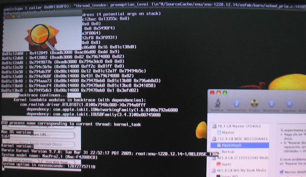

rsilves Posted July 26, 2009 Share Posted July 26, 2009 Hi. I've been getting panics frequently these last days. I moved the computer and am using the RTL8587L wireless card now instead of the ethernet cable. anyway I had used it before sometimes and it didn't cause any problem. I'd thank you if you can guide me with this, tell me where the problem seems to be. I don't know how to understand a kernel panic, so I'd be pleased if you can explain me how to, at least, have an idea of what's going on. Thanks, Rodrigo Link to comment https://www.insanelymac.com/forum/topic/176707-kernel-panics-once-or-twice-a-day/ Share on other sites More sharing options...

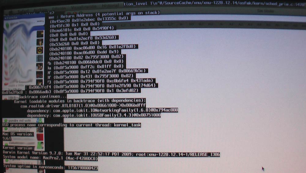

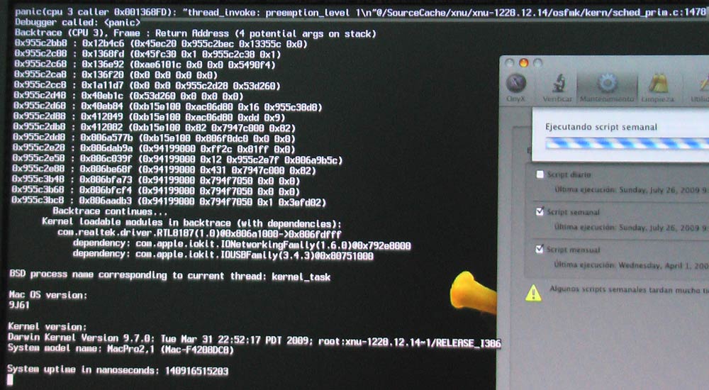

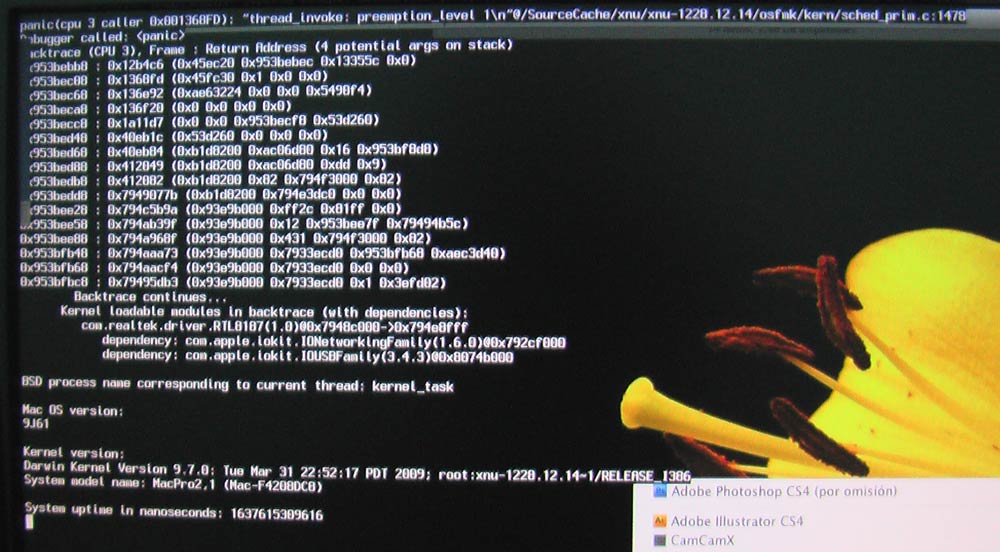

rsilves Posted July 27, 2009 Author Share Posted July 27, 2009 Again.... The first while running cron scripts (weekly in that moment) in OnyX. The second with VMWare fusion open with 1 virtual machine working (winxp), Was about to open a file with Photoshop (right click, open with, PANIC) Now I disabled the wireless card and connected via Ethernet. I hope the wireless card is not the problem, 'cause I can't keep it connected by cable. But I prefer that rather than a more complicated problem ^^ Rodrigo Link to comment https://www.insanelymac.com/forum/topic/176707-kernel-panics-once-or-twice-a-day/#findComment-1209908 Share on other sites More sharing options...
