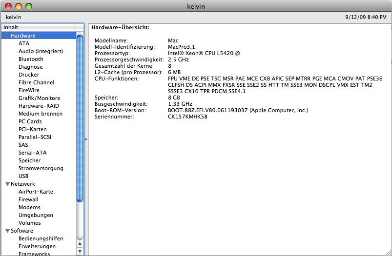

ampAIR Posted September 12, 2009 Share Posted September 12, 2009 The trick is to get a working install with 1 core , Update to EFI V9, then do DSDT patch to get all the other cores working Or run the modified bios from Kabyl, the modified bios, will give you a BSOD inwindows though... sorry, have been away from osx a while... finally, it's working now i tried the modded bios, but i still had to manually fix the already patched dsdt (remove all 'Alias' entries from the .dsl, then recompile), then i was able to reactivate acpi apic in the bios and voilà: thanks for your help again! will try to upgrade to 10.5.8 now, if that works i can finally use my hd4850 AND both monitors will check back again when it's finished. sebastian Link to comment https://www.insanelymac.com/forum/topic/175012-asus-z7s-ws-octa-core-successfull-build/#findComment-1263368 Share on other sites More sharing options...
