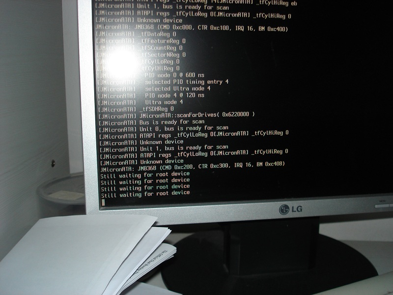

revan17 Posted July 9, 2009 Author Share Posted July 9, 2009 OK, I reinstalled iDeneb 10.5.6 and this time I manually selected some of the drivers, I didn't install them all and after the install and first restart, the PC booted to Windows 7 immediatelly! I then added an OSX entry via easyBCD and that goot me a Mac OSX boot option. In the boot menu I entered -v and this the error I get: "Still waiting for root device". Edit: Ok, after some googling I enabled ACHI in my BIOS and this took me to this screen and it just hangs there doing nothing. Come on people, there's hundreds people online, why am I working alone here? Link to comment https://www.insanelymac.com/forum/topic/174191-installing-ideneb-1056-with-windows-7-already-installed/#findComment-1196506 Share on other sites More sharing options...
Giorgio_multi Posted July 9, 2009 Share Posted July 9, 2009 Still waiting for root device is an error occurred when the southbridge is not recognized. have you a SATA HD? Have you selected ICHX-Fixed in the chipset customization? Giorgio Link to comment https://www.insanelymac.com/forum/topic/174191-installing-ideneb-1056-with-windows-7-already-installed/#findComment-1196609 Share on other sites More sharing options...
revan17 Posted July 9, 2009 Author Share Posted July 9, 2009 Yes, I'm certain I installed that fix and yes, all my HDDs are SATA. Link to comment https://www.insanelymac.com/forum/topic/174191-installing-ideneb-1056-with-windows-7-already-installed/#findComment-1196612 Share on other sites More sharing options...

Giorgio_multi Posted July 9, 2009 Share Posted July 9, 2009 Thanks for your help, Giorgio, but that seems overly complicated for a newbie to OSX like me. Try to install with voodoo kernel 9.5, Ichx-fixed + JmicronATA as chipset, no other selections (sound video, lan etc) Giorgio Link to comment https://www.insanelymac.com/forum/topic/174191-installing-ideneb-1056-with-windows-7-already-installed/#findComment-1196657 Share on other sites More sharing options...
revan17 Posted July 10, 2009 Author Share Posted July 10, 2009 Will try later today Giorgio, thanks. What about AHCI in BIOS? Should I have it disabled or enabled? Link to comment https://www.insanelymac.com/forum/topic/174191-installing-ideneb-1056-with-windows-7-already-installed/#findComment-1197041 Share on other sites More sharing options...
Giorgio_multi Posted July 10, 2009 Share Posted July 10, 2009 Will try later today Giorgio, thanks. What about AHCI in BIOS? Should I have it disabled or enabled? Enabled. Have a good night (in Canada i think). Giorgio Link to comment https://www.insanelymac.com/forum/topic/174191-installing-ideneb-1056-with-windows-7-already-installed/#findComment-1197052 Share on other sites More sharing options...

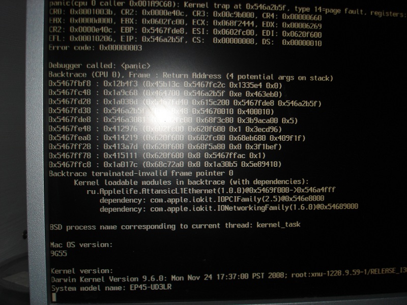

revan17 Posted July 10, 2009 Author Share Posted July 10, 2009 OK, progress is made. This time I got this error and searching brought me a solution. More info and solution here. http://www.insanelymac.com/forum/index.php...1&hl=hd3870 However, now I can't get past the registration, user profile creating because nothing on my keyboard works! Edit: I have a USB mouse and PS2 keyboard. I tried this fix: type "nano /etc/rc". You should end up in a text editor. Hold down ctrl-v to page down until you reach near the end of it. In between fi and exit 0 at the very end, at these two lines: kextunload /System/Library/Extensions/ApplePS2Controller.kext/Contents/PlugIns/ApplePS2Keyboard.kext kextload /System/Library/Extensions/ApplePS2Controller.kext/Contents/PlugIns/ApplePS2Keyboard.kext but my /etc/rc file doesn't exist or there's nothing in it. Link to comment https://www.insanelymac.com/forum/topic/174191-installing-ideneb-1056-with-windows-7-already-installed/#findComment-1197352 Share on other sites More sharing options...

Giorgio_multi Posted July 10, 2009 Share Posted July 10, 2009 Go to System Preference/Network and look at the left if there is a network controller. Wich Chip has your LAN? Giorgio Link to comment https://www.insanelymac.com/forum/topic/174191-installing-ideneb-1056-with-windows-7-already-installed/#findComment-1197449 Share on other sites More sharing options...
revan17 Posted July 11, 2009 Author Share Posted July 11, 2009 Hi Giorgio, Im in. In the tutorials section there is a thread for Realtek R111C chip, which is my LAN. I downloaded drivers from realtek site and the web appears to be working. Link to comment https://www.insanelymac.com/forum/topic/174191-installing-ideneb-1056-with-windows-7-already-installed/#findComment-1197731 Share on other sites More sharing options...
