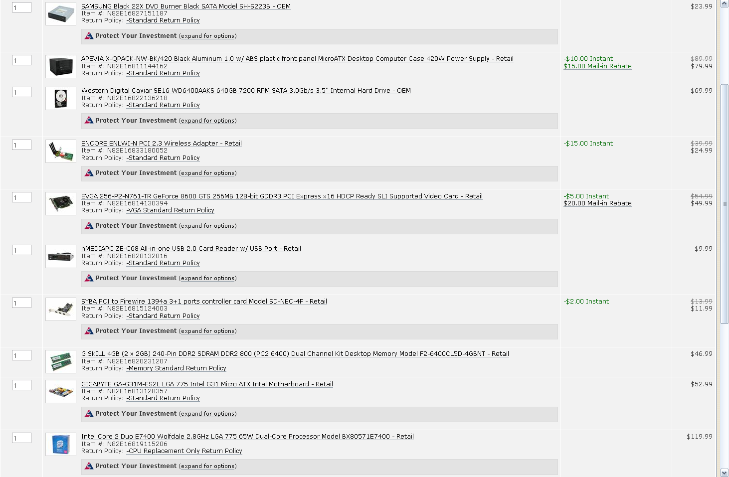

fyanga Posted June 3, 2009 Share Posted June 3, 2009 Zaap - as always, thanks for the great and thorough advice! The SATA DVD-Writer listed in your setup is OOS. How does the Samsung SH-S223B compare to the one you listed? Will that be a good enough replacement? In terms of spending an extra 200 to bump up some specs, I think this setup will do fine for me for now, and I can always tweak and adjust later on if the setup is too loud or if something is noticeably sluggish. If I wanted to bump up an extra $200, then your suggestion of going with an entry level i7 rig knocks me out of the running for this path. If I did wanna go with an i7 setup, then I'd look to spend around $1k instead. This is mostly just a fun project that would be nice to put together that would be just fast enough to do some moderate playing-around with Mac OS, so I'm sure this will definitely suffice. Lastly, I have an extra 500GB SATA drive lying around that I could put windows on. I shouldn't have to worry about any compatibility issues with this one right? I assume it should be fairly simple to get a dual-boot going on. With the basic components listed (CPU, GPU, RAM, MOBO) along side of the wireless card, 2 HDD, and mem card reader, the 420V PSU should be fine? If not, I wouldn't mind spending a little extra money on a different PSU. What do you think? Thanks for all the input! Always appreciated. PS. I've attached a screenshot of my cart. Might make the leap tonight! Link to comment https://www.insanelymac.com/forum/topic/168017-500-complete-mac-clone-possible/#findComment-1169005 Share on other sites More sharing options...
Zaap Posted June 4, 2009 Share Posted June 4, 2009 That DVD drive will work fine. Your cart will make for a great hack. Dual boot with your extra drive should be no problem. I have my own little method of dual-booting that I recommend, it includes two redundant installs of OSX (I highly recommend doing this, keep one install as a backup/utility/experiment install) dual boot with Windows, and a Time Machine partition. I posted it in another thread here. When you get your gear and set things up, let us know how it goes. Link to comment https://www.insanelymac.com/forum/topic/168017-500-complete-mac-clone-possible/#findComment-1169309 Share on other sites More sharing options...

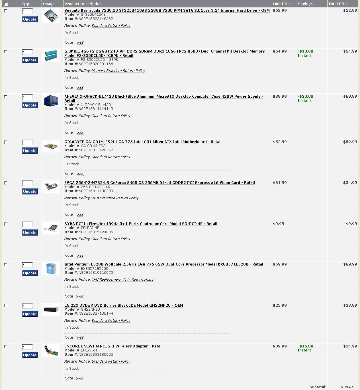

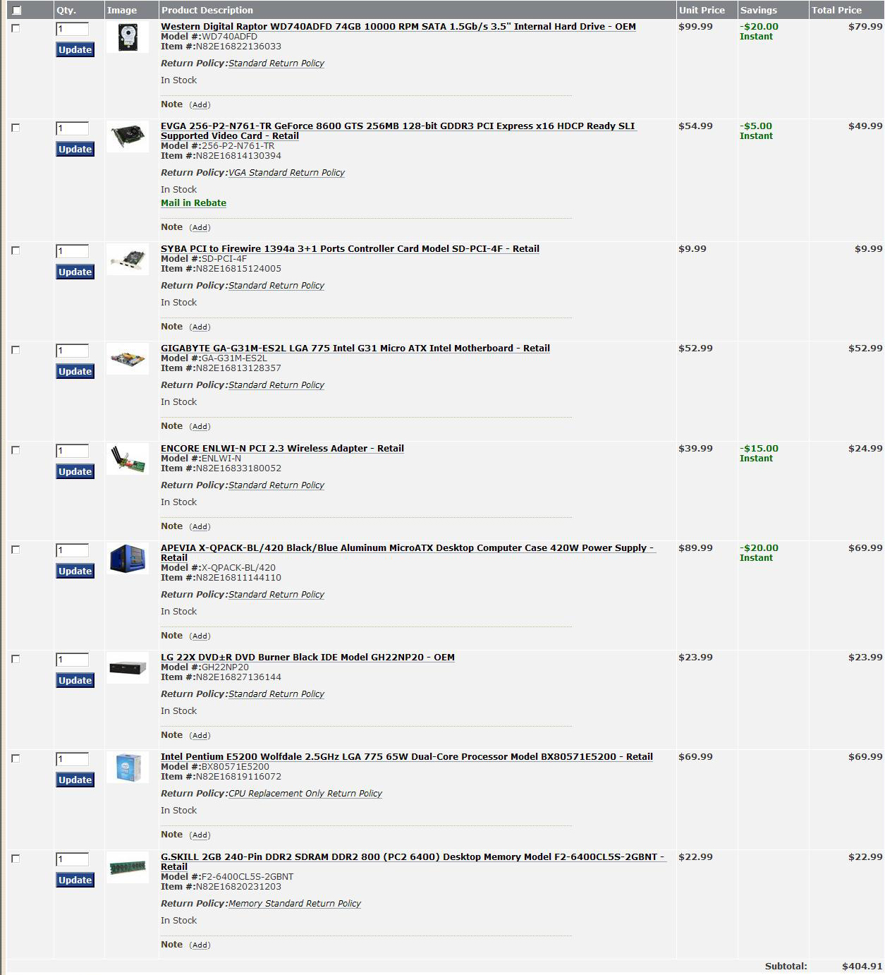

Really Posted June 15, 2009 Share Posted June 15, 2009 $404 Mac Clone? Link to comment https://www.insanelymac.com/forum/topic/168017-500-complete-mac-clone-possible/#findComment-1178470 Share on other sites More sharing options...
Zaap Posted June 15, 2009 Share Posted June 15, 2009 Yup, that'll work. Though I would add another 2GB of RAM- just 2GB is a little anemic. Link to comment https://www.insanelymac.com/forum/topic/168017-500-complete-mac-clone-possible/#findComment-1178515 Share on other sites More sharing options...
Really Posted June 15, 2009 Share Posted June 15, 2009 Added 4GB of Ram, price is now $395. Link to comment https://www.insanelymac.com/forum/topic/168017-500-complete-mac-clone-possible/#findComment-1178557 Share on other sites More sharing options...
