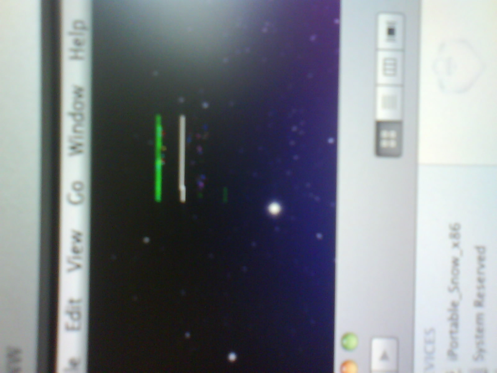

lavender.t Posted May 16, 2009 Share Posted May 16, 2009 for impatient readers, just download and unzip the attachment, overwrite /System/Library/Extensions/AppleIntelGMAX3100FB.kext/AppleIntelGMAX3100FB with AppleIntelGMAX3100FB.soft-cursor. remove Extensions.mkext and reboot with -f -v and you are done. (better make sure first that the version in Info.plist is 1.5.18.7). Â ======== if you want to know how i hacked this baby, read on ---- Â i took some time to track down the scrambled mouse when set to full native LCD resolution with AppleIntelGMAX3100FB 1.5.18.7 in IDA Pro. obviously the code is using X3100's hardware mouse cursor. somewhere it must have put in a bad register parameter and caused the artifact. AppleIntelGMAX3100FB::hwSetCursorState() looks to be slightly different btw .18 and .24, but tracking every detail down would just take too much efforts and even if i nailed it, it would be hard to fix at the binary level. Â since the screen and window all are perfectly drawn, i believe the software cursor would just work fine. all i need to do is to hack the code telling the system that it doesnt support hardware mouse. sound to be a really promising quick fix. Â so i took a few glances at the apple developer website for class IOFramebuffer (http://developer.apple.com/documentation/Darwin/Reference/KernelIOKitFramework/IOFramebuffer_h/Classes/IOFramebuffer/index.html). it first appears to me that if getAttribute() method returns FALSE for kIOHardwareCursorAttribute, then the system would use soft cursor. Â quickly located in IDA pro the instructions to return TRUE for kIOHardwareCursorAttribute. and in HexEdit, search for binary sequence: 31 C9 C7 00 <01> 00 00 00, then replace <01> with <00>. rebooted the system and set my display to max resolution -- voila ! the artifact is gone !! Â but sadly very soon i found another culprit -- if the LCD went to sleep and woke up, the mouse artifact reappeared. read further down the code, i realized that on wake up the system could've called the override function AppleIntelFramebuffer::setCursorImage() directly without checking the attribute, which triggered the hardware cursor. Â the IOFramebuffer documents says that setCursorImage() needs to return kIOReturnUnsupported to hide the hardware cursor. using the same approach, i found the starting offset of setCursorImage() was at 0xEECC. so i just went ahead and patched the first 6 bytes of the function to: B8 C7 02 00 E0 C3 (mov eax, 0xe00002c7 retn). and that's it !! the mouse cursor now works perfectly ! Â - lt x3100.soft_cursor.zip Link to comment https://www.insanelymac.com/forum/topic/166695-solved-x3100-mouse-artifact-in-full-resolutions/ Share on other sites More sharing options...
