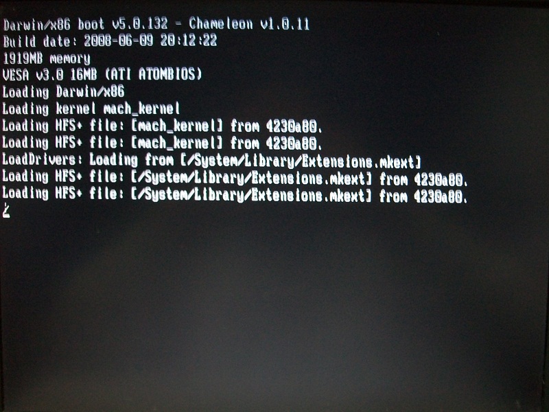

RoxXx Posted May 26, 2009 Author Share Posted May 26, 2009 Agora tentei novamente com as versões: Kalyway_10.5.2_DVD_Intel_Amd iPC_OSx86_Leopard_10_5_6_Intel_AMD_SSE2_SSE3 iDeneb_v1.4_OSx86_ISO e continua mesma coisa, quando entra naquela tela preta do darwin ele reinicia, o que pode estar acontecendo? Eu tenho que configurar alguma coisa na bios? Isso já aconteceu com algum de vocês?? Link to comment https://www.insanelymac.com/forum/topic/165158-mac-no-meu-pc-asus-k8n-ai-series/#findComment-1163935 Share on other sites More sharing options...
thiagomorales Posted May 26, 2009 Share Posted May 26, 2009 Isso tá parecendo suporte as intruções SSE2/SSE3... Link to comment https://www.insanelymac.com/forum/topic/165158-mac-no-meu-pc-asus-k8n-ai-series/#findComment-1163967 Share on other sites More sharing options...
RoxXx Posted May 28, 2009 Author Share Posted May 28, 2009 Isso tá parecendo suporte as intruções SSE2/SSE3... Mas meu processador tem suporte SSE2 e SSE3... Link to comment https://www.insanelymac.com/forum/topic/165158-mac-no-meu-pc-asus-k8n-ai-series/#findComment-1164676 Share on other sites More sharing options...

RoxXx Posted June 1, 2009 Author Share Posted June 1, 2009 Ta ai um vídeo que eu fiz mostrando o que esta acontecendo... http://www.youtube.com/watch?v=-MdQ_pTDveY Link to comment https://www.insanelymac.com/forum/topic/165158-mac-no-meu-pc-asus-k8n-ai-series/#findComment-1167726 Share on other sites More sharing options...

PsyDragon Posted July 29, 2009 Share Posted July 29, 2009 kara isso acontece (vi isso nesse video http://www.youtube.com/watch?v=3kHPZ7OaL00...feature=related ) pq o seu pc naum aceita o Mac Link to comment https://www.insanelymac.com/forum/topic/165158-mac-no-meu-pc-asus-k8n-ai-series/#findComment-1212354 Share on other sites More sharing options...
morelli Posted July 29, 2009 Share Posted July 29, 2009 esquece este pensamento de que placa devideo � a causa. se uma placa de video n�o � reconhecida, (a sua n�o sera com certeza), ela sobe como VESA, mais n�o da restart nenhum na maquina, vc s� n�o conseguira usar sua maquina para mais nada alem de internet. a causa do restart, poderia ser duas coisas. uma se vc estivesse dando boot usando kernel Vanilla. a outra incompatibildade de seu chipset, n�o se qual � pois vc n�o postou, mais com certeza � o chipset mais imcompativel que existe "NFORCE", porem nestas vers�es hackeadas sempre tem alguma gambiarra que ajude a passar desta faze, porem no seu caso isso n�o esta ocorrendo. outra coisa seu teclado e mouse tem que ser USB, pode usar Adaptador. pq vc esta dando boot usando -x -f -v ? ja experimentou apenas o -v ? olha em AMD, n�o da pra fazer milagre, sua maioria nnao consegue subir mesmo, priincipalmente maquinas antigas. Link to comment https://www.insanelymac.com/forum/topic/165158-mac-no-meu-pc-asus-k8n-ai-series/#findComment-1212450 Share on other sites More sharing options...
Jullian Pablo Posted March 8, 2010 Share Posted March 8, 2010 Ola a todos.. Bem, meu problema e exatamente igual ao dele.. Eu baixei o iPC 10.5.6, gravei no DVD.. ok.. Tenho ja o Windows 7 instalado, e criei a particao com 120gb em FAT32, ate aí tudo bem. Dai, reiniciei, dei boot pelo DVD e quando apertei enter, mal comecou a carregar o Darwin, menos de 10 segundos, e reiniciou.. nem entrou no instalador.. achei estranho, tentei denovo em verbose.. comecou a carregar, nao encheu metade da tela e reiniciou.. tentei o "cpus=1".. nada.. tentei "-v -f -x" nada.. Abaixo esta uma foto da tela, antes de reiniciar.. Me aconselharam mecher em config da bios, mas eu nao manjo praticamente nada de bios. Entao, se alguem tiver a paciencia de me explicar caso tenha algo disso, sou mesmo agradecido. A configuracao do meu PC esta listada abaixo, na assinatura.. Desde ja, obrigado.. Link to comment https://www.insanelymac.com/forum/topic/165158-mac-no-meu-pc-asus-k8n-ai-series/#findComment-1425175 Share on other sites More sharing options...

Alex Novelli Posted March 8, 2010 Share Posted March 8, 2010 A sua HD é SATA? Se não for, esquece Mac. Se for, tente entrar na BIOS e habilitar a opção SATA como AHCI. Abs Link to comment https://www.insanelymac.com/forum/topic/165158-mac-no-meu-pc-asus-k8n-ai-series/#findComment-1425529 Share on other sites More sharing options...
