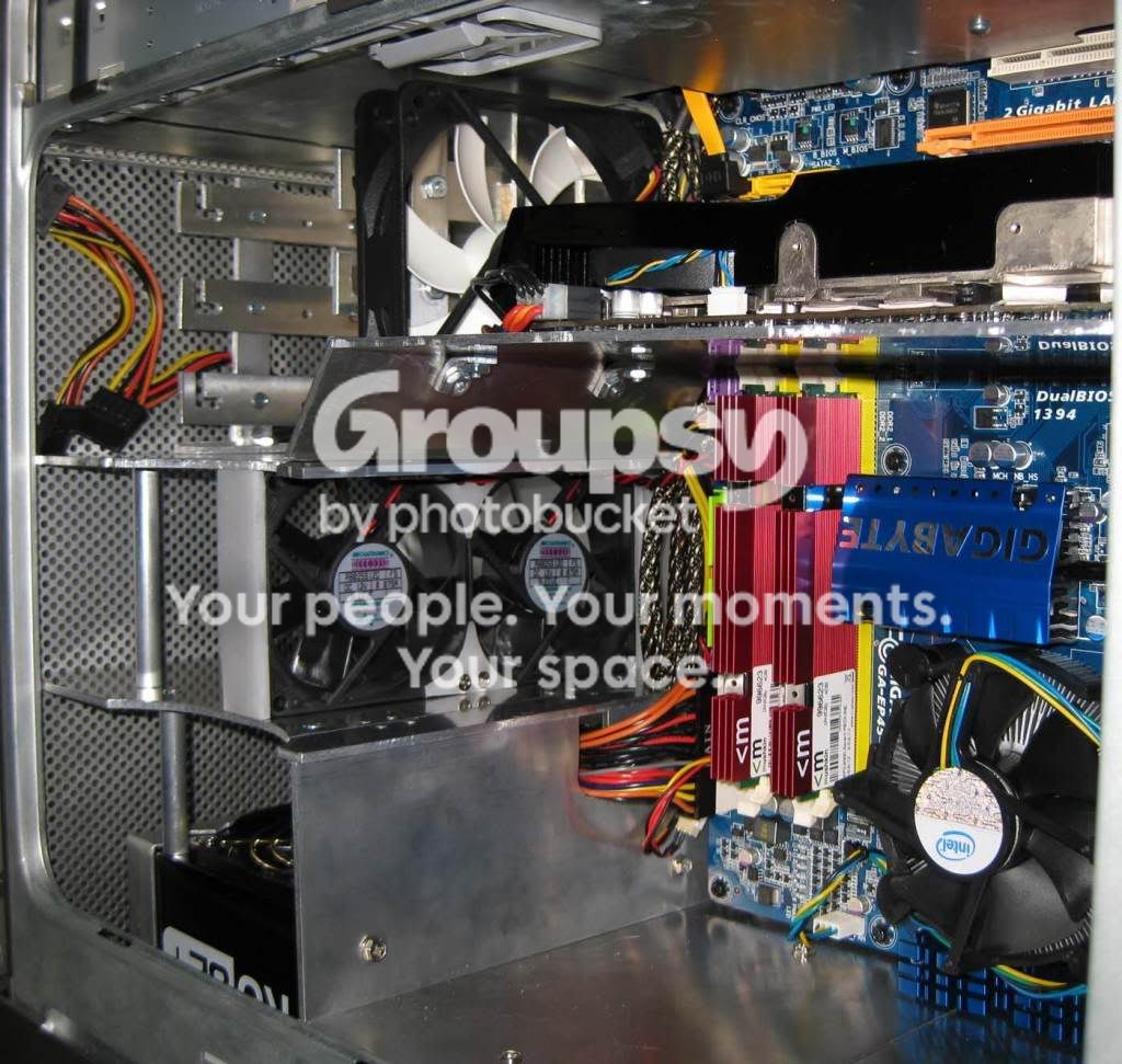

Distemperus Posted March 31, 2009 Share Posted March 31, 2009 Having just JB Welded the standoffs of my ATX motherboard in place, your rendition doesn't reflect the true sizing of the motherboard: 1. the DVD & motherboard are closer. My Pioneer (one of the longer drives, others may be 1cm shorter) & motherboard overlap. It isn't a problem as they aren't on the same plane, but the motherboard is behind the DVD drive my about 5mm. 2. An ATX motherboard is longer than in your rendition - it needs to extend into either the drive or PSU zone by at least 1cm. In my case, my motherboard is about 7mm above the plane of the top edge of the PSU plug. The drive plate intersect my motherboard in the middle of the last PCI slot - I cut the plate. If you mean iCage as in Thermaltake iCage, I don't think it will fit in the upper drive zone area. I know for sure a 120mm fan won't fit. Just seating a 3rd drive would require jumping through hoops because the steel frame surround requires you to angle things to get to the top of the case. I'm not saying that 3 can't be done.... A PSU can be squeezed into the space - that's 86mm. I see a bold black line between the 120mm fans & the rear of the case - zoning? I love it! In fact, I have very much the same concept in my case (its party finished). Unfortunately my motherboard doesn't arrange things as nicely as yours. I'm not a big fan of the 40mm fans - i want it quiet, and the bigger you get, the slower you can go. 60mm fit there just fine, but may not suit what you are planning. I look forward to seeing what it looks like. Link to comment https://www.insanelymac.com/forum/topic/159138-hackint0sh-in-g5-case-concept/#findComment-1120003 Share on other sites More sharing options...

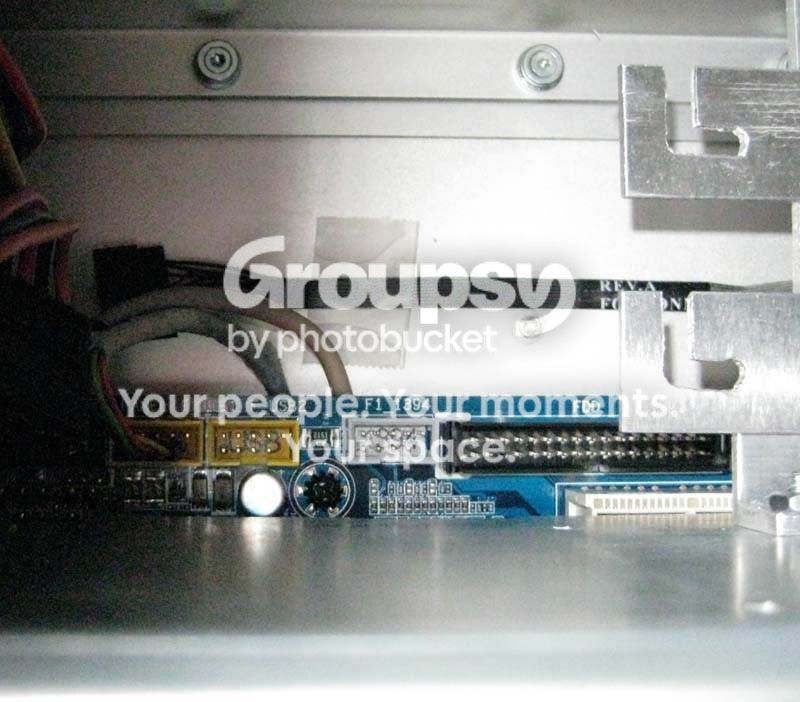

Distemperus Posted April 17, 2009 Share Posted April 17, 2009 As I don't have the case right now, I haven't got the possibility to take measures. If it doesn't fit in, I'll find another place for it. I'm not sure, but doesn't the G5 have 3 HDD slots there? No, the original rack stores only 2 drives. The bottom one goes right in. The top drive has the rear screws go in the middle slot, but then it zigzags up to the top - and the front screws go in the top slot. The middle slot isn't available as a storage space - only to maneuver the upper drive in& out. Looking forward to see pics of yours! I just happened to have wrapped up the majority of my mod. Still have to mount the 120mm fan & waiting on 2 60mm Sanyo fans. Plus a CPU cooler - requiring me to pull out everything to get at the motherboard... Here are some pix of where it will be for ahile: I bought my case in early January. I had cardboard mockups - still screwed up in places. Lots of compromises had to be made - just the other night I discovered I lacked the Herculean strength needed to bend the 1/8" thick aluminum plate the PCI zone plate is made of. The plexi bump-ins which I so hated at first, I made into an asset - preventing plates from lateral movement. I'm still wondering how to mount the 120mm & 2x60mm fans - I fear some velcro may not be too far off [is there a facepalm emoticon?]. ------- If you are going to be pulling out the plate the drives sit on, you're gonna need a Torx T-8 bit & a 7/64" hex key (it could be metric in reality). If you are going to try removing the rear fan grill assembly, you are gonna need a #1 Philips bit. I got tired of the Microcenter/HomeDepot runs - you mind as well get some cheap ebay toolset while you can. ------------------------------------------------------------- July 12, 2009 update added a Scythe Mugen 2 cooler. Fits perfectly without any modifications. The CPU socket on the motherboard (Gigabyte EP45-UD3P) is positioned favorably so the cooler doesn't extend beyond the motherboard. And the whole interior with 2 drives (2.5TB total) in upper zone (only 1 60mm fan fits with all the cabling there). 9 total fans. Link to comment https://www.insanelymac.com/forum/topic/159138-hackint0sh-in-g5-case-concept/#findComment-1134970 Share on other sites More sharing options...
Thath0r Posted April 17, 2009 Author Share Posted April 17, 2009 Nice mod, there and also nice zoning! So you used Aluminium for the zoning, right? As I'm not very talented in metal processing I'll stick to the plexiglass version. And everything can easily be attached to it (fans, etc.) About the iCage: I thought about cutting out some space in the plate the drives sit on. So the iCage would fit in even so. But I'm going to think about all thsi when I got the Case and time to think 'bout it. Thanks for your pics. /Thath0r Link to comment https://www.insanelymac.com/forum/topic/159138-hackint0sh-in-g5-case-concept/#findComment-1135224 Share on other sites More sharing options...
