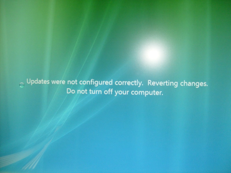

timothys89 Posted June 16, 2009 Share Posted June 16, 2009 Thanks for the uploads. Sadly, I saw no difference when I installed your files. Hmm... This is what I would do. I would backup everything you need on an external drive and completely reinstall OS X using the iDeneb 1.4 disk. Select the Intel Chipset SATA drivers, default kernel (nothing selected), and the ALC883 sound patch along with any of the programs you want (definitely OSX86 Tools). I would then update to 10.5.7 using the iDeneb 10.5.7 Combo Update and reinstall everything. I know it seems like a hassle but in my opinion it would be worth it to have everything working properly. ALSO! Before you go and do that, try deleting all the kexts that have to do with audio and then installing the ALC883 3 Ports package. Maybe that would fix it? One last thing, have you tried editing the kext files to match it to your device id exactly? Sorry for typing so much but I think this is a great site and a great mobo. The funny thing is, OS X runs better than Vista on my machine (see attached image, after an hour of updating this is what I get...). Link to comment https://www.insanelymac.com/forum/topic/156729-alc883-sound-input-gigabyte-ga-g31m-es2l-mobo/#findComment-1179481 Share on other sites More sharing options...
