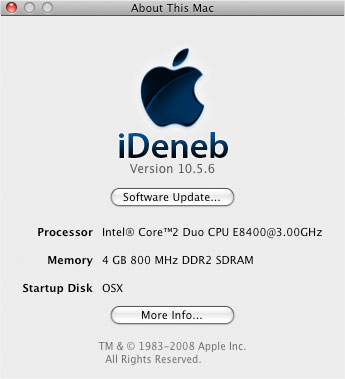

I'm pretty new to all this but I have a really good Hackintosh running. I build it to compile XBMC which it does awesomely. My problem is when I plug in my USB Hard drive it imediatly crashes with the You have to hold down the button screen and I have to reboot it.
Hardware is as follows
GA-G31M-ES2L Motherboard
Core 2 Duo E8400 CPU
4 Gigs DDR2 800 Memory
80 Gig SATA HD
HD 3870 Video Card
Pretty standard stuff really. And like I said it runs GREAT until I plug in the drive.
The drive works perfectly with all of my other PC's but to make sure it wasn't a file system issue I nuked the volume, so it is blank.
Do I need to inject some kind of driver? and if so, how do I go about doing this?
Any help is appreciated.
