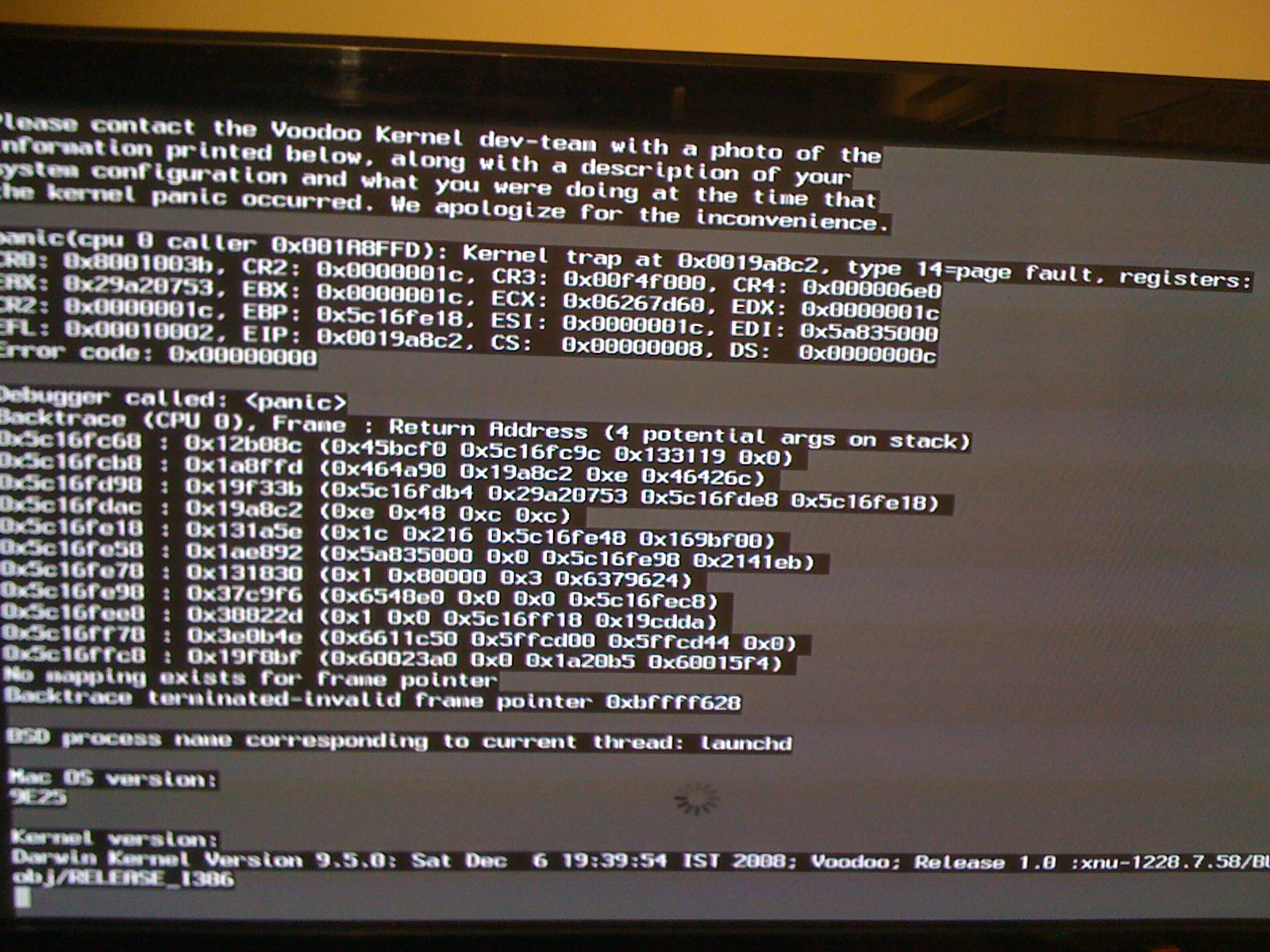

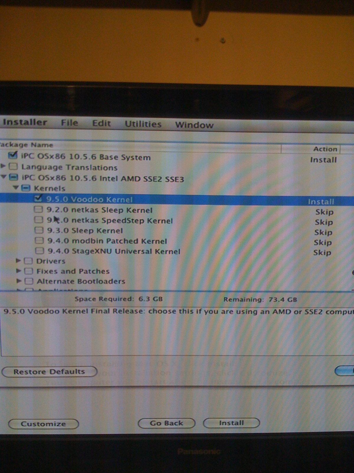

Caprica01 Posted March 2, 2009 Author Share Posted March 2, 2009 I've got an AMD (Athlon 5200) as well.. and have gotten 1 step further.. using iPC 10.5.6 I can boot from the DVD and run the installer (the liveDVD fails with an unbound error). I believe for AMD we need the Voodoo kernel (iPC has it). I can get the install to complete, but then it fails to boot. That's where I am stuck now. I pulled the original drive in the PC and used a spare/old 60G laptop SATA drive.. used Disk Util to format that and do a clean install. Not sure if that makes any diff. What did you do to get that far? Link to comment https://www.insanelymac.com/forum/topic/155779-install-help-for-amd-x64-system/#findComment-1096209 Share on other sites More sharing options...

Caprica01 Posted March 3, 2009 Author Share Posted March 3, 2009 OK, I've finally managed to install OSx on my system. I had to change how the system saw the attached sATA devices. I had to change them from ide to ACHI I think the option was. Did that, and boom! Booting straight from DVD, not problems. Formatted the partition I had set up, chose the the correct settings for my system. I think!, and installed. My only problem now is that after install, it requires a re-boot, and when it reboots, it wont load up. It looks like I might be having some problems with the graphics adapter. The screen just displays alot of blocky purple like things on the screen. Dont whether it's just going to be a matter of playing with the options in the customize menu to see which one works. Link to comment https://www.insanelymac.com/forum/topic/155779-install-help-for-amd-x64-system/#findComment-1096895 Share on other sites More sharing options...

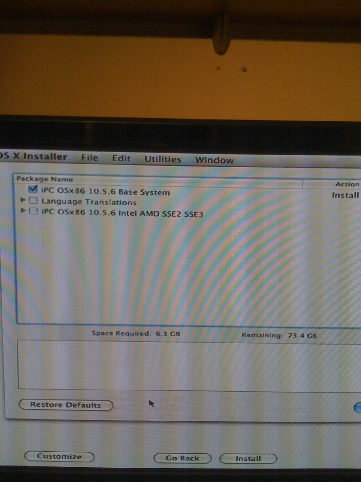

StiBa Posted March 3, 2009 Share Posted March 3, 2009 I have a MSI K9A2 Platinum V2, though this has SB600 south bridge, I get a similar firewire and security modes error, but it boots and installs fine (lawlessppc). You could try not installing a graphics driver at the "customize" stage of the installer... Will run in VESA mode, this is better than nothing.. Use Universal OSx86 Installer to set resolution.. What dist. installed on your system? Link to comment https://www.insanelymac.com/forum/topic/155779-install-help-for-amd-x64-system/#findComment-1096914 Share on other sites More sharing options...

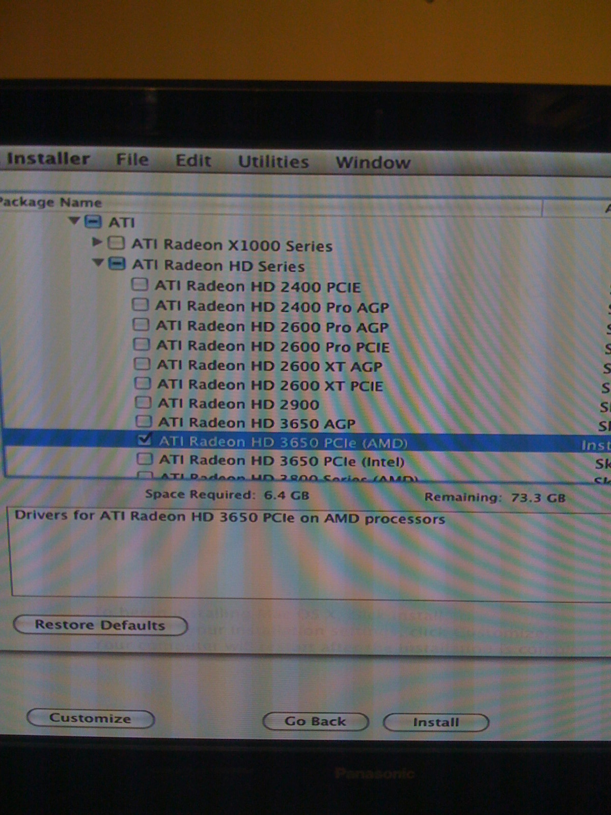

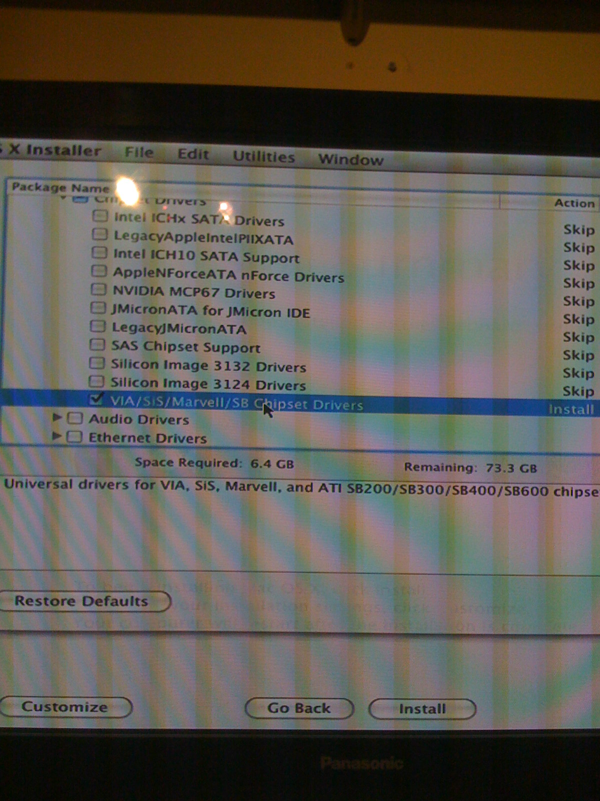

Caprica01 Posted March 3, 2009 Author Share Posted March 3, 2009 I have a MSI K9A2 Platinum V2, though this has SB600 south bridge, I get a similar firewire and security modeserror, but it boots and installs fine (lawlessppc). You could try not installing a graphics driver at the "customize" stage of the installer... Will run in VESA mode, this is better than nothing.. Use Universal OSx86 Installer to set resolution.. What dist. installed on your system? I'm installing the iPC distro. Just going to upload some screens of the customize options I'm selecting. CUSTOMIZE OPTIONS ================= Kernel: Voodoo 9.5.0 Video: ATI Radeon HD3650 PCIe AMD Chipset: VIA/SAS/SB Chipset (mine is SB700 chipset. Only support upto SB600 on this option) Audio: ALC888 0 Apple HDA Wireless: Atheros AR5007EG USB: Patched USB Drivers Apps: OSx86 Tools Utilities =================================== When the system re-boots I get a kernel panic Link to comment https://www.insanelymac.com/forum/topic/155779-install-help-for-amd-x64-system/#findComment-1096936 Share on other sites More sharing options...

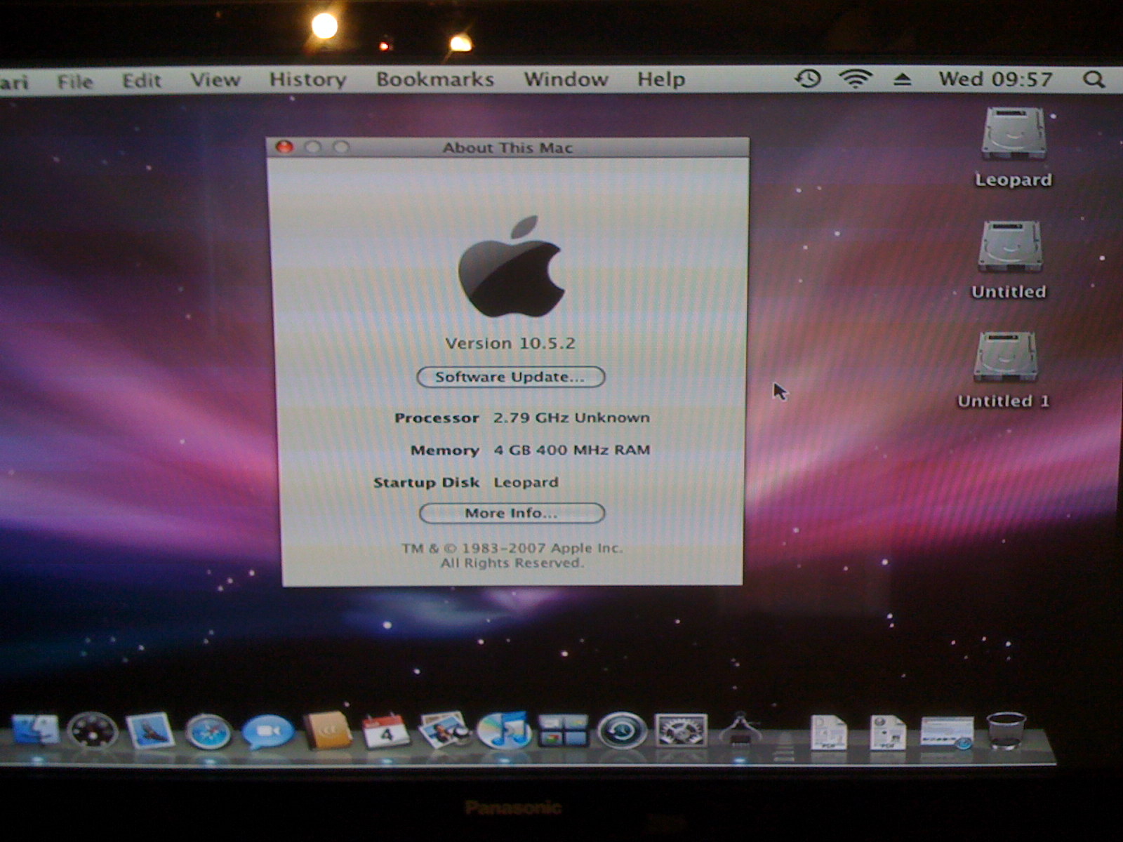

Caprica01 Posted March 4, 2009 Author Share Posted March 4, 2009 OK guys, good news. I finally got it installed and working. Had to use a different distro. Had to go with the kalyway 10.5.2 release. Had to set my onchip ATA devices to AHCI in my bios. I loaded the speedstepkernel from Darwin boot. These are the options I selected for my customize Customize ============ no graphics selected. My card was not on the list Realtek Sigmatel Audio (this doesn't work) Atheros wireless adapter no mobo chipset. My chipset was not on the list. apps: gmail notifier, kext helper, mojo, perian, simply burns, VLC Patch: time machine fix AMD Patch: AMD_1052_Patch_test_1 Installed, re-booted, changed boot order in bios to remove CD drive as 1st boot device. Now up and running. I now need to install the kext's for my chipset, audio and graphics. So far so good. Will report back after the kext installs. Link to comment https://www.insanelymac.com/forum/topic/155779-install-help-for-amd-x64-system/#findComment-1097968 Share on other sites More sharing options...
zim2dive Posted March 4, 2009 Share Posted March 4, 2009 OK guys, good news. I finally got it installed and working. How stable is your ethernet? Mine seems very flaky (tried both ForceDethV and nForceLAN drivers from iPC 10.5.6). My ethernet is there after I install and reboot.. and works for a short time (no more than 10 minutes) and then when I try again later safari says I'm not connected to the internet and Network Prefs say cable not connected. (I will have to double check this is not an after-sleep event) I also had my screen go white/lock up and had to reset my mobo before I could boot again. All in all not feeling like I've found a stable install yet (even for the few parts of the install that do seem to work) Link to comment https://www.insanelymac.com/forum/topic/155779-install-help-for-amd-x64-system/#findComment-1098138 Share on other sites More sharing options...
Caprica01 Posted March 5, 2009 Author Share Posted March 5, 2009 How stable is your ethernet? Mine seems very flaky (tried both ForceDethV and nForceLAN drivers from iPC 10.5.6). My ethernet is there after I install and reboot.. and works for a short time (no more than 10 minutes) and then when I try again later safari says I'm not connected to the internet and Network Prefs say cable not connected. (I will have to double check this is not an after-sleep event) I also had my screen go white/lock up and had to reset my mobo before I could boot again. All in all not feeling like I've found a stable install yet (even for the few parts of the install that do seem to work) I didn't install any ethernet drivers. I just installed the Atheros wireless adapter as my PC is set up with a wireless PCI card for internet connection. UPDATE ====== As mentioned above I was going to install some new/updated kexts now the install is working. I logged onto PCWiz website through the Leopard OS and loaded the following driver packages:- Drivers for VIA, SiS, Marvell, and ATI SBXXX chipsets Audio driver package for ALC888 audio codec (OS X Leopard) Patched Mac OS X 10.5.4 drivers for ATI Radeon HD 3650 Quick note about the graphics package: This is what I have experienced the most trouble with. If I try installing any package apart from the one I mentioned above, I get no picture on re-boot, just a screen full of purple blocks. But so far so good. I have also updated the quicktime and iTunes directly through the update software, but not updated to 10.5.6. Yet! That's my next project for today. Link to comment https://www.insanelymac.com/forum/topic/155779-install-help-for-amd-x64-system/#findComment-1098890 Share on other sites More sharing options...
