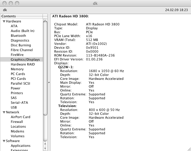

mcsmart Posted February 24, 2009 Share Posted February 24, 2009 Hello everybody! I wanted to let you know that the S-Video output of my Radeon HD3870 is working. I now have an external television connected and I can use FrontRow on it (with a free application called "TV Row"). In fact the HD3870 is probably one of the best cards you can get for your Hackintosh. The device id (0x9501) is already in the vanilla kext so all you need is Natit. Notice: S-Video out does only work with newer framebuffers (tested with Megalodon). It does not work with Lamna or older ones. My card: MSI RX3870-T2D512E-OC (the stock fan is pretty loud - you might want to replace it with a new cooler and a 120mm fan). More H/W specs in my signature. - mcsmart PS: Special thanks go to netkas! Link to comment https://www.insanelymac.com/forum/topic/154776-s-video-working-on-radeon-hd3870/ Share on other sites More sharing options...

mcsmart Posted February 26, 2009 Author Share Posted February 26, 2009 How did you manage to use new framebufer Megalodon with Natit? Also, did you try with efi strings without Natit. I just downloaded the current pkg installer (see the forum of IRC), extracted Natit from it and replaced the old version of Natit with the newer one. I am not using EFI Strings, because Natit is much easier to keep updated. - mcsmart Link to comment https://www.insanelymac.com/forum/topic/154776-s-video-working-on-radeon-hd3870/#findComment-1092615 Share on other sites More sharing options...

lumovan Posted May 1, 2009 Share Posted May 1, 2009 Hi, i have a MSI 3870 pcie card. It was cheap and very quite. I have use EFI-STUDIO Extended and the newestet driver, but video out won`t be work. Can you write a howto please, what step do you have to. I have try to remove natit and extentions.mkext manualy and cp natit from install package, boot with -x into safe mode for repair extentsion.mkext but still the same problem. i hope you can help Thx Best regards David Hello everybody! I wanted to let you know that the S-Video output of my Radeon HD3870 is working. I now have an external television connected and I can use FrontRow on it (with a free application called "TV Row"). In fact the HD3870 is probably one of the best cards you can get for your Hackintosh. The device id (0x9501) is already in the vanilla kext so all you need is Natit. Notice: S-Video out does only work with newer framebuffers (tested with Megalodon). It does not work with Lamna or older ones. My card: MSI RX3870-T2D512E-OC (the stock fan is pretty loud - you might want to replace it with a new cooler and a 120mm fan). More H/W specs in my signature. - mcsmart PS: Special thanks go to netkas! Link to comment https://www.insanelymac.com/forum/topic/154776-s-video-working-on-radeon-hd3870/#findComment-1146188 Share on other sites More sharing options...
mcsmart Posted May 18, 2009 Author Share Posted May 18, 2009 Can you write a howto please, what step do you have to. See this. - mcsmart Link to comment https://www.insanelymac.com/forum/topic/154776-s-video-working-on-radeon-hd3870/#findComment-1159242 Share on other sites More sharing options...
