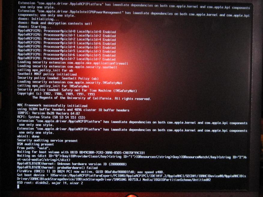

neils Posted May 5, 2009 Share Posted May 5, 2009 You had your settings correct. It clear your system is not loading anything from your Mac OS install, just the kexts installed by the script. That's it. Try these things and report back with your findings: 1) If you did install with my new script, remove all kexts from the Stored_Kext folder with the exception of dsmos.kext, Disabler.kext, and System.kext. Run script and "Update boot cache" and reboot with -v -f flags. These kexts are the minimum required to boot. report back. If that doesn't work: 2) Did you say you installed using a 10.5.6 DVD? It might sound silly, but how about downloading the 10.5.6 combo updater (big file) and installing that over your OS install? Like you, I'm running out of options. But, given that this install process works for so many people and that the log only shows the patched kexts being loaded and stalling there, I'm inclined to think something being amiss regarding the OS install. 3) If you're in a position to do a erase and reinstall, do so with the Chameleon 1012 bootloader instead of Chameleon 2. regards, MAJ Hello, Just to be sure, I reformattd the EFI partition. After that, I erased the harddisk I'm installing on, and downloaded the newest script. I already used the official 10.5.6 combo update, so I already had that. I installed the older chameleon, and for the rest the only thing I changed was the kernel. I installed the 9.6.3 kernel and system kext. Again I didn't run the DSDT patcher at all, because I know it doesn't help me, since I'm installing from my older Pentium D hackintosh. I updated the boot caches etc, and took out the disk. On my new i7 system I reset the bios, and set up everything exactly as suggested in the first post of this thread. Chameleon boots up nicely, booted with -v -f. I can see a lot of kexts are being loaded from s/l/e, but when that's done the system reboots. So I took the disk out again, removed all kexts with the exception of dsmos.kext, Disabler.kext, and System.kext, updated cached and crossed my fingers. Unfortunately, same story. Boot loop. Booting in F- -V mode didn't help either. It's weird. Really weird. Link to comment https://www.insanelymac.com/forum/topic/149505-guide-retail-os-x-install-1058-on-gigabyte-ga-ex58-ud5-core-i7-mobo/page/45/#findComment-1148724 Share on other sites More sharing options...

neils Posted May 5, 2009 Share Posted May 5, 2009 Well, I bought my retail copy of OSX second hand. Tomorrow I'm gonna buy a new retail version, just to be sure I don't have a machine specific version. The reason the realtek isn't loading is because I took that screenshot after I removed all kexts except the dsmos.kext, Disabler.kext, and System.kext. I'm also gonna contact Corsair, to verify if my memory settings are indeed correct. I've heard about people who couldn't boot because of memory problems. But first I'm gonna buy a new retail version to be really sure I have indeed the one I need. Thanks again DD. I know it's gonna work in the end, I have faith. And I don't have a log. I don't even have a private directory at all on my install disk. Is that normal ? Link to comment https://www.insanelymac.com/forum/topic/149505-guide-retail-os-x-install-1058-on-gigabyte-ga-ex58-ud5-core-i7-mobo/page/45/#findComment-1148743 Share on other sites More sharing options...

digital_dreamer Posted May 5, 2009 Author Share Posted May 5, 2009 Well, I bought my retail copy of OSX second hand. Tomorrow I'm gonna buy a new retail version, just to be sure I don't have a machine specific version. The reason the realtek isn't loading is because I took that screenshot after I removed all kexts except the dsmos.kext, Disabler.kext, and System.kext. I'm also gonna contact Corsair, to verify if my memory settings are indeed correct. I've heard about people who couldn't boot because of memory problems. But first I'm gonna buy a new retail version to be really sure I have indeed the one I need. Thanks again DD. I know it's gonna work in the end, I have faith. And I don't have a log. I don't even have a private directory at all on my install disk. Is that normal ? Ah, regarding the LAN driver. Okay. I didn't know which boot that screenshot was for. The private directory is typically invisible. But, can you see it in the Terminal? The symptoms you have are very much like what would happen from a machine specific version. regards, MAJ Link to comment https://www.insanelymac.com/forum/topic/149505-guide-retail-os-x-install-1058-on-gigabyte-ga-ex58-ud5-core-i7-mobo/page/45/#findComment-1148749 Share on other sites More sharing options...
