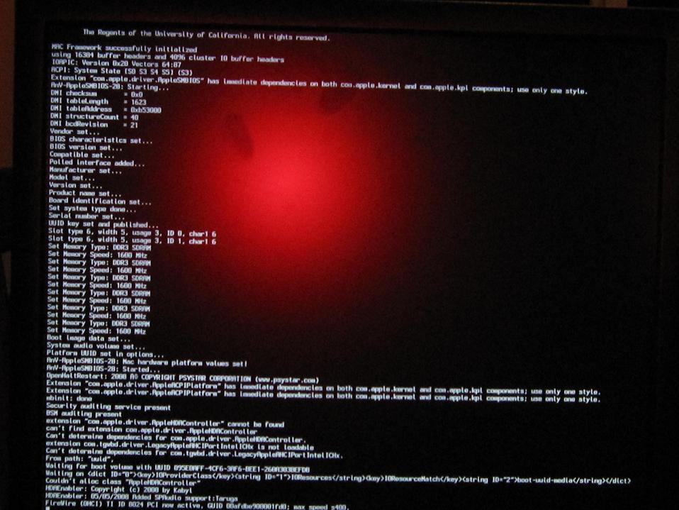

neils Posted May 4, 2009 Share Posted May 4, 2009 You method (using DD latest script) didn't work for me Joe. Again I'm in a boot loop. Chameleon boots, but OSX wont. Beeps all around, and a quick reboot. I've put like 80 hours in it already. I'm about to give up for the moment. I'have other things to do. It's frustrating though, because now my new pc is standing in a corner (case still open) doing nothing. Link to comment https://www.insanelymac.com/forum/topic/149505-guide-retail-os-x-install-1058-on-gigabyte-ga-ex58-ud5-core-i7-mobo/page/44/#findComment-1147854 Share on other sites More sharing options...
mattrb Posted May 4, 2009 Share Posted May 4, 2009 You method (using DD latest script) didn't work for me Joe. Again I'm in a boot loop. Chameleon boots, but OSX wont. Beeps all around, and a quick reboot. I've put like 80 hours in it already. I'm about to give up for the moment. I'have other things to do. It's frustrating though, because now my new pc is standing in a corner (case still open) doing nothing. Keep trying, don't give up. Try to do things manually, that always works. Link to comment https://www.insanelymac.com/forum/topic/149505-guide-retail-os-x-install-1058-on-gigabyte-ga-ex58-ud5-core-i7-mobo/page/44/#findComment-1147872 Share on other sites More sharing options...
neils Posted May 4, 2009 Share Posted May 4, 2009 Thank you joeblough. You solved my problem. My machine booted for the very first time thanks to your tip. If anyone else is having problems similar to mine (see my previous post), you can try the following procedure assuming you have run the 4/26 DD script (steps 1-5) on a freshly formatted drive. My drive is called "OSx86" so you will need to substitute the name of YOURHARDDRIVE wherever it occurs below. 1. (in Finder) trash "Extensions.mkext" located in your /Extra folder 2. (in terminal window type) sudo su - 3. (in terminal window type) cd /Volumes/OSx86/Extra 4. (in terminal window type) mv Extensions Stuff 5. (in Finder) trash all your caches in both /System/Library/Caches/ and /Library/Caches/ 6. (in terminal window type) kextcache -a i386 -m "/Volumes/OSx86/Extra/Extensions.mkext" "/Volumes/OSx86/Extra/Stuff" 7. There will be some warnings. I ignored them. 8. (in terminal window type) cd .. 9. (in terminal window type) chmod -R 755 Extra 10. (in terminal window type) chown -R root:wheel Extra 11. (in terminal window type) diskutil repairPermissions /Volumes/OSx86 In conclusion: For whatever reason, it seems that we may need to keep our kexts away from Chameleon 2. I'm too much of a noob to have any real insight into the matter. I built my machine 3 days ago. I'll leave the real fix to the professionals. Thanks again everyone. Link to comment https://www.insanelymac.com/forum/topic/149505-guide-retail-os-x-install-1058-on-gigabyte-ga-ex58-ud5-core-i7-mobo/page/44/#findComment-1147887 Share on other sites More sharing options...
joeblough Posted May 4, 2009 Share Posted May 4, 2009 if you are hanging at this point, its because either the kexts for the sata ports did not load, or the sata ports are not set to AHCI mode, or com.apple.boot.plist is calling out the wrong uuid for the boot disk, or you have called out the wrong device/partition in the rd=diskXsY argument, if you have one. one of the lines in the output says what UUID the kernel is waiting on. if you can run disk utility on your boot disk, you can do a get info on the partition and see what the UUID is for that volume. does it match? edit: well it's probably not rd=whatever because you don't see the messages about waiting for the UUID if you've given the rd= arguement. also have you tried booting with -f ? Link to comment https://www.insanelymac.com/forum/topic/149505-guide-retail-os-x-install-1058-on-gigabyte-ga-ex58-ud5-core-i7-mobo/page/44/#findComment-1147905 Share on other sites More sharing options...
digital_dreamer Posted May 4, 2009 Author Share Posted May 4, 2009 everything that you've ever posted has worked for me. so don't be discouraged! anyway i'm on board with the Stored_Kext idea, of course Thanks, Joe! I'm finished with the script and will upload it when the wireless broadband is back up. It's pokey right now. I'm on the skirts of town and wireless is all they have available. So, on some parts of the day, I get little reception. Let's work with neils, shall we? Looking at his screenshot, can anyone tell if the system is loading anything other than the patched kexts? Doesn't appear to be to me. neils, when you installed OS X from the other system, was "Ignore ownership on this volume" disabled? With the drive installed on your other system, select the drive icon and do Get Info. On the bottom of the Info window is that option. I'm curious about the permissions in those critical system files. In Terminal, do this: cd /Volumes/YOUR-BOOT_DRIVE/System/Library/Extensions ls -l (That's a lowercase L after ls) This should provide a list of all your extensions in S/L/E and their permissions. Do this and we'll fix this thing once and for all. MAJ EDIT: I don't think it would be the UUID, because he's already booted into that drive. It's just not loading the rest of the kexts from S/L/E. Now, if he was on the EFI partition, then yeah, this would be a issue. Link to comment https://www.insanelymac.com/forum/topic/149505-guide-retail-os-x-install-1058-on-gigabyte-ga-ex58-ud5-core-i7-mobo/page/44/#findComment-1147912 Share on other sites More sharing options...
neils Posted May 4, 2009 Share Posted May 4, 2009 Thanks for the quick reply again guys. I already verified if the UUID is matching. It is, so that's good. Ignore ownership was NOT disabled. Could this be the problem ? This is what I get to see when I use the terminal command DD. Sorry for the long list, but I thought I would be handy to copy past it all. drwxr-xr-x 3 root wheel 102 Aug 22 2007 ACard6280ATA.kext drwxr-xr-x 3 root wheel 102 Aug 22 2007 ACard62xxM.kext drwxr-xr-x 3 root wheel 102 Aug 22 2007 ACard67162.kext drwxr-xr-x 3 root wheel 102 Aug 22 2007 ACard671xSCSI.kext drwxr-xr-x 3 root wheel 102 Aug 22 2007 ACard6885M.kext drwxr-xr-x 3 root wheel 102 Aug 22 2007 ACard68xxM.kext drwxr-xr-x 3 root wheel 102 Nov 25 02:44 ALF.kext drwxr-xr-x 3 root wheel 102 Dec 5 03:49 ATINDRV.kext drwxr-xr-x 3 root wheel 102 Dec 5 03:50 ATIRNDRV.kext drwxr-xr-x 3 root wheel 102 Dec 5 03:49 ATIRadeon.kext drwxr-xr-x 3 root wheel 102 Dec 5 03:49 ATIRadeon8500.kext drwxr-xr-x 3 root wheel 102 Dec 5 03:49 ATIRadeon8500DVDDriver.bundle drwxr-xr-x 3 root wheel 102 Dec 5 03:49 ATIRadeon8500GA.plugin drwxr-xr-x 3 root wheel 102 Dec 5 03:49 ATIRadeon8500GLDriver.bundle drwxr-xr-x 3 root wheel 102 Dec 5 03:49 ATIRadeon8500VADriver.bundle drwxr-xr-x 3 root wheel 102 Dec 5 03:49 ATIRadeon9700.kext drwxr-xr-x 3 root wheel 102 Dec 5 03:49 ATIRadeon9700DVDDriver.bundle drwxr-xr-x 3 root wheel 102 Dec 5 03:49 ATIRadeon9700GA.plugin drwxr-xr-x 3 root wheel 102 Dec 5 03:49 ATIRadeon9700GLDriver.bundle drwxr-xr-x 3 root wheel 102 Dec 5 03:49 ATIRadeon9700VADriver.bundle drwxr-xr-x 3 root wheel 102 Dec 5 03:49 ATIRadeonDVDDriver.bundle drwxr-xr-x 3 root wheel 102 Dec 5 03:49 ATIRadeonGA.plugin drwxr-xr-x 3 root wheel 102 Dec 5 03:49 ATIRadeonGLDriver.bundle drwxr-xr-x 3 root wheel 102 Dec 5 03:49 ATIRadeonX1000.kext drwxr-xr-x 3 root wheel 102 Dec 5 03:49 ATIRadeonX1000GA.plugin drwxr-xr-x 3 root wheel 102 Dec 5 03:49 ATIRadeonX1000GLDriver.bundle drwxr-xr-x 3 root wheel 102 Dec 5 03:49 ATIRadeonX1000VADriver.bundle drwxr-xr-x 3 root wheel 102 Dec 5 03:49 ATIRadeonX2000.kext drwxr-xr-x 3 root wheel 102 Dec 5 03:49 ATIRadeonX2000GA.plugin drwxr-xr-x 3 root wheel 102 Dec 5 03:49 ATIRadeonX2000GLDriver.bundle drwxr-xr-x 3 root wheel 102 Dec 5 03:49 ATIRadeonX2000VADriver.bundle drwxr-xr-x 3 root wheel 102 Sep 19 2003 ATTOExpressPCIPlus.kext drwxr-xr-x 3 root wheel 102 Nov 25 02:48 Apple02Audio.kext drwxr-xr-x 3 root wheel 102 Nov 25 02:54 Apple16X50Serial.kext drwxr-xr-x 3 root wheel 102 Nov 25 03:01 AppleACPIPlatform.kext drwxr-xr-x 3 root wheel 102 Nov 25 02:47 AppleAD741x.kext drwxr-xr-x 3 root wheel 102 Nov 25 03:09 AppleADBButtons.kext drwxr-xr-x 3 root wheel 102 Nov 25 03:00 AppleADBKeyboard.kext drwxr-xr-x 3 root wheel 102 Nov 25 03:08 AppleADBMouse.kext drwxr-xr-x 3 root wheel 102 Nov 25 03:10 AppleADM103x.kext drwxr-xr-x 3 root wheel 102 Nov 25 03:10 AppleADT746x.kext drwxr-xr-x 3 root wheel 102 Nov 25 03:08 AppleAHCIPort.kext drwxr-xr-x 3 root wheel 102 Nov 25 02:47 AppleAPIC.kext drwxr-xr-x 3 root wheel 102 Nov 25 03:10 AppleAirPort.kext drwxr-xr-x 3 root wheel 102 Dec 5 03:49 AppleAltiVecDVDDriver.bundle drwxr-xr-x 3 root wheel 102 Nov 25 02:49 AppleBMC.kext drwxr-xr-x 3 root wheel 102 Nov 25 03:07 AppleBacklight.kext drwxr-xr-x 3 root wheel 102 Nov 25 03:02 AppleBlower.kext drwxr-xr-x 3 root wheel 102 Nov 25 02:54 AppleCPUThermo.kext drwxr-xr-x 3 root wheel 102 Nov 25 03:00 AppleCore99NVRAM.kext drwxr-xr-x 3 root wheel 102 Nov 25 02:48 AppleDallasDriver.kext drwxr-xr-x 3 root wheel 102 Nov 25 03:09 AppleEFIRuntime.kext drwxr-xr-x 3 root wheel 102 Nov 25 03:08 AppleFCU.kext drwxr-xr-x 3 root wheel 102 Nov 25 03:08 AppleFPButton.kext drwxr-xr-x 3 root wheel 102 Nov 25 02:55 AppleFWAudio.kext drwxr-xr-x 3 root wheel 102 Nov 25 03:10 AppleFan.kext drwxr-xr-x 3 root wheel 102 Nov 25 03:07 AppleFileSystemDriver.kext drwxr-xr-x 3 root wheel 102 Nov 25 03:07 AppleFlashNVRAM.kext drwxr-xr-x 3 root wheel 102 Nov 25 03:10 AppleGPIO.kext drwxr-xr-x 3 root wheel 102 Sep 24 2007 AppleGW.kext drwxr-xr-x 3 root wheel 102 Nov 25 03:12 AppleGraphicsControl.kext drwxr-xr-x 3 root wheel 102 Nov 25 03:09 AppleGraphicsPowerManagement.kext drwxr-xr-x 3 root wheel 102 Nov 25 02:51 AppleHDA.kext drwxr-xr-x 3 root wheel 102 Nov 25 02:59 AppleHIDKeyboard.kext drwxr-xr-x 3 root wheel 102 Nov 25 03:12 AppleHIDMouse.kext drwxr-xr-x 3 root wheel 102 Nov 26 07:07 AppleHPET.kext drwxr-xr-x 3 root wheel 102 Nov 25 02:47 AppleHWClock.kext drwxr-xr-x 3 root wheel 102 Nov 25 02:47 AppleHWSensor.kext drwxr-xr-x 3 root wheel 102 Nov 25 03:08 AppleI2C.kext drwxr-xr-x 3 root wheel 102 Nov 25 02:52 AppleI2S.kext drwxr-xr-x 3 root wheel 102 Nov 25 03:07 AppleI2SModemFamily.kext drwxr-xr-x 3 root wheel 102 Nov 25 03:12 AppleIRController.kext drwxr-xr-x 3 root wheel 102 Nov 25 08:50 AppleIntelCPUPowerManagement.kext drwxr-xr-x 3 root wheel 102 Dec 5 03:49 AppleIntelGMA950.kext drwxr-xr-x 3 root wheel 102 Dec 5 03:49 AppleIntelGMA950GA.plugin drwxr-xr-x 3 root wheel 102 Dec 5 03:49 AppleIntelGMA950GLDriver.bundle drwxr-xr-x 3 root wheel 102 Dec 5 03:49 AppleIntelGMA950VADriver.bundle drwxr-xr-x 3 root wheel 102 Dec 5 03:49 AppleIntelGMAX3100.kext drwxr-xr-x 5 root wheel 170 May 3 23:42 AppleIntelGMAX3100FB.kext drwxr-xr-x 3 root wheel 102 Dec 5 03:49 AppleIntelGMAX3100GA.plugin drwxr-xr-x 3 root wheel 102 Dec 5 03:49 AppleIntelGMAX3100GLDriver.bundle drwxr-xr-x 3 root wheel 102 Dec 5 03:49 AppleIntelGMAX3100VADriver.bundle drwxr-xr-x 5 root wheel 170 May 3 23:42 AppleIntelIntegratedFramebuffer.kext drwxr-xr-x 3 root wheel 102 Nov 25 03:09 AppleK2.kext drwxr-xr-x 3 root wheel 102 Nov 25 03:09 AppleK2Driver.kext drwxr-xr-x 3 root wheel 102 Nov 25 03:10 AppleK2Fan.kext drwxr-xr-x 3 root wheel 102 Nov 25 03:06 AppleK2SATA.kext drwxr-xr-x 3 root wheel 102 Nov 25 02:42 AppleK2SATARoot.kext drwxr-xr-x 3 root wheel 102 Nov 25 03:09 AppleKauaiATA.kext drwxr-xr-x 3 root wheel 102 Nov 25 03:09 AppleKeyLargo.kext drwxr-xr-x 3 root wheel 102 Sep 24 2007 AppleKeyswitch.kext drwxr-xr-x 3 root wheel 102 Nov 25 03:07 AppleKiwiATA.kext drwxr-xr-x 3 root wheel 102 Nov 25 03:07 AppleKiwiRoot.kext drwxr-xr-x 3 root wheel 102 Nov 25 03:06 AppleLED.kext drwxr-xr-x 3 root wheel 102 Nov 25 02:47 AppleLM7x.kext drwxr-xr-x 3 root wheel 102 Nov 25 02:52 AppleLM87.kext drwxr-xr-x 3 root wheel 102 Nov 25 02:47 AppleLM8x.kext drwxr-xr-x 3 root wheel 102 Nov 25 02:54 AppleLMUController.kext drwxr-xr-x 3 root wheel 102 Nov 25 03:10 AppleLPC.kext drwxr-xr-x 3 root wheel 102 Nov 25 03:08 AppleLSIFusionMPT.kext drwxr-xr-x 3 root wheel 102 Nov 25 03:08 AppleMCEDriver.kext drwxr-xr-x 3 root wheel 102 Nov 25 02:54 AppleMIDIFWDriver.plugin drwxr-xr-x 3 root wheel 102 Oct 9 2008 AppleMIDIIACDriver.plugin drwxr-xr-x 3 root wheel 102 Oct 9 2008 AppleMIDIRTPDriver.plugin drwxr-xr-x 3 root wheel 102 Oct 9 2008 AppleMIDIUSBDriver.plugin drwxr-xr-x 3 root wheel 102 Nov 25 02:42 AppleMPIC.kext drwxr-xr-x 3 root wheel 102 Nov 25 02:46 AppleMacRISC2PE.kext drwxr-xr-x 3 root wheel 102 Nov 25 02:54 AppleMacRISC4PE.kext drwxr-xr-x 3 root wheel 102 Nov 25 02:53 AppleMacRiscPCI.kext drwxr-xr-x 3 root wheel 102 Nov 25 02:47 AppleMaxim1989.kext drwxr-xr-x 3 root wheel 102 Nov 25 02:47 AppleMaxim6690.kext drwxr-xr-x 3 root wheel 102 Nov 25 02:56 AppleMediaBay.kext drwxr-xr-x 3 root wheel 102 Nov 25 02:46 AppleMikeyHIDDriver.kext drwxr-xr-x 3 root wheel 102 Nov 20 23:17 AppleMobileDevice.kext drwxr-xr-x 4 root wheel 136 Dec 5 03:49 AppleNDRV drwxr-xr-x 3 root wheel 102 Nov 25 02:48 AppleOnboardAudio.kext drwxr-xr-x 3 root wheel 102 Nov 25 02:42 AppleOnboardDisplay.kext drwxr-xr-x 3 root wheel 102 Nov 25 03:01 ApplePCCard16ATA.kext drwxr-xr-x 3 root wheel 102 Nov 25 03:05 ApplePCCardATA.kext drwxr-xr-x 3 root wheel 102 Nov 25 03:10 ApplePMU.kext drwxr-xr-x 3 root wheel 102 Nov 25 03:13 ApplePlatformEnabler.kext drwxr-xr-x 3 root wheel 102 Nov 25 02:42 AppleRAID.kext drwxr-xr-x 3 root wheel 102 Nov 25 02:44 AppleRAIDCard.kext drwxr-xr-x 3 root wheel 102 Nov 25 03:10 AppleRTC.kext drwxr-xr-x 3 root wheel 102 Nov 25 03:11 AppleSEP.kext drwxr-xr-x 3 root wheel 102 Nov 25 02:47 AppleSMBIOS.kext drwxr-xr-x 3 root wheel 102 Nov 25 03:10 AppleSMBusController.kext drwxr-xr-x 3 root wheel 102 Nov 25 03:10 AppleSMBusPCI.kext drwxr-xr-x 3 root wheel 102 Nov 25 03:10 AppleSMC.kext drwxr-xr-x 3 root wheel 102 Nov 25 02:54 AppleSMCLMU.kext drwxr-xr-x 3 root wheel 102 Nov 25 03:09 AppleSMU.kext drwxr-xr-x 3 root wheel 102 Nov 25 02:47 AppleSMUMonitor.kext drwxr-xr-x 3 root wheel 102 Nov 25 03:09 AppleSPU.kext drwxr-xr-x 3 root wheel 102 Nov 25 02:44 AppleSmartBatteryManager.kext drwxr-xr-x 3 root wheel 102 Dec 4 02:20 AppleStorageDrivers.kext drwxr-xr-x 3 root wheel 102 Nov 25 02:59 AppleSym8xx.kext drwxr-xr-x 3 root wheel 102 Nov 25 02:59 AppleThermal.kext drwxr-xr-x 3 root wheel 102 Nov 25 03:09 AppleUSBAudio.kext drwxr-xr-x 3 root wheel 102 Nov 25 02:55 AppleUSBDisplays.kext drwxr-xr-x 3 root wheel 102 Nov 25 02:45 AppleUSBMultitouch.kext drwxr-xr-x 3 root wheel 102 Nov 25 03:01 AppleUSBTopCase.kext drwxr-xr-x 3 root wheel 102 Nov 25 03:00 AppleUpstreamUserClient.kext drwxr-xr-x 3 root wheel 102 Sep 25 2008 AppleVADriver.bundle drwxr-xr-x 3 root wheel 102 Nov 25 03:08 AppleVIA.kext drwxr-xr-x 3 root wheel 102 Nov 25 03:00 AppleVSP.kext drwxr-xr-x 3 root wheel 102 Nov 25 02:49 AppleXsanFilter.kext drwxr-xr-x 3 root wheel 102 Nov 25 03:08 Apple_iSight.kext drwxr-xr-x 3 root wheel 102 Aug 22 2007 ArcMSR.kext drwxr-xr-x 3 root wheel 102 Nov 25 02:48 AudioDeviceTreeUpdater.kext drwxr-xr-x 3 root wheel 102 Nov 25 02:46 AudioIPCDriver.kext drwxr-xr-x 3 root wheel 102 Nov 25 03:06 BootCache.kext drwxr-xr-x 3 root wheel 102 Nov 1 2008 CM4040.kext drwxr-xr-x 3 root wheel 102 Nov 1 2008 CRYPTOCardPCCard.kext drwxr-xr-x 3 root wheel 102 May 3 23:25 Caches drwxr-xr-x 3 root wheel 102 Nov 25 02:50 DSACL.ppp drwxr-xr-x 3 root wheel 102 Nov 25 02:50 DSAuth.ppp drwxr-xr-x 3 root wheel 102 Sep 24 2007 DVFamily.bundle drwxr-xr-x 4 root wheel 136 Nov 25 02:52 Dont Steal Mac OS X.kext drwxr-xr-x 3 root wheel 102 Nov 25 02:50 EAP-KRB.ppp drwxr-xr-x 3 root wheel 102 Nov 1 2008 EAP-RSA.ppp drwxr-xr-x 3 root wheel 102 Nov 25 02:50 EAP-TLS.ppp drwxr-xr-x 3 root wheel 102 Dec 5 03:49 GeForce.kext drwxr-xr-x 3 root wheel 102 Dec 5 03:49 GeForce2MXGLDriver.bundle drwxr-xr-x 3 root wheel 102 Dec 5 03:49 GeForce3GLDriver.bundle drwxr-xr-x 3 root wheel 102 Dec 5 03:49 GeForce7xxxGLDriver.bundle drwxr-xr-x 3 root wheel 102 Dec 5 03:49 GeForce7xxxGLDriverPPC.bundle drwxr-xr-x 3 root wheel 102 Dec 5 03:49 GeForce8xxxGLDriver.bundle drwxr-xr-x 3 root wheel 102 Dec 5 03:49 GeForceFXGLDriver.bundle drwxr-xr-x 3 root wheel 102 Dec 5 03:49 GeForceFXGLDriverPPC.bundle drwxr-xr-x 3 root wheel 102 Dec 5 03:49 GeForceGA.plugin drwxr-xr-x 3 root wheel 102 Dec 5 03:49 GeForceGAPPC.plugin drwxr-xr-x 3 root wheel 102 Dec 5 03:49 GeForcePPC.kext drwxr-xr-x 3 root wheel 102 Dec 5 03:49 GeForceVADriver.bundle drwxr-xr-x 3 root wheel 102 Dec 5 03:49 GeForceVADriverPPC.bundle drwxr-xr-x 3 root wheel 102 Nov 25 03:10 I2CGPIO.kext drwxr-xr-x 3 root wheel 102 Oct 1 2008 ICAClassicNotSeizeDriver.kext drwxr-xr-x 3 root wheel 102 Oct 1 2008 ICAFWKodakProDriver.kext drwxr-xr-x 3 root wheel 102 Nov 25 15:39 IO80211Family.kext drwxr-xr-x 3 root wheel 102 Nov 25 03:10 IOACPIFamily.kext drwxr-xr-x 3 root wheel 102 Nov 25 03:04 IOADBFamily.kext drwxr-xr-x 3 root wheel 102 Nov 25 03:08 IOAHCIFamily.kext drwxr-xr-x 3 root wheel 102 Nov 25 02:46 IOATAFamily.kext drwxr-xr-x 3 root wheel 102 Nov 25 02:48 IOAudioFamily.kext drwxr-xr-x 3 root wheel 102 Nov 25 02:47 IOBDStorageFamily.kext drwxr-xr-x 3 root wheel 102 Nov 25 02:57 IOBluetoothFamily.kext drwxr-xr-x 3 root wheel 102 Nov 25 02:57 IOBluetoothHIDDriver.kext drwxr-xr-x 3 root wheel 102 Nov 25 02:59 IOCDStorageFamily.kext drwxr-xr-x 3 root wheel 102 Nov 25 03:00 IODVDStorageFamily.kext drwxr-xr-x 3 root wheel 102 Nov 25 03:07 IOFireWireAVC.kext drwxr-xr-x 3 root wheel 102 Nov 25 02:42 IOFireWireFamily.kext drwxr-xr-x 3 root wheel 102 Nov 25 03:01 IOFireWireIP.kext drwxr-xr-x 3 root wheel 102 Nov 25 02:43 IOFireWireSBP2.kext drwxr-xr-x 3 root wheel 102 Nov 25 02:47 IOFireWireSerialBusProtocolTransport.kext drwxr-xr-x 5 root wheel 170 May 3 23:42 IOGraphicsFamily.kext drwxr-xr-x 3 root wheel 102 Nov 25 03:11 IOHDIXController.kext drwxr-xr-x 3 root wheel 102 Nov 25 02:47 IOHIDFamily.kext drwxr-xr-x 3 root wheel 102 Nov 25 02:47 IOI2CAD741x.kext drwxr-xr-x 3 root wheel 102 Nov 25 03:10 IOI2CADT746x.kext drwxr-xr-x 3 root wheel 102 Nov 25 02:47 IOI2CCPUVoltage.kext drwxr-xr-x 3 root wheel 102 Nov 25 02:42 IOI2CControllerPMU.kext drwxr-xr-x 3 root wheel 102 Nov 25 02:42 IOI2CControllerPPC.kext drwxr-xr-x 3 root wheel 102 Nov 25 02:42 IOI2CControllerSMU.kext drwxr-xr-x 3 root wheel 102 Nov 25 03:08 IOI2CDeviceFCU.kext drwxr-xr-x 3 root wheel 102 Nov 25 02:54 IOI2CDeviceLMU.kext drwxr-xr-x 3 root wheel 102 Nov 25 03:10 IOI2CDriveBayGPIO.kext drwxr-xr-x 3 root wheel 102 Nov 25 02:42 IOI2CFamily.kext drwxr-xr-x 3 root wheel 102 Nov 25 02:47 IOI2CHWClock.kext drwxr-xr-x 3 root wheel 102 Nov 25 02:47 IOI2CLM6x.kext drwxr-xr-x 3 root wheel 102 Nov 25 02:47 IOI2CLM7x.kext drwxr-xr-x 3 root wheel 102 Nov 25 02:47 IOI2CLM8x.kext drwxr-xr-x 3 root wheel 102 Nov 25 02:47 IOI2CMaxim1631.kext drwxr-xr-x 3 root wheel 102 Nov 25 02:47 IOI2CMaxim1989.kext drwxr-xr-x 3 root wheel 102 Nov 25 02:47 IOI2CMaxim6690.kext drwxr-xr-x 3 root wheel 102 Nov 25 03:08 IOI2CMotionSensor.kext drwxr-xr-x 3 root wheel 102 Nov 25 02:47 IOI2CPulsar.kext drwxr-xr-x 3 root wheel 102 Nov 25 02:47 IOI2CSMUSat.kext drwxr-xr-x 3 root wheel 102 Nov 25 02:47 IOI2CSlewClock.kext drwxr-xr-x 3 root wheel 102 Nov 25 03:09 IOKeyLargo.kext drwxr-xr-x 5 root wheel 170 May 3 23:42 IONDRVSupport.kext drwxr-xr-x 3 root wheel 102 Nov 25 03:09 IONetworkingFamily.kext drwxr-xr-x 3 root wheel 102 Nov 25 02:42 IOPCCardFamily.kext drwxr-xr-x 5 root wheel 170 May 3 23:42 IOPCIFamily.kext drwxr-xr-x 3 root wheel 102 Nov 25 02:46 IOPlatformFunction.kext drwxr-xr-x 3 root wheel 102 Nov 26 01:27 IOPlatformPluginFamily.kext drwxr-xr-x 3 root wheel 102 Nov 25 02:46 IOSCSIArchitectureModelFamily.kext drwxr-xr-x 3 root wheel 102 Nov 25 03:12 IOSCSIParallelFamily.kext drwxr-xr-x 3 root wheel 102 Nov 25 03:08 IOSMBusFamily.kext drwxr-xr-x 3 root wheel 102 Nov 25 02:56 IOSerialFamily.kext drwxr-xr-x 3 root wheel 102 Nov 25 02:45 IOStorageFamily.kext drwxr-xr-x 3 root wheel 102 Nov 25 03:09 IOStreamFamily.kext drwxr-xr-x 3 root wheel 102 Nov 25 02:44 IOUSBFamily.kext drwxr-xr-x 3 root wheel 102 Dec 4 02:18 IOUSBMassStorageClass.kext drwxr-xr-x 4 root wheel 136 May 3 23:43 IPFirewall.kext drwxr-xr-x 3 root wheel 102 Sep 24 2007 ImmersionForceFeedback.kext drwxr-xr-x 3 root wheel 102 Aug 22 2007 JMicronATA.kext drwxr-xr-x 3 root wheel 102 Nov 25 03:01 KeyLargoATA.kext drwxr-xr-x 3 root wheel 102 Nov 25 02:50 L2TP.ppp drwxr-xr-x 3 root wheel 102 Mar 23 2004 LSIUltra320.kext drwxr-xr-x 3 root wheel 102 Sep 24 2007 LogitechForceFeedback.kext drwxr-xr-x 3 root wheel 102 Nov 25 03:10 MacIOGPIO.kext drwxr-xr-x 3 root wheel 102 Jun 30 2004 MegaRAID.kext drwxr-xr-x 3 root wheel 102 Dec 5 03:49 NVDANV10Hal.kext drwxr-xr-x 3 root wheel 102 Dec 5 03:49 NVDANV20Hal.kext drwxr-xr-x 3 root wheel 102 Dec 5 03:49 NVDANV30Hal.kext drwxr-xr-x 3 root wheel 102 Dec 5 03:49 NVDANV40Hal.kext drwxr-xr-x 3 root wheel 102 Dec 5 03:49 NVDANV40HalPPC.kext drwxr-xr-x 3 root wheel 102 Dec 5 03:49 NVDANV50Hal.kext drwxr-xr-x 3 root wheel 102 Dec 5 03:49 NVDAResman.kext drwxr-xr-x 3 root wheel 102 Dec 5 03:49 NVDAResmanPPC.kext drwxr-xr-x 3 root wheel 102 Nov 25 03:07 NVSMU.kext drwxr-xr-x 3 root wheel 102 Nov 25 02:52 OSvKernDSPLib.kext drwxr-xr-x 3 root wheel 102 Nov 25 03:08 PMUMotionSensor.kext drwxr-xr-x 3 root wheel 102 Nov 25 02:50 PPP.kext drwxr-xr-x 3 root wheel 102 Sep 24 2007 PPPSerial.ppp drwxr-xr-x 3 root wheel 102 Nov 25 02:50 PPPoE.ppp drwxr-xr-x 3 root wheel 102 Nov 25 02:50 PPTP.ppp drwxr-xr-x 3 root wheel 102 Nov 25 02:50 Radius.ppp drwxr-xr-x 3 root wheel 102 Nov 1 2008 SCR24X_Apple_Driver.kext drwxr-xr-x 3 root wheel 102 Nov 25 03:09 SM56KUSBAudioFamily.kext drwxr-xr-x 3 root wheel 102 Nov 25 03:11 SMARTLib.plugin drwxr-xr-x 3 root wheel 102 Nov 25 03:08 SMCMotionSensor.kext drwxr-xr-x 3 root wheel 102 Sep 21 2007 SoftRAID.kext drwxr-xr-x 5 root wheel 170 May 3 23:43 System.kext drwxr-xr-x 3 root wheel 102 Nov 25 03:01 TMSafetyNet.kext drwxr-xr-x 3 root wheel 102 Nov 25 03:13 VirtualAudioDriver.kext drwxr-xr-x 3 root wheel 102 Nov 25 03:13 autofs.kext drwxr-xr-x 3 root wheel 102 Nov 25 02:42 cddafs.kext drwxr-xr-x 3 root wheel 102 Nov 25 03:11 iPodDriver.kext drwxr-xr-x 3 root wheel 102 Sep 24 2007 iTunesPhoneDriver.kext drwxr-xr-x 3 root wheel 102 Nov 25 03:05 mcxalr.kext drwxr-xr-x 3 root wheel 102 Nov 25 02:43 msdosfs.kext drwxr-xr-x 3 root wheel 102 Nov 25 02:44 ntfs.kext drwxr-xr-x 3 root wheel 102 Oct 16 2008 nvenet.kext drwxr-xr-x 3 root wheel 102 Nov 25 02:57 seatbelt.kext drwxr-xr-x 3 root wheel 102 Nov 25 02:51 smbfs.kext drwxr-xr-x 3 root wheel 102 Nov 25 02:56 udf.kext drwxr-xr-x 3 root wheel 102 Nov 25 02:49 webdav_fs.kext drwxr-xr-x 3 root wheel 102 Nov 25 03:03 webfilter.kext drwxr-xr-x 3 root wheel 102 Nov 25 02:45 zfs.readonly.kext Link to comment https://www.insanelymac.com/forum/topic/149505-guide-retail-os-x-install-1058-on-gigabyte-ga-ex58-ud5-core-i7-mobo/page/44/#findComment-1147926 Share on other sites More sharing options...

digital_dreamer Posted May 4, 2009 Author Share Posted May 4, 2009 Thanks for the quick reply again guys. I already verified if the UUID is matching. It is, so that's good. Ignore ownership was NOT disabled. Could this be the problem ? <SNIP> Permissions look fine. Not disabled - as in enabled? Ignore ownership was enabled (the checkbox was selected)? regards, MAJ Link to comment https://www.insanelymac.com/forum/topic/149505-guide-retail-os-x-install-1058-on-gigabyte-ga-ex58-ud5-core-i7-mobo/page/44/#findComment-1147948 Share on other sites More sharing options...
neils Posted May 4, 2009 Share Posted May 4, 2009 Ignore ownership on this volume was (and still is) unchecked. Link to comment https://www.insanelymac.com/forum/topic/149505-guide-retail-os-x-install-1058-on-gigabyte-ga-ex58-ud5-core-i7-mobo/page/44/#findComment-1147951 Share on other sites More sharing options...

digital_dreamer Posted May 4, 2009 Author Share Posted May 4, 2009 neils, Try out the new script and see if it works out any better for you. • We have a "Stored_Kexts" folder in lieu of "Extensions." After the original kext install, you may simply delete/add kexts of your choosing in this new folder. When finished, select "Update boot cache" to create the mkext file and you're ready for a reboot. • We have support for the MacPro4,1 identifier. If you are using this new identifier and one doesn't exist in your SPMachineTypes.plist, one will be created, allowing you create a custom Model Name for your system. Best of regards, MAJ Link to comment https://www.insanelymac.com/forum/topic/149505-guide-retail-os-x-install-1058-on-gigabyte-ga-ex58-ud5-core-i7-mobo/page/44/#findComment-1147995 Share on other sites More sharing options...
neils Posted May 4, 2009 Share Posted May 4, 2009 Thanks again. I did however already install using the new script. Should I enable ignore ownership and try a new install ? Should I only use the script, and do nothing manually ? Link to comment https://www.insanelymac.com/forum/topic/149505-guide-retail-os-x-install-1058-on-gigabyte-ga-ex58-ud5-core-i7-mobo/page/44/#findComment-1148002 Share on other sites More sharing options...

digital_dreamer Posted May 4, 2009 Author Share Posted May 4, 2009 Thanks again. I did however already install using the new script. Should I enable ignore ownership and try a new install ? Should I only use the script, and do nothing manually ? The new one that I just released minutes ago? (11:30 p.m. or so my time - I spent a little more time with the front page tutorial after that.) You had your settings correct. It clear your system is not loading anything from your Mac OS install, just the kexts installed by the script. That's it. Try these things and report back with your findings: 1) If you did install with my new script, remove all kexts from the Stored_Kext folder with the exception of dsmos.kext, Disabler.kext, and System.kext. Run script and "Update boot cache" and reboot with -v -f flags. These kexts are the minimum required to boot. report back. If that doesn't work: 2) Did you say you installed using a 10.5.6 DVD? It might sound silly, but how about downloading the 10.5.6 combo updater (big file) and installing that over your OS install? Like you, I'm running out of options. But, given that this install process works for so many people and that the log only shows the patched kexts being loaded and stalling there, I'm inclined to think something being amiss regarding the OS install. 3) If you're in a position to do a erase and reinstall, do so with the Chameleon 1012 bootloader instead of Chameleon 2. regards, MAJ Link to comment https://www.insanelymac.com/forum/topic/149505-guide-retail-os-x-install-1058-on-gigabyte-ga-ex58-ud5-core-i7-mobo/page/44/#findComment-1148017 Share on other sites More sharing options...
