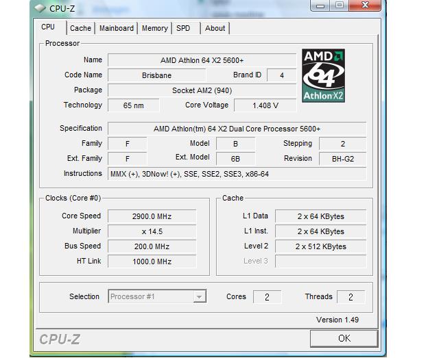

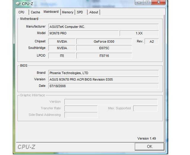

insomnimac Posted January 26, 2009 Share Posted January 26, 2009 Can you get a couple screenshots of cpu-z motherboard and cpu info Link to comment https://www.insanelymac.com/forum/topic/149363-did-anybody-install-leopard-on-asus-m3n78-pro-mobo/#findComment-1056817 Share on other sites More sharing options...
u0000 Posted January 26, 2009 Author Share Posted January 26, 2009 :-) here the screenshots. Fabio. Link to comment https://www.insanelymac.com/forum/topic/149363-did-anybody-install-leopard-on-asus-m3n78-pro-mobo/#findComment-1057235 Share on other sites More sharing options...
