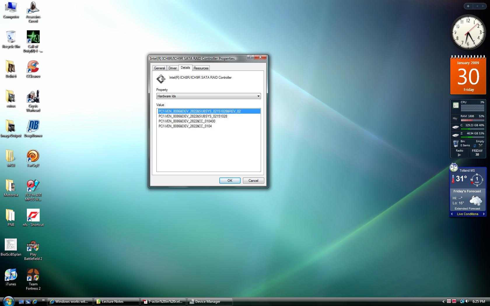

SticMAC™ Posted January 30, 2009 Share Posted January 30, 2009 I had an XPS410 Now I know it is only ICH8 but it might point you in the right direction!? This is how I solved my problem..... with "Autodetect RAID/ATA"(AHCI mode) setting in the BIOS I had the following Device/Vendor ID: 0x28218086 and with "RAID ON" in the BIOS I had the following Device/Vendor ID: 0x28228086 Check in Windows(RAID ON) what you Device/Vendor ID is and write it down, then change your BIOS and boot into MacOSX. Go to "About this Mac and see what description is given under Serial-ATA: "my example" Intel ICH8-R AHCI and the Device/Vendor ID: 0x28218086 NOW, Locate the AppleAHCIPort.kext in your System/Library/Extensions, Copy it to your desktop, Open System/Library/Extensions /AppleAHCIPort.kext/contents/Info.plist on your desktop, Search for "my example Intel ICH8-R AHCI", check to see if the Device/Vendor ID: 0x28218086 is the same as in your "About this Mac"? ADD your Device/Vendor ID, you wrote down from Windows. Save the Info.plist file, close everything and install with KextHelper Here is an example of Mine: <key>ICH8RAHCI</key> <dict> <key>CFBundleIdentifier</key> <string>com.apple.driver.AppleAHCIPort</string> <key>Chipset Name</key> <string>ICH8-R AHCI</string> <key>IOClass</key> <string>AppleAHCI</string> <key>IOPCIPrimaryMatch</key> <string>0x28218086 0x28228086</string> << I added this one for my RAID ON <key>IOProbeScore</key> <integer>2000</integer> <key>IOProviderClass</key> <string>IOPCIDevice</string> <key>Vendor Name</key> <string>Intel</string> </dict> Hope this helps SticMAC Link to comment https://www.insanelymac.com/forum/topic/148990-solved-windows-works-with-raid-on-and-mac-os-x-with-autodetect-raidata/#findComment-1061990 Share on other sites More sharing options...

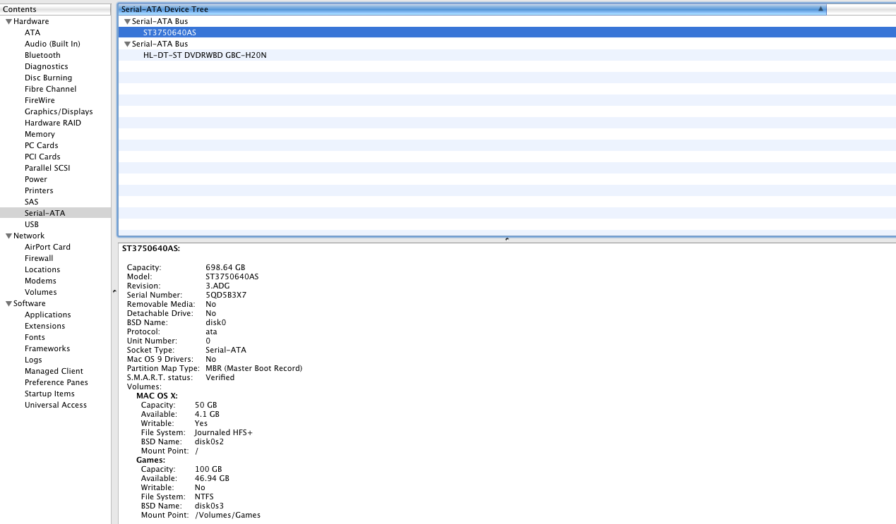

badsubby Posted January 30, 2009 Author Share Posted January 30, 2009 Thanks a lot bud for putting this up. I however dont see that ICH9 vendor ID under Serial ATA in "System Profilier". I am attaching a screenshot of what I see. Also when I click on "ATA" it says no devices installed. Same with Hardware RAID. Thanks. I checked the Vendor ID in windows and it turns out to be the same as you mentioned but I'm still gonna attach a screenshot just to be safe Link to comment https://www.insanelymac.com/forum/topic/148990-solved-windows-works-with-raid-on-and-mac-os-x-with-autodetect-raidata/#findComment-1062953 Share on other sites More sharing options...

nama2g Posted January 30, 2009 Share Posted January 30, 2009 Thanks a lot bud for putting this up. I however dont see that ICH9 vendor ID under Serial ATA in "System Profilier". I am attaching a screenshot of what I see. Also when I click on "ATA" it says no devices installed. Same with Hardware RAID. Thanks. I checked the Vendor ID in windows and it turns out to be the same as you mentioned but I'm still gonna attach a screenshot just to be safe you are using sata interfaces so your devices wont show up under ata unless you use ide and not raid unless you are using apple raid. the kext he is talking about is located in \system\library\extentions\ its called AppleAHCIPort.kext , copy it to you desktop like he said. then right click and choose show package contents.and edit the plist file in there like he said. get the raid device id from windows and add it into your plist. also check around the forum, there are dell install packs and one of them might have an AppleAHCIPort.kext to sort out your issue Link to comment https://www.insanelymac.com/forum/topic/148990-solved-windows-works-with-raid-on-and-mac-os-x-with-autodetect-raidata/#findComment-1062979 Share on other sites More sharing options...
