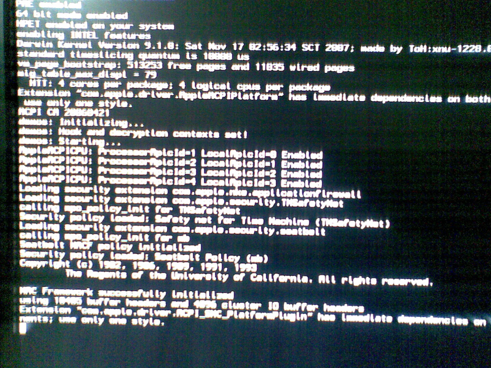

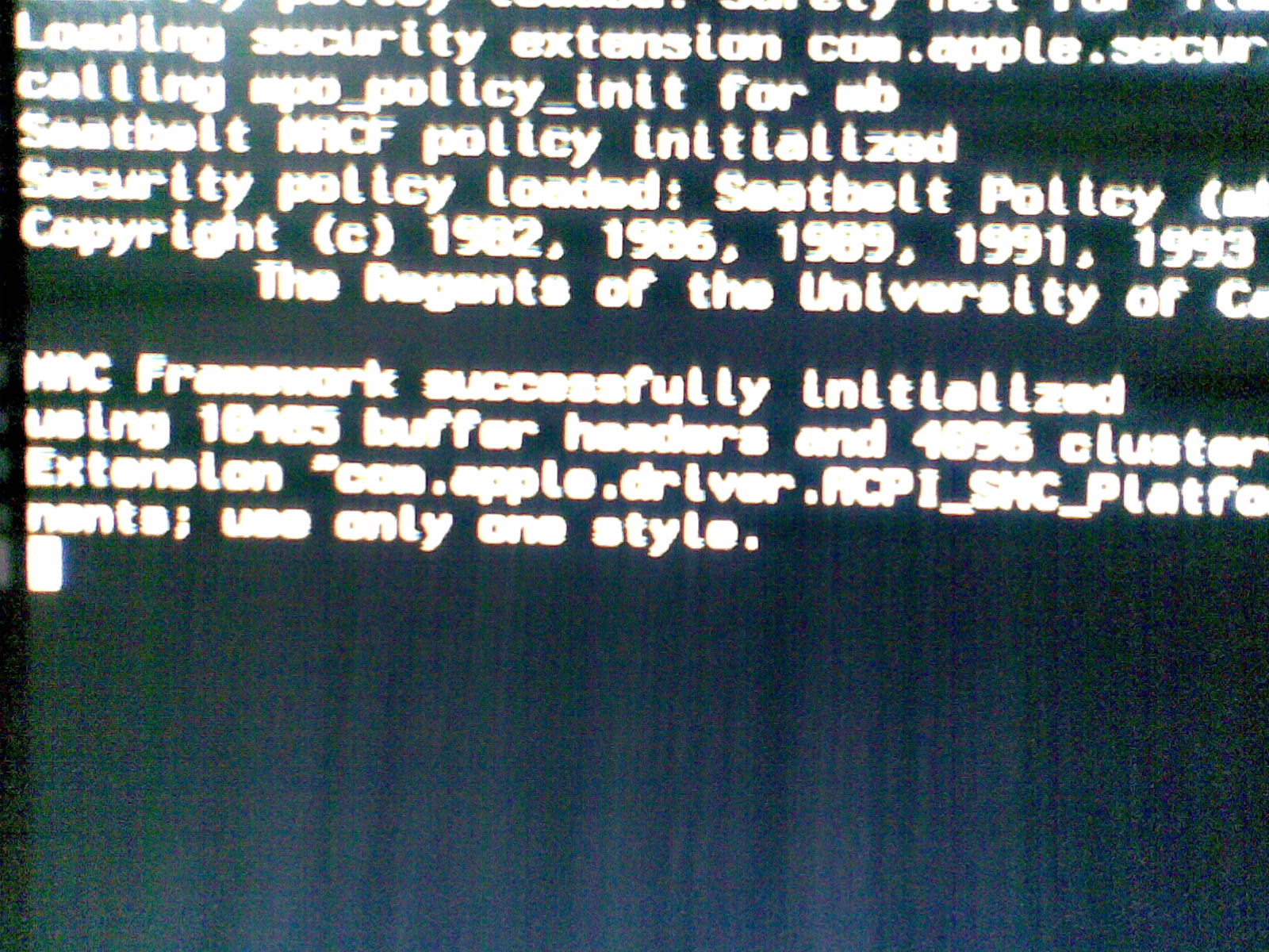

Tir@n Inside Posted January 12, 2009 Author Share Posted January 12, 2009 I boot into the DVD but i can't continue further cuz it hangs at: MAC Framework successfully initialized using 10485 buffer headers and 4096 cluster IO buffer headers dsmos: Starting... Extension "com.apple.driver.ACPI_SMC_PlatformPlugin" has immediate dependencies on both com.apple.kernel and com.apple.kpi components; use only one style. I have set sata to AHCI and have tried cpus=1 , -x -f -s but none of them works. I have got some acpi options in my bios but i dont know what to do here are some photos Hope they can help:) Link to comment https://www.insanelymac.com/forum/topic/146242-comappledriver-acpi_smc_platformplugin/#findComment-1038109 Share on other sites More sharing options...

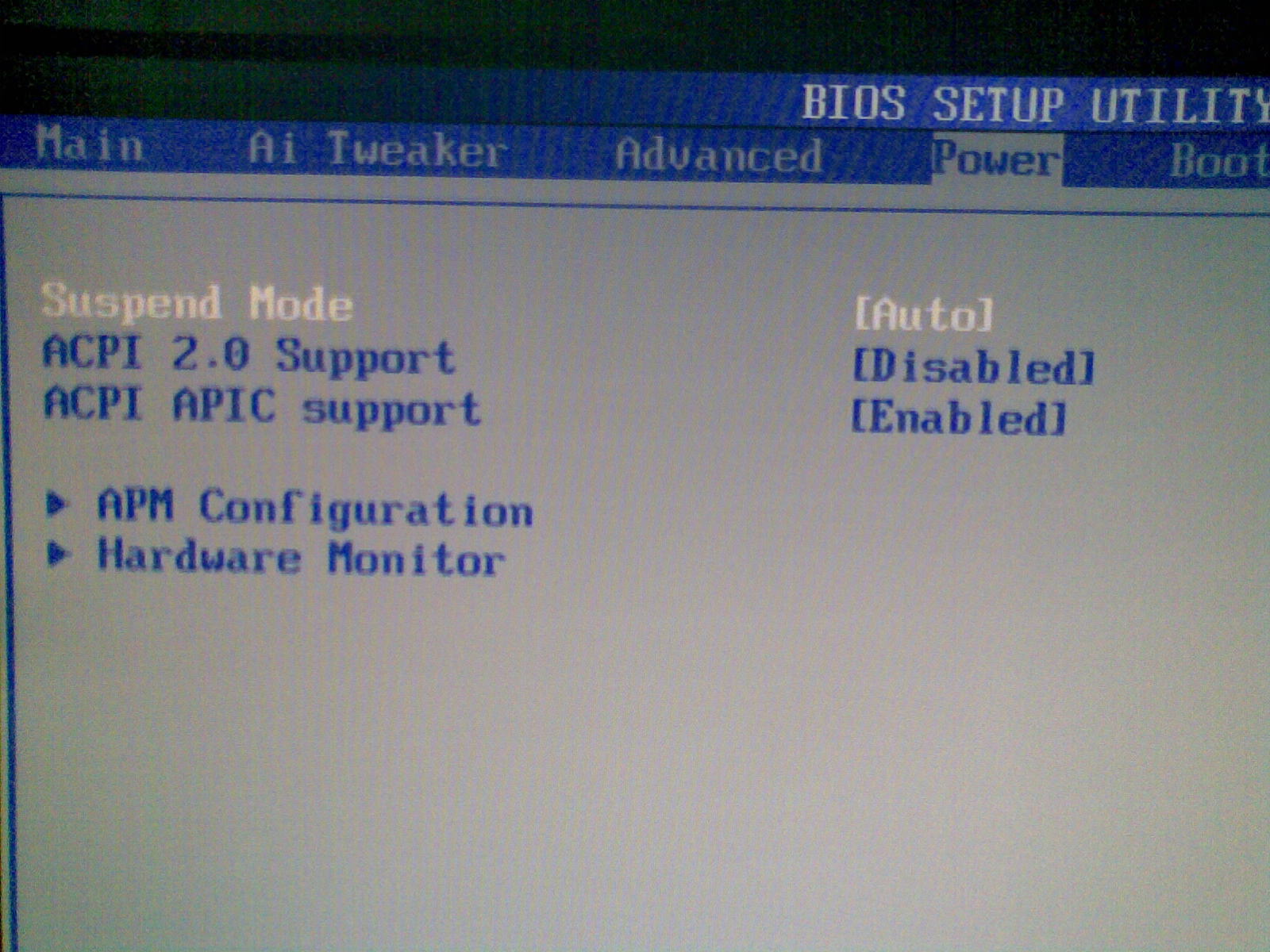

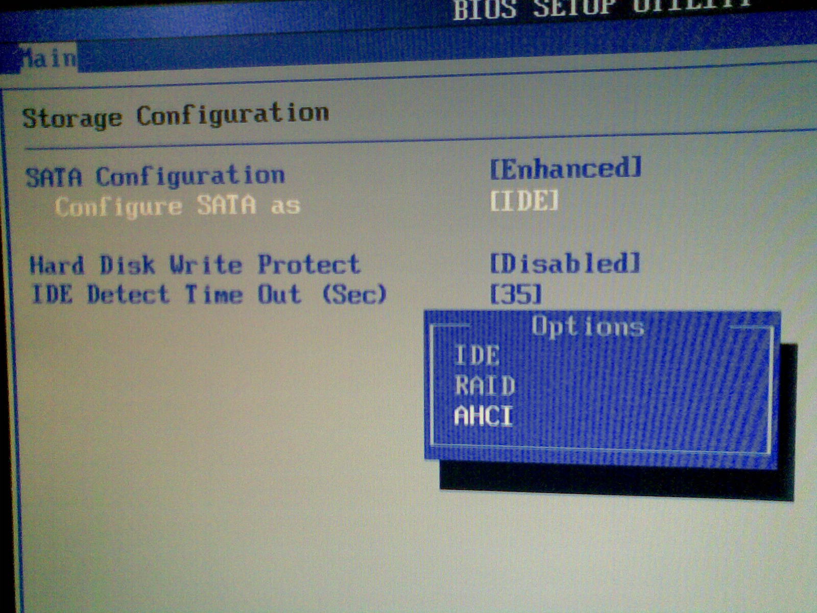

Beerkex'd Posted January 12, 2009 Share Posted January 12, 2009 Enable ACPI 2.0 and set Suspend Mode to S3. SATA must be set to AHCI. (right screenshot, configure SATA as) Under APM configuration, turn off everything. Link to comment https://www.insanelymac.com/forum/topic/146242-comappledriver-acpi_smc_platformplugin/#findComment-1038148 Share on other sites More sharing options...
Tir@n Inside Posted January 12, 2009 Author Share Posted January 12, 2009 I tried that but it didnt work. The same thing every time!!!!!!!!!! what about the Voodoo kernel 9.5.0 you told me about. What is it and how can i select it. Link to comment https://www.insanelymac.com/forum/topic/146242-comappledriver-acpi_smc_platformplugin/#findComment-1038168 Share on other sites More sharing options...

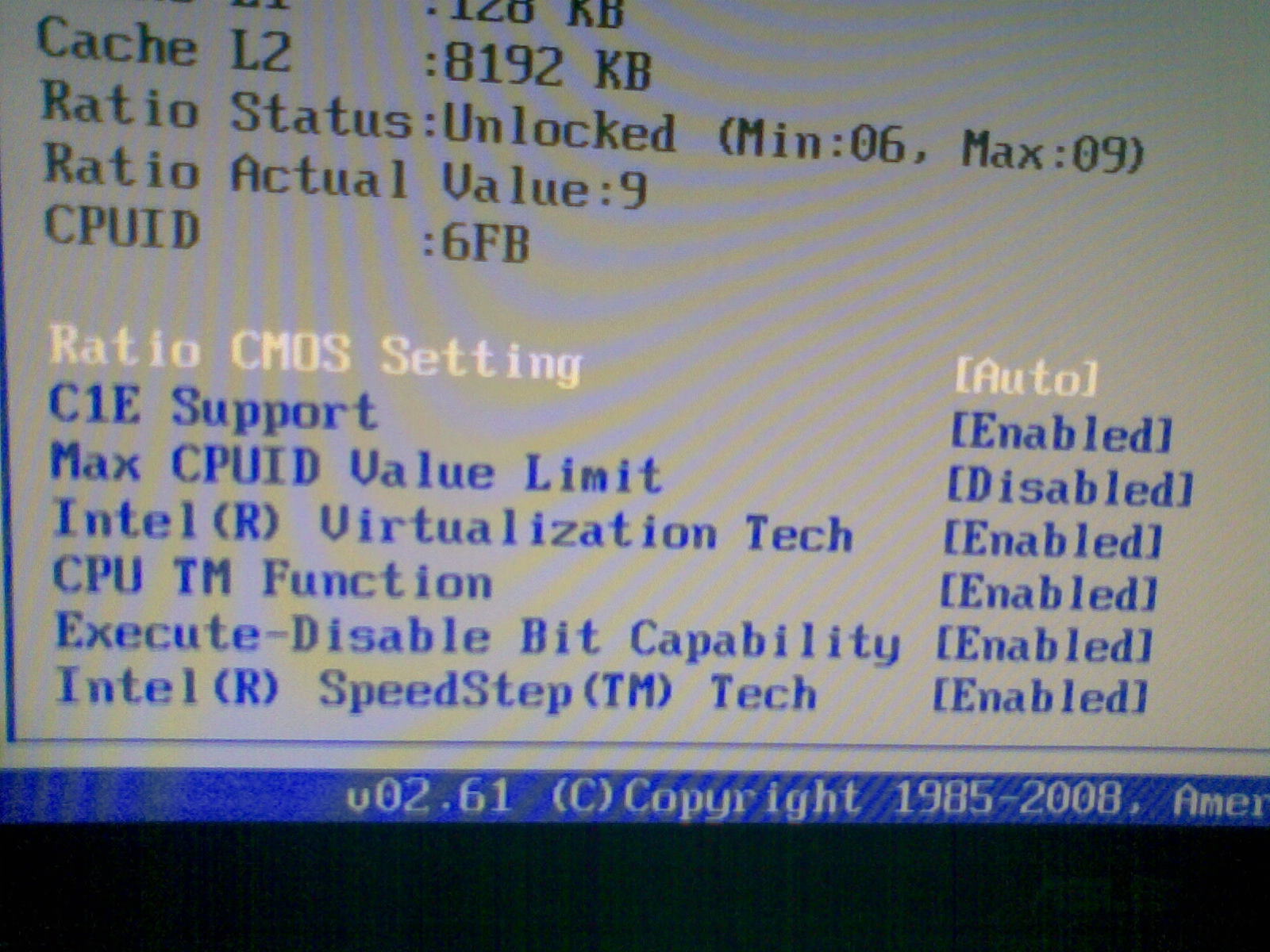

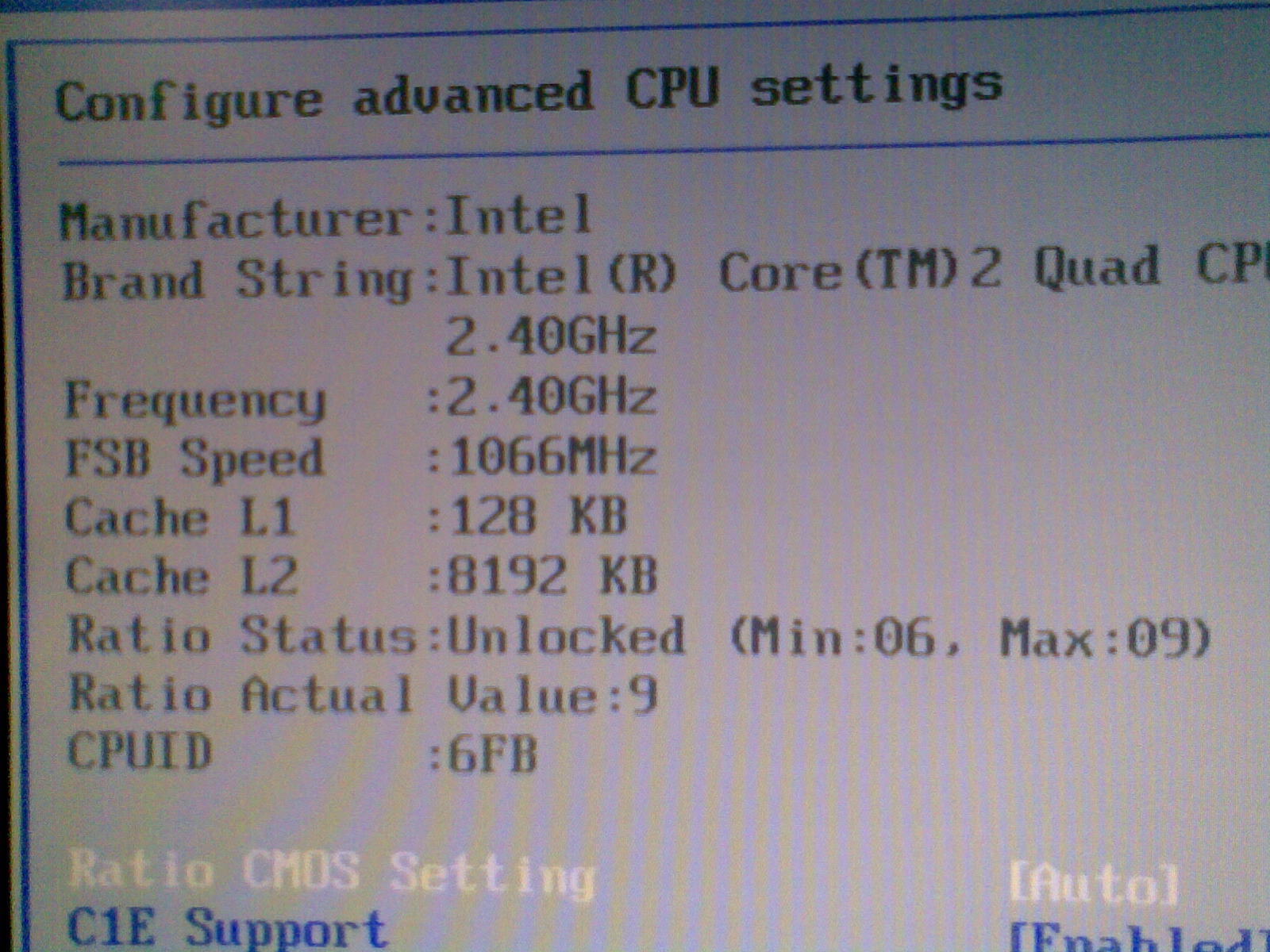

Beerkex'd Posted January 12, 2009 Share Posted January 12, 2009 what about the Voodoo kernel 9.5.0 you told me about. What is it and how can i select it. It doesn't matter if you can't get the DVD to boot. Post a screenshot of the CPU configuration page from your BIOS. Link to comment https://www.insanelymac.com/forum/topic/146242-comappledriver-acpi_smc_platformplugin/#findComment-1038215 Share on other sites More sharing options...

Beerkex'd Posted January 12, 2009 Share Posted January 12, 2009 He already tried booting with CPUS=1 and that didn't work. So a modded BIOS won't help. Something else is wrong. Tiran, can you do what I asked you here: http://forum.insanelymac.com/index.php?s=&...t&p=1038215 Link to comment https://www.insanelymac.com/forum/topic/146242-comappledriver-acpi_smc_platformplugin/#findComment-1038400 Share on other sites More sharing options...
Tir@n Inside Posted January 12, 2009 Author Share Posted January 12, 2009 He already tried booting with CPUS=1 and that didn't work. So a modded BIOS won't help. Something else is wrong. Tiran, can you do what I asked you here: http://forum.insanelymac.com/index.php?s=&...t&p=1038215 Yes sure thing and thanks taking for your time:) Link to comment https://www.insanelymac.com/forum/topic/146242-comappledriver-acpi_smc_platformplugin/#findComment-1038460 Share on other sites More sharing options...
Beerkex'd Posted January 13, 2009 Share Posted January 13, 2009 uh..I'm sorry to say that it looks fine! I've seen some people recommend disabling virtualization but I don't believe it matters. Maybe I'll change my opinion on that once I can afford to buy a CPU that supports it! Link to comment https://www.insanelymac.com/forum/topic/146242-comappledriver-acpi_smc_platformplugin/#findComment-1038964 Share on other sites More sharing options...
