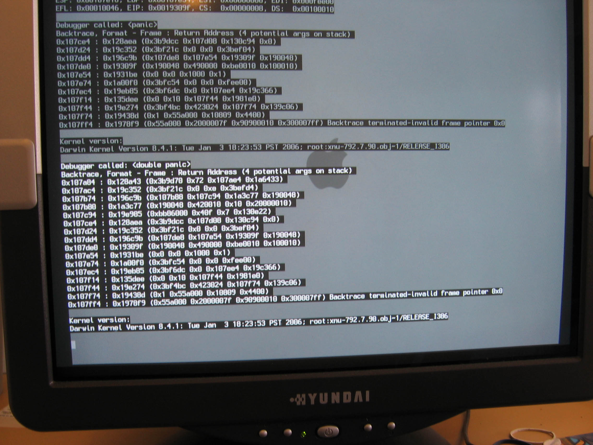

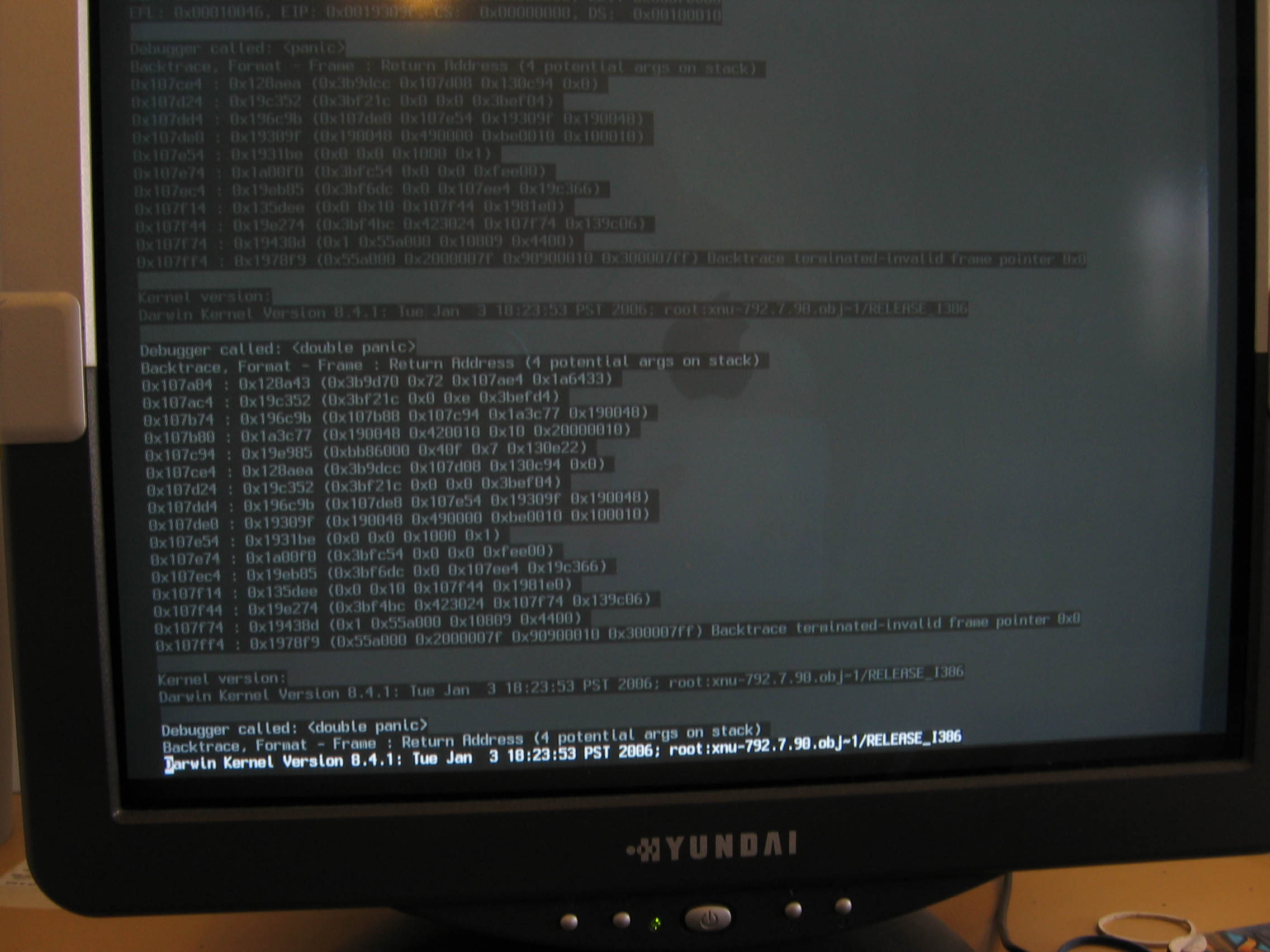

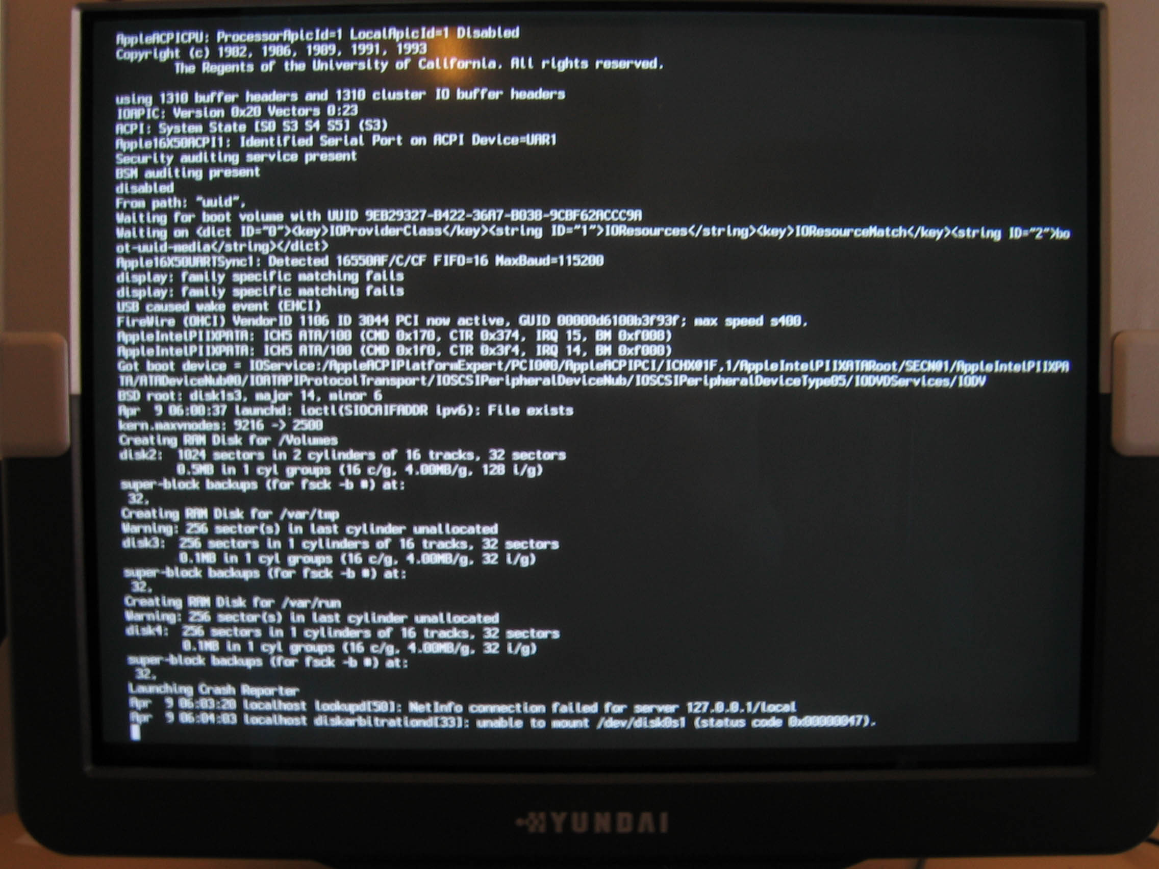

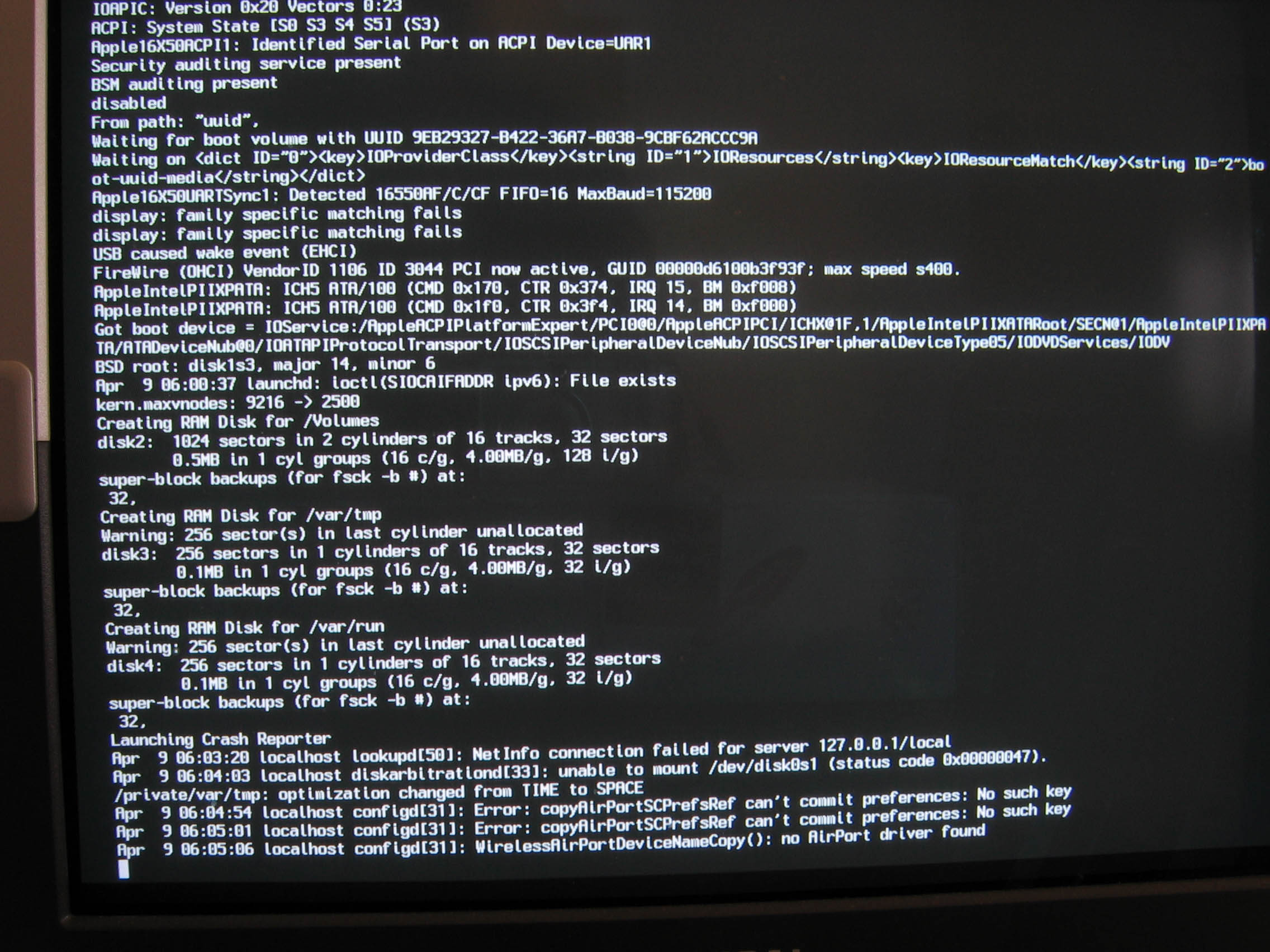

Dave McMahon Posted April 9, 2006 Share Posted April 9, 2006 Hello i have installed OSx and the install was working with some install (-v) errors My spec is Gigabyte GA-81SXT-FS (Fujitsu siemens OEM Board) 512MB of RAM in Dual Channel 266MHz 40GB HDD Three Partitions 1,NTFS (9GB) 2,HFS+ (6GB) HFS+ (21GB) Gigabyte ATI Radeon 9200SE (128MB) Onboard AC97 Sound Realtek onboard NIC Unfortunalty despite the installer completeing i now get Double panic errors as per the screenshots below (first two are from the install last two are after install) next pic pic 3 Sorry my CPU is P42.0GHz and has SSE2 (NOT SSE3) i think you need a prescot for SSE3 Link to comment https://www.insanelymac.com/forum/topic/14477-double-panic-agter-install/ Share on other sites More sharing options...

djtrix Posted April 10, 2006 Share Posted April 10, 2006 Just thinking this Hard drive will (eventully) be dual booting W2K and OSx but i have another 40GB drive that OSx can "have" (my bios program lets me choose the booting HDD or Optical, whatever) which i think would be better! So what do you think (this question sometimes gete me into trouble!) Thanks for help / sarcasm etc! Hmm been told that pressing the F8 key at starup would invoke a menu with the diag -v option but cannot get that to work? is F8 the correct key? i think i am using Darwin 8.01 (but came with the 10.4.5 iso cant find the .img file on the iso to try another method of installing! Yes, F8 is the correct key.... try the -x option if you ever get to that screen, this is kinda the "safe mode" although in your case i doubt it will help much. No clue whats going wrong, but its most likely some unsuported hardware. Some people who have had kernel panics after a clean install have had success by going into the terminal (from the install cd) and removing some kext folders from /System/Library/Extensions Try to see whats getting loaded right before the crash, and disable that kext folder by moving it out of your extensions directory. example sudo -s cd /Volumes/OSX/System/Library/ mkdir Extensions.Backup cd Extensions mv broken.extension.kext ../Extensions.Backup kextcache -k ./ reboot The kextcache simply rebuilds the driver cache of all the drivers taht gets loaded when you boot up. I know none of this is specific info, but i haven't been able to figure out exactly where your system is crashing based on the screenshots provided. Also, try writing down every single piece of hardware in your box, then one by one look through the forums to see if its supported, or if there are any specific workarounds to get it working. Simple stuff like having a bad nic card can cause you a kernel panic on bootup after a clean install. Hope this helps, Good luck, Dre Link to comment https://www.insanelymac.com/forum/topic/14477-double-panic-agter-install/#findComment-93348 Share on other sites More sharing options...
