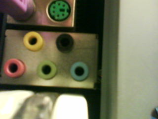

bharned3 Posted January 10, 2009 Share Posted January 10, 2009 Thanks DivisionByZero my install was successful, however I have no sound. I did install the AC97 Audio.. Anything else I can try Link to comment https://www.insanelymac.com/forum/topic/143610-howto-dell-dimension-4600-ideneb-os-x-1055-perfect-install/#findComment-1034639 Share on other sites More sharing options...
bharned3 Posted January 12, 2009 Share Posted January 12, 2009 Thanks DivisionByZero my install was successful, however I have no sound. I did install the AC97 Audio.. Anything else I can try I got it working. I looked closer on the back of my dell and realized I had an on board audio and an audio card, The On board audio was covered up with a plastic plug. I pulled that off, plugged into the black one and it is working... How can I back up mu install so if I ever need to reinstall I can just restore this image... Link to comment https://www.insanelymac.com/forum/topic/143610-howto-dell-dimension-4600-ideneb-os-x-1055-perfect-install/#findComment-1037414 Share on other sites More sharing options...
DivisionByZero Posted January 12, 2009 Author Share Posted January 12, 2009 I got it working. I looked closer on the back of my dell and realized I had an on board audio and an audio card, The On board audio was covered up with a plastic plug. I pulled that off, plugged into the black one and it is working... How can I back up mu install so if I ever need to reinstall I can just restore this image... I don't know.... I asked here but theres not much help: http://forum.insanelymac.com/index.php?showtopic=143787 I just restored the hard drive to a new external drive using the disk utility on the dvd. Link to comment https://www.insanelymac.com/forum/topic/143610-howto-dell-dimension-4600-ideneb-os-x-1055-perfect-install/#findComment-1037454 Share on other sites More sharing options...

albob Posted February 28, 2009 Share Posted February 28, 2009 GREAT Guide!!! I tried for 8 hours to get this working with the boot-132 method and with iDeneb 1.4 with no luck I found a copy of iDeneb 1.3, and it worked like a charm. My only issue is that the sound comes out of the black plug, not the green, so dual booting may be an issue. If anyone can figure out how to enable the green audio output, I'd appreciate it. Thanks for all of your work!! My Specs Dell 4600 2.8Ghz HT 2.5 Mb Memory NVidia GEForce 5700 LE Onboard audio & network Logitech Quick Cam Connect (works after I installed Macam) Link to comment https://www.insanelymac.com/forum/topic/143610-howto-dell-dimension-4600-ideneb-os-x-1055-perfect-install/#findComment-1094433 Share on other sites More sharing options...
