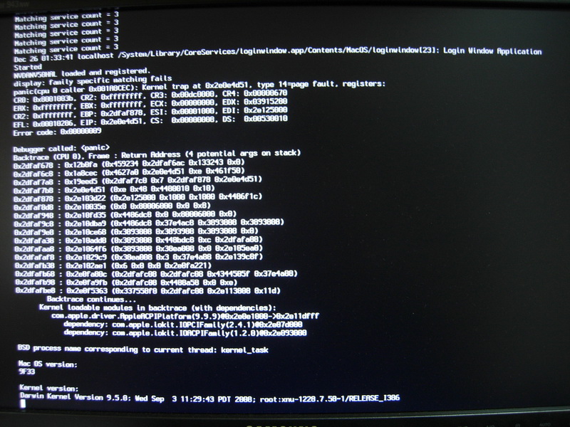

laybuddhist Posted December 26, 2008 Share Posted December 26, 2008 i'm trying to intall iATKOS 5i on pc with MSI P35-neo motherboard(cpu:E7200) and 8400GS(256M) VGA BIOS has been updated the newest one v1.A0 (I'v flashed mod_BIOS v1.70, but the problem keep occuring) All the kernal and enabler have been tried, but i still got this panic (see attached) Solved!! By the way, i reflashed BIOS with the mod one(v1.70) Link to comment https://www.insanelymac.com/forum/topic/142956-panic-of-iatkos-v5i-1055-on-msi-7360-solved/ Share on other sites More sharing options...
verdant Posted December 26, 2008 Share Posted December 26, 2008 i'm trying to intall iATKOS 5i on pc with MSI P35-neo motherboard(cpu:E7200) and 8400GS(256M) VGA BIOS has been updated the newest one v1.A0 (I'v flashed mod_BIOS v1.70, but the problem keep occuring) All the kernal and enabler have been tried, but i still got this panic (see attached) Screen shot may point to ACPI APIC issues......did you choose stock ACPI modified or x86 ACPI, plus APIC driver......if not, you could try doing so...... Link to comment https://www.insanelymac.com/forum/topic/142956-panic-of-iatkos-v5i-1055-on-msi-7360-solved/#findComment-1014304 Share on other sites More sharing options...

laybuddhist Posted December 26, 2008 Author Share Posted December 26, 2008 hah, it is working !!!! DO NOT use SMBIOS enabler, Use classic x86 patched SMBIOS instead.! thx all of you!!! Link to comment https://www.insanelymac.com/forum/topic/142956-panic-of-iatkos-v5i-1055-on-msi-7360-solved/#findComment-1014495 Share on other sites More sharing options...
