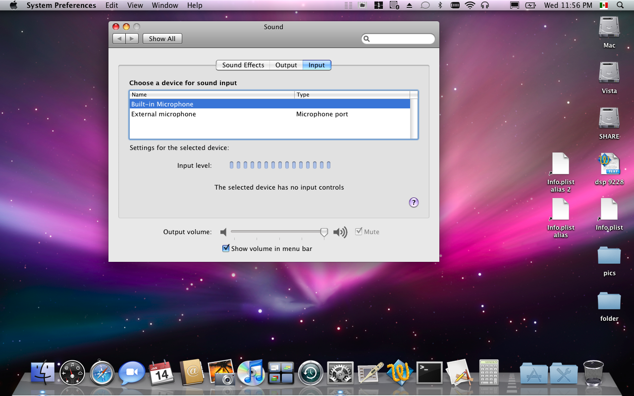

macgirl Posted January 15, 2009 Share Posted January 15, 2009 I put the dsp line of the ALC888 on the Mic and IntSpeakers, on the Speakers it adds some volume, which I think is great. Here is a link of the Internal working: I am ussing this pin config: wich traduces into: 0 13 71c 9 0 node 19 association 9 sequence 0 0 13 71d 0 3 node 19 Color Unknown Misc Reserved 0 13 71e a 6 node 19 Mic In Other Digital 0 13 71f 5 0 node 19 port 5 Location 0 Link to comment https://www.insanelymac.com/forum/topic/142521-dell-xps-m1530-m1330-applehda-solutions-sigmatel-stac-9228/page/5/#findComment-1041604 Share on other sites More sharing options...

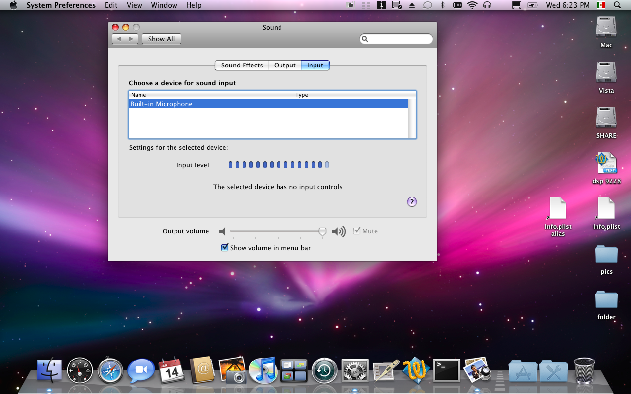

macgirl Posted January 15, 2009 Share Posted January 15, 2009 I used 19-27-7, 19-28-8, and 19-29-9 and all work but only with node 19 alone. I tried several combinantions anytime I add some Output node sound can't be detected or no sound from speakers. Right know I also testing 2 imputs and Internal Mic is working, see pic: These are the combinations: Speakers + Mic = no sound devices recognized Headphone + Mic = no sound devices recognized Line Out + Mic = no sound devices recognized Speakers + Headphone + Mic = Mic not working Speakers + Line Out + Mic = no sound devices recognized Headphones + Line Out + Mic = no sound devices recognized Speakers + Headphones + Line Out + Mic = Mic not working Speakers + Headphones + Line Out + Mic + External Mic= Mic not working, External Mic works Mic + External Mic= Mic works and External Mic works Somehow Nodes of Speakers and Internal Mic are linked somehow, but pin configs of vista or Linux does not work becuase every time I user port 9 on any of theste 2 nodes sound is lose or no devices recognized. I will try some more combinations Link to comment https://www.insanelymac.com/forum/topic/142521-dell-xps-m1530-m1330-applehda-solutions-sigmatel-stac-9228/page/5/#findComment-1041827 Share on other sites More sharing options...

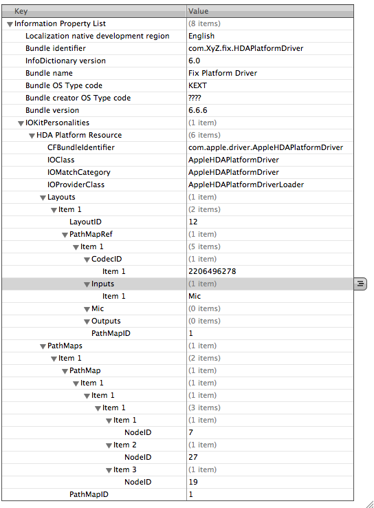

macgirl Posted January 15, 2009 Share Posted January 15, 2009 Here are the kexts for working Digital Internal Mic on XPS M1x30, they need the stock AppleHDA.kext (aka vanilla also) here is a picture of the layout and pathmap: FixSigmaTel_STAC9228_only_mic.zip Link to comment https://www.insanelymac.com/forum/topic/142521-dell-xps-m1530-m1330-applehda-solutions-sigmatel-stac-9228/page/5/#findComment-1042660 Share on other sites More sharing options...

Yehor Lvivski Posted January 15, 2009 Share Posted January 15, 2009 well after several reboots I got mic working WOOOOOOT my AppleHDA shows it's 1.6.2a37 as far as i remember it's vanila BUT i have lost my Hardware information it shows only "There was an error while gathering this information." Link to comment https://www.insanelymac.com/forum/topic/142521-dell-xps-m1530-m1330-applehda-solutions-sigmatel-stac-9228/page/5/#findComment-1042736 Share on other sites More sharing options...
