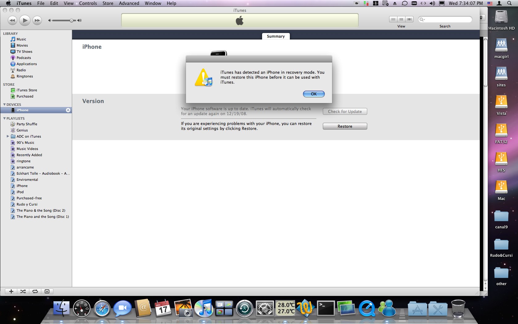

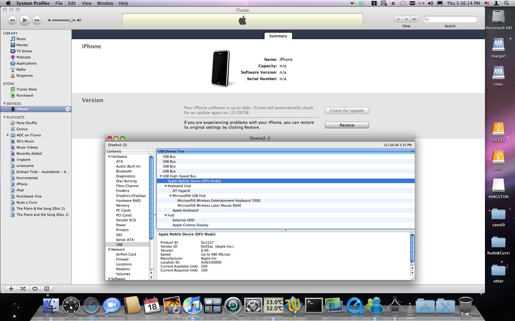

Well I just put my iPhone on DFU mode and the Mac Pro detected right away, maybe because it is connecte to the Apple Cinema USB HUB:
EDIT:
I also make the same but with my Dellintosh and it also detects the recovery mode :(
Using a USB hub is a workaround I believe, so it should work fine using a hub. I am not sure how it is supposed to affect hackintoshes.
Dev team said that this might be a kernel bug fix instead of being a countermeasure.
