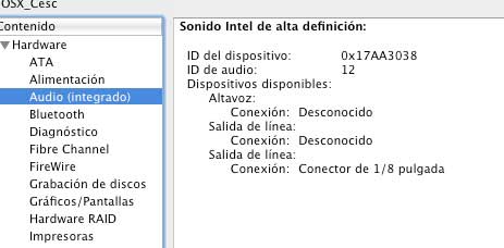

Noveo Posted January 14, 2009 Share Posted January 14, 2009 Hi. I have try this driver and run ok, but my PC have two outputs. The back line-output and front headphones output. The back line-output run ok, but headphones not run. Have you any idea how resolve it? Thx! Link to comment https://www.insanelymac.com/forum/topic/140869-ideneb-1055-intel-hd-audio-conexant-cx20561-intel-82801ib-ich9/#findComment-1040878 Share on other sites More sharing options...

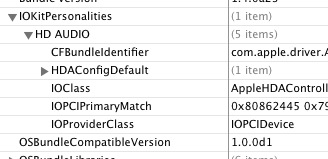

Podkovka Posted January 15, 2009 Share Posted January 15, 2009 Hi. Thx for your help. I download it and install, but no run ok. I have removed Azalia and ALCInject and restart. What I need do more? Thx a lot! Which vendor ID of your device HD Audio Controller (Look OSX86Tools or regedit Windows)? It must be set key IOPCIPrimaryMatch in the AppleHDAController.kext Sorry for my English, I am Russian PS And restart with the key -v -f Link to comment https://www.insanelymac.com/forum/topic/140869-ideneb-1055-intel-hd-audio-conexant-cx20561-intel-82801ib-ich9/#findComment-1042662 Share on other sites More sharing options...

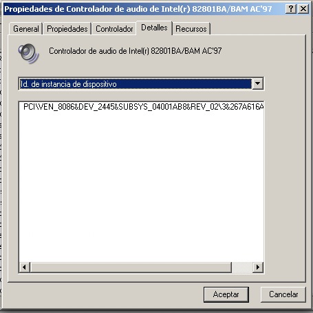

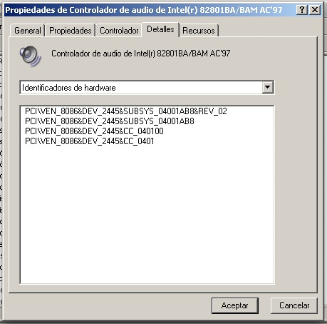

Noveo Posted January 16, 2009 Share Posted January 16, 2009 Thanks Podlovka! I detect my Vendor Id It's 0x80862445. I have put dis ID in IOPCIPrimaryMatch. Then I have repared extension permissions and cleared extension cache, and I have restart computer but I don't have audio. I need do any more? Add EFI string? Delete others Extensions? Thx very much! Link to comment https://www.insanelymac.com/forum/topic/140869-ideneb-1055-intel-hd-audio-conexant-cx20561-intel-82801ib-ich9/#findComment-1043216 Share on other sites More sharing options...
Podkovka Posted January 16, 2009 Share Posted January 16, 2009 Thanks Podlovka! I detect my Vendor Id It's 0x80862445. I have put dis ID in IOPCIPrimaryMatch. Then I have repared extension permissions and cleared extension cache, and I have restart computer but I don't have audio. I need do any more? Add EFI string? Delete others Extensions? Thx very much! You Vendor ID 0x24458086 Link to comment https://www.insanelymac.com/forum/topic/140869-ideneb-1055-intel-hd-audio-conexant-cx20561-intel-82801ib-ich9/#findComment-1043248 Share on other sites More sharing options...
Noveo Posted January 16, 2009 Share Posted January 16, 2009 Same problem... I have change the vendor Id for 0x24458086. But nothing... not work it... Thx. Link to comment https://www.insanelymac.com/forum/topic/140869-ideneb-1055-intel-hd-audio-conexant-cx20561-intel-82801ib-ich9/#findComment-1043265 Share on other sites More sharing options...
Podkovka Posted January 16, 2009 Share Posted January 16, 2009 Same problem... I have change the vendor Id for 0x24458086. But nothing... not work it... Thx. You CodecID 0x505114F1 (looking post #2 & #6)? Link to comment https://www.insanelymac.com/forum/topic/140869-ideneb-1055-intel-hd-audio-conexant-cx20561-intel-82801ib-ich9/#findComment-1043339 Share on other sites More sharing options...
Noveo Posted January 16, 2009 Share Posted January 16, 2009 This is all audio details: Audio card: Hardware Id: Device Instance: Thx! Link to comment https://www.insanelymac.com/forum/topic/140869-ideneb-1055-intel-hd-audio-conexant-cx20561-intel-82801ib-ich9/#findComment-1043453 Share on other sites More sharing options...
Podkovka Posted January 16, 2009 Share Posted January 16, 2009 This is all audio details: No! This data controllers, you need data on the codec. Driver change to the codec 14F15051 (chip Conexant Cx20561) You can try, under any, but you need to sound dump Linux and the Pin config Windows Vista Look http://forum.insanelymac.com/index.php?showtopic=137188 and http://forum.insanelymac.com/index.php?showtopic=127227 Link to comment https://www.insanelymac.com/forum/topic/140869-ideneb-1055-intel-hd-audio-conexant-cx20561-intel-82801ib-ich9/#findComment-1043476 Share on other sites More sharing options...
