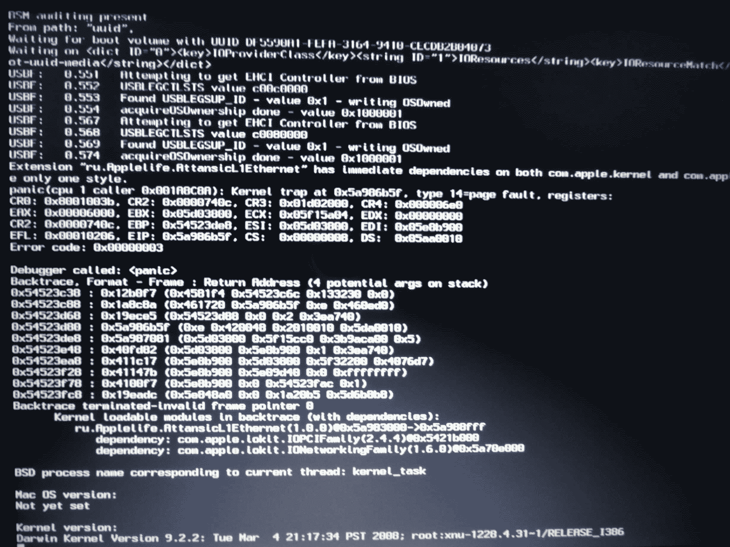

Pythia Posted November 3, 2008 Share Posted November 3, 2008 I guess am from those still interested to get iDeneb work. Getting the "must restart" grey screen after each install. using -F have even managed to get 5 secs of the logo and loader spinning before that screen.. attaching a pic where getting the error. Maybe will help the team get a solution or a patch.. am installing on HP pavilion dv5 1080 with intel T9400, 4Gbs and nvidia. Link to comment Share on other sites More sharing options...

sharms Posted November 3, 2008 Share Posted November 3, 2008 To everyone: Try disabling onboard LAN/AUDIO while installing. Use Vanilla kernel, your Chipset driver, AppleBios for your RAM type, install VGA, Audio, LAN drivers only if yours is listed. Then boot first time using -v -x parameter. Register. Then reboot (don't worry if comp doesn't reboot - just press reset button). Enable onboard LAN/AUDIO. Install drivers for LAN, AUDIO. After each driver installation - first time reboot in with -x (safe mode) - to check if device is working. Then try to reboot in normal mode. Link to comment Share on other sites More sharing options...
