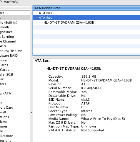

mitch_de Posted October 30, 2008 Share Posted October 30, 2008 Yeah that works (avoid older "JM 64 Bit fixed downloads or JM patches from OSX86 DVDs- they didnt work really!) More easier: http://code.google.com/p/darwin-ata/downloads/list here are always the newest JM and newest AppleVIA ( both fixes > 3 GB RAM problems!) With that JM (0.6) you have no more problems using more RAM (using not fixed jm.kexts: kernel panic or very instable system). This is an solution if you dont want / cant switch to SATA (AHCI) Only. Link to comment https://www.insanelymac.com/forum/topic/133843-where-do-i-find-jmicronatakext/#findComment-948977 Share on other sites More sharing options...
madhias Posted November 2, 2008 Author Share Posted November 2, 2008 Yeah that works (avoid older "JM 64 Bit fixed downloads or JM patches from OSX86 DVDs- they didnt work really!)More easier: http://code.google.com/p/darwin-ata/downloads/list here are always the newest JM and newest AppleVIA ( both fixes > 3 GB RAM problems!) With that JM (0.6) you have no more problems using more RAM (using not fixed jm.kexts: kernel panic or very instable system). This is an solution if you dont want / cant switch to SATA (AHCI) Only. Thanks, good link!! Link to comment https://www.insanelymac.com/forum/topic/133843-where-do-i-find-jmicronatakext/#findComment-952342 Share on other sites More sharing options...
madhias Posted November 2, 2008 Author Share Posted November 2, 2008 Ok, I´ve installed the newer Version of JMicron.kext from the Goolge Source Code Page above and my DVD Drive works now! Nice! Thanks, i wanted to buy since a year or so a new SATA Writer with Lightscribe, but now my old good working IDE LiteOn has to do his job even longer Link to comment https://www.insanelymac.com/forum/topic/133843-where-do-i-find-jmicronatakext/#findComment-952396 Share on other sites More sharing options...
