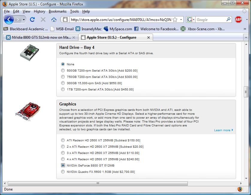

TCMW Posted October 16, 2008 Share Posted October 16, 2008 On the Apple Store is now possible to configure a MacPro with a 8800 GTS (G92) 512mb. Since I have an Inno3d card sitting around... I was wondering if it would be possible to make it work in a (real) MacPro, flashing the rom with a Pc (without touching kexts and messing around with injectors on my Mac...) Cheers -Naymaxoe Link to comment https://www.insanelymac.com/forum/topic/131458-nvidia-8800-gts-512mb-now-on-macpro/ Share on other sites More sharing options...

ludacrisvp Posted October 25, 2008 Share Posted October 25, 2008 On the Apple Store is now possible to configure a MacPro with a 8800 GTS (G92) 512mb.Since I have an Inno3d card sitting around... I was wondering if it would be possible to make it work in a (real) MacPro, flashing the rom with a Pc (without touching kexts and messing around with injectors on my Mac...) Cheers -Naymaxoe Where did you see a "8800 GTS"?? Apple does not offer that card. Link to comment https://www.insanelymac.com/forum/topic/131458-nvidia-8800-gts-512mb-now-on-macpro/#findComment-943682 Share on other sites More sharing options...
vbetts Posted October 26, 2008 Share Posted October 26, 2008 On the Apple Store is now possible to configure a MacPro with a 8800 GTS (G92) 512mb.Since I have an Inno3d card sitting around... I was wondering if it would be possible to make it work in a (real) MacPro, flashing the rom with a Pc (without touching kexts and messing around with injectors on my Mac...) Cheers -Naymaxoe Eh? I don't see any GTS in Mac Pro configurations. But even if you flashed the GTS to a GT, it'll limit it down to the GTs performance, which isn't bad, but in my opinion it's a dumb move. Link to comment https://www.insanelymac.com/forum/topic/131458-nvidia-8800-gts-512mb-now-on-macpro/#findComment-943983 Share on other sites More sharing options...
Burning_Sensation Posted October 26, 2008 Share Posted October 26, 2008 Eh? I don't see any GTS in Mac Pro configurations. But even if you flashed the GTS to a GT, it'll limit it down to the GTs performance, which isn't bad, but in my opinion it's a dumb move. Nope, no GTS. The flash would limit it to the core and mem speed of the GT, but you could boost those in the BIOS to match the GTS. I believe you'd get all 128 shaders (the GT has 112) as that is hardware specific...[ There was an ATi 800 GT that you could flash to the XT, to get all 16-pipelines, then flash back to the GT (for fan control if I remember correctly) and still have all 16-pipes ] I'm thinking of trying one myself; I already have 2 of the eVGA 8800 GT's (Superclocked 802's) that I was going to use but if a cheap GTS should pop-up (there were some used/refurbed eVGA GTS cards recently on their site in the B-Stock section for $99, they also sold them via NewEgg for $109). I have a little experience flashing cards, from way back to the ATi 7000's and most recently 256MB and 512MB 7800GTX's for dual and quad core G5's. NVflash is easy to use, and you could always flash it back to the PC version and resell if it didn't work. The Hackintosh guys have 9800 GTX+ cards working, btw. There's good info at the MacElite Wiki, the forums are gone now *sigh* but the Wiki still has a lot of info.... Link to comment https://www.insanelymac.com/forum/topic/131458-nvidia-8800-gts-512mb-now-on-macpro/#findComment-944016 Share on other sites More sharing options...
