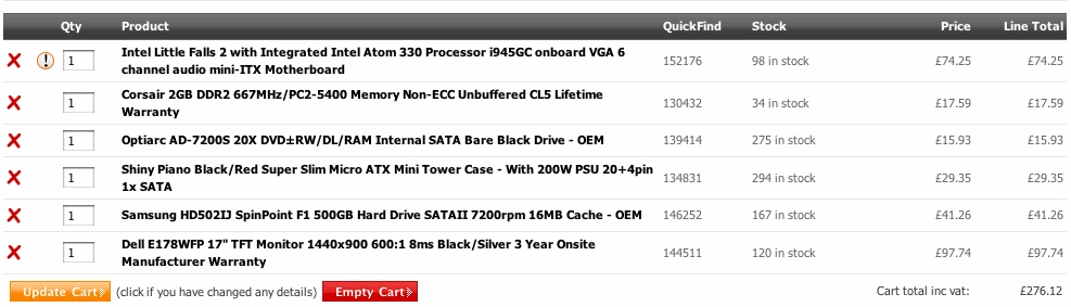

bmoose Posted October 12, 2008 Share Posted October 12, 2008 I saw a post in another forum where someone had built a Mac for under $250 so I thought I would try the same for anyone ordering in the UK. I managed to get the price to £228.49 with a copy of Leopard, so if you already own it then it would only be about £145. I just wanted to run these specs by everyone to see how compatible they would be, they look like they would work OK. Motherboard, CPU and Graphics - £57.16 Gigabyte GA-GC230D - Includes 1.6Ghz Dual Core Intel Atom 330 processor, Onboard video (Intel GMA 950), Sound, LAN, SATA, USB, IDE. RAM - £12.94 Corsair 1GB 533Mhz DDR2 HDD - £25.98 Maxtor 160GB Optical Drive - £13.85 LG 20x DVDRW Sata Case + PSU - £29.99 EV Shiny Piano Black with 400W PSU Operating System - £85 Mac OS X Leopard Total - £224.92 Hopefully, if we can prove this to be compatible hardware then this will be useful for UK buyers. EDIT - Changed Mainboard to Intel 945 GC with Intel Atom 330 (Dual Core) processor. Link to comment https://www.insanelymac.com/forum/topic/130750-custom-build-mac-for-under-%C2%A3250-uk/ Share on other sites More sharing options...
Nick14 Posted October 12, 2008 Share Posted October 12, 2008 why not get the dual core atom it for the same price Link to comment https://www.insanelymac.com/forum/topic/130750-custom-build-mac-for-under-%C2%A3250-uk/#findComment-927092 Share on other sites More sharing options...
bmoose Posted October 12, 2008 Author Share Posted October 12, 2008 Yeh, can't argue with that logic. Didn't realise it had been released already but thanks for the heads up. Link to comment https://www.insanelymac.com/forum/topic/130750-custom-build-mac-for-under-%C2%A3250-uk/#findComment-927173 Share on other sites More sharing options...

nebulOSX Posted October 15, 2008 Share Posted October 15, 2008 Ok people, please keep in mind that I am a total n00b at building computers, never done it before.. can someone tell me that these parts are all good and compatible with each other? thanks a lot, will be ordering very soon if all is ok.. D945GCLF2 board with Intel atom 330 1.6ghz EV shiny black piano case Maxtor 160gb HD Corsair 1GB ddr2 Pioneer DVD-R Will I need any extra cables etc? Any tips from anyone about building computers? Link to comment https://www.insanelymac.com/forum/topic/130750-custom-build-mac-for-under-%C2%A3250-uk/#findComment-931447 Share on other sites More sharing options...
bmoose Posted October 15, 2008 Author Share Posted October 15, 2008 No everything should come with it. No additional stuff should be required. If you need any help when the computer arrives just ask, I have not used these components before but have built many PC's. Its a probably a good PC to start with as the CPU and graphics are already done for you. Installing CPU and HDD is very easy and the RAM isn't really difficult either, just gotta make sure everything is inserted correctly. Good luck. Link to comment https://www.insanelymac.com/forum/topic/130750-custom-build-mac-for-under-%C2%A3250-uk/#findComment-932072 Share on other sites More sharing options...

stnelson Posted October 17, 2008 Share Posted October 17, 2008 The D945GCLF2 board only support one DDR ram slot. The picture they show is wrong in your link. This is what it looks like http://www.mini-box.com/Intel-D945GCLF2-Mini-ITX-Motherboard So you'll have to buy one 2gb ram stick, instead of two 1gb. BTW everything on the board is compatible. Take a look here http://forum.insanelymac.com/index.php?showtopic=113623 Ok people, please keep in mind that I am a total n00b at building computers, never done it before.. can someone tell me that these parts are all good and compatible with each other? thanks a lot, will be ordering very soon if all is ok.. D945GCLF2 board with Intel atom 330 1.6ghz EV shiny black piano case Maxtor 160gb HD Corsair 1GB ddr2 Pioneer DVD-R Will I need any extra cables etc? Any tips from anyone about building computers? Link to comment https://www.insanelymac.com/forum/topic/130750-custom-build-mac-for-under-%C2%A3250-uk/#findComment-933952 Share on other sites More sharing options...
