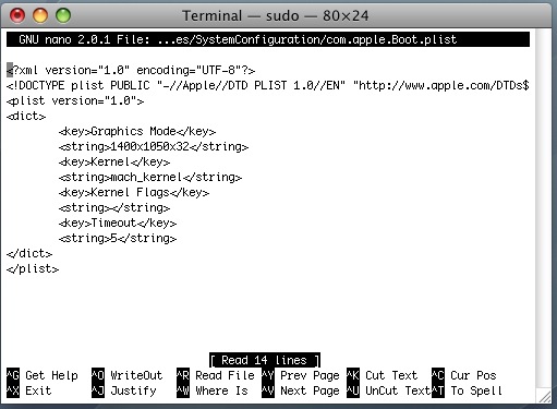

candykane Posted October 7, 2008 Share Posted October 7, 2008 if you want higer res you might nead a other driver or you will have to set it in the startup file To set your maximum screen resolution (this is entirely dependant on what screen you have): WXGA supports a maximum of 1280x800 SXGA+ supports a maximum of 1400x1050 WXGA+ supports a maximum of 1440x900 you have to go to terminaland type in exactly sudo nano /Library/Preferences/SystemConfiguration/com.apple.Boot.plist Add this new section and change the screen resolution according to the panel type: <key>Graphics Mode</key> <string>1400x1050x32</string> Now when you restart your system, the resolution automatically set. You can also manually set the refresh rate to 60 Hz: 1400x1050x32@60 but this isn't recommended because it can cause a garbled display or hang the boot process. Unfortunately you will not be able to set a higher resolution than 1400x1050 Link to comment Share on other sites More sharing options...
peligraso Posted October 7, 2008 Author Share Posted October 7, 2008 So many thanks that you helping me but I couldn't get it work. I done everything you said but i still able to view my laptop max.1024x768 or did i typed to a wrong paragraph? see the attached pic below: Link to comment Share on other sites More sharing options...

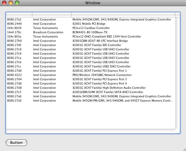

BlackCH Posted October 23, 2008 Share Posted October 23, 2008 sounddownload http://psykopat.free.fr/apple/AppleHDA/ADI/AD1981.txt then get taruga adh patcher. drak the txt file to the patcher and sound sould work again taruga patcher does not work with that codec for your audio see the link on my signature (speaker out only). for the rest you can download and run DPCImanager, then post the output here Link to comment Share on other sites More sharing options...
peligraso Posted October 30, 2008 Author Share Posted October 30, 2008 Hey back, I found AppleAzaliaFixAD1981 installer from the link that you gave me that ovof used. But is there any way to use speaker jack and mic jack of my laptop? Cuz I want to skype and here is my DPCIManager results Link to comment Share on other sites More sharing options...
