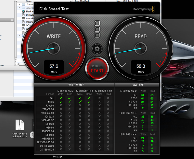

comankha Posted January 2, 2012 Share Posted January 2, 2012 disk issue was solved a bit by installing new, faster harddrive. now I get around 60mb/s in continous uncached read, unfortunately scores in random read test are way below 2mb/s? it still lowers overall xbench result. similar results anyone? 1 Link to comment https://www.insanelymac.com/forum/topic/128666-the-nx9420-thread/#findComment-1782776 Share on other sites More sharing options...
isidoro Posted January 14, 2012 Share Posted January 14, 2012 comankha, Your slow disk performance resembled my problem after updating to 10.6.8. Check my post above for the workaround I found. It has to do with network plugins and some other kexts, so you should use the ones I mentioned from 10.6.7 and do not install the 2011-06 security update because it overwrites the workaround. My system runs awesome, not that I really use it but it was a fun project. Let us know if you make any progress. Also, about changing the wifi card - be aware that you'll need to flash the bios with a hacked version that doesn't check the wifi card's compatibility. If not, HP won't let you boot. Link to comment https://www.insanelymac.com/forum/topic/128666-the-nx9420-thread/#findComment-1786064 Share on other sites More sharing options...
comankha Posted January 18, 2012 Share Posted January 18, 2012 Now i get around 60MB/s with 7200 seagate drive. Test was done with Blaskmagicsdesign's Disk Test, what was interesting that the very same benchmark don on my friends i5, 2009 MBP pro shown around 40... okay, with stock 5400 drive but... gotta love nx/nw series a bit more now :] It still feels a bit underpowered compared to win xp benchmark (other partition, same machine), HDTune rates the disk at average 80MB/s (peaking ovet 100MB/s @ times). i'd be glad to see your results. What concerns me the most now is lack of usb2.0 though and two inactive ports... Link to comment https://www.insanelymac.com/forum/topic/128666-the-nx9420-thread/#findComment-1787270 Share on other sites More sharing options...
