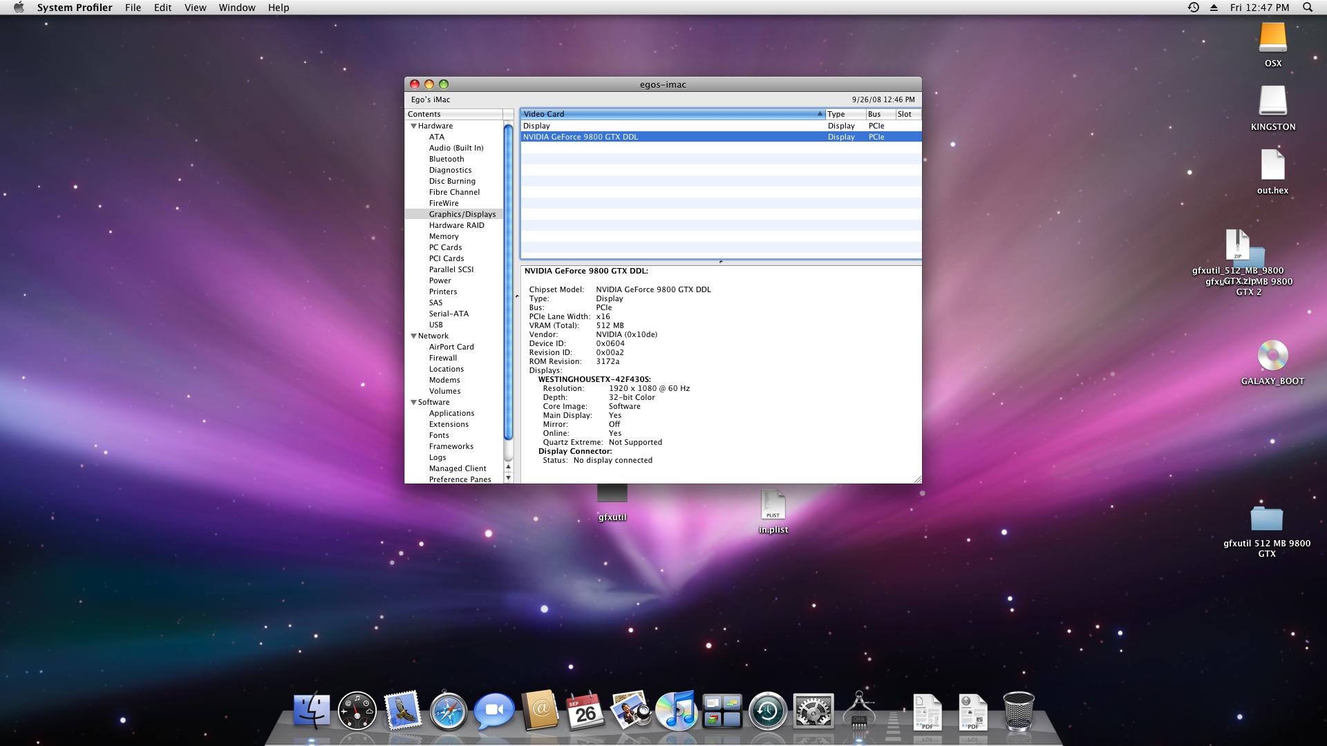

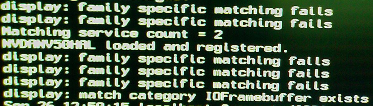

EGOvoruhk Posted September 26, 2008 Share Posted September 26, 2008 Okay, so I read all about this card's issues in the other threads, like it not working on non-SLI boards, or boards without 2 x16 PCIe slots. Well I was bored today, and my replacement card hasn't come in yet, so I decided to start messing around with it So I installed a fresh copy of 10.5.4 (Retail, via Boot-132), and then just did a combo update to 10.5.5. Then I went ahead and started using aqua-mac's GFX strings tutorial here, using his 9800GTX file. Finished that up, and rebooted it. It started to load, I got a cursor, and then it just stuck. I was left with a black screen, and a cursor. The funny thing was, that my resolution was clearly changed. It looked to be my monitor's native, which was 1920x1080. I didn't know what to do, so I just rebooted it, and this time, gave it verbose and safe mode parameters (-v -x). Wham! Came up with my login screen. Typed in my password, went to my "About This Mac", and what do I see? It seems to be picking up the second port (Which is actually the primary) on the card. Nevermind the "9800 GTX DDL" part, as I didn't edit that out of my in.plist Hooray! It looks like it's somewhat working. Now when I try to get some info on the other port, about as soon as I click on it, it locks up. I'm assuming it's because gfxutil didn't see the first port, and now Leopard doesn't know how to handle it? Is there any way to make gxutil see the port correctly, thus making a valid string? Or perhaps a way to make Leopard completely ignore that port? Edit: My attached thumbnail at the bottom is just what I get showing up when I boot with -v -x Link to comment https://www.insanelymac.com/forum/topic/128219-9800gx2-partially-working-via-gfx-strings/ Share on other sites More sharing options...

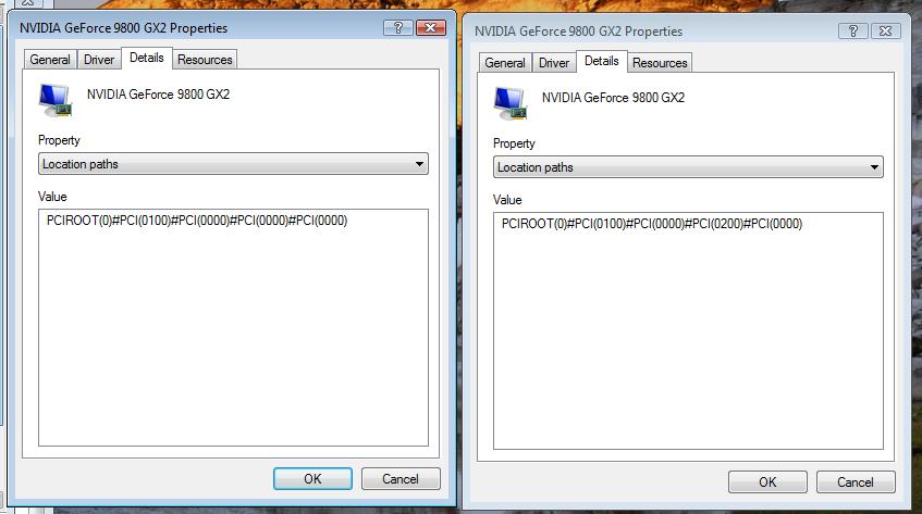

alexlyc Posted September 27, 2008 Share Posted September 27, 2008 You need to go to vista's device manager to find the correct pci root address for each ports, there should be two of them. GFXutil can't display the correct one no matter which port you use. You must grab them from vista. Link to comment https://www.insanelymac.com/forum/topic/128219-9800gx2-partially-working-via-gfx-strings/#findComment-907886 Share on other sites More sharing options...
EGOvoruhk Posted September 30, 2008 Author Share Posted September 30, 2008 This is what I found in Vista: And this is what I ended up with: PciRoot(0x1)/Pci(0x1,0x0)/Pci(0x0,0x0)/Pci(0x0,0x0)/Pci(0x0,0x0) PciRoot(0x1)/Pci(0x1,0x0)/Pci(0x0,0x0)/Pci(0x2,0x0)/Pci(0x0,0x0) Does the first one seem right? I know the second one is, because it's the one that was working before Anyway, I tried it out using aqua-mac's dual card method (here), and it wouldn't work. I could still boot, but not the 1920x1080 safe mode I could do before. I'm wondering if maybe the first address is wrong? Any help is appreciated. Thanks in advance. I suppose until then I'm just going to run around blind, going through as many different ideas as I can. I'm wondering if incorporating some of Azamic's modified kexts might help... Link to comment https://www.insanelymac.com/forum/topic/128219-9800gx2-partially-working-via-gfx-strings/#findComment-911626 Share on other sites More sharing options...
