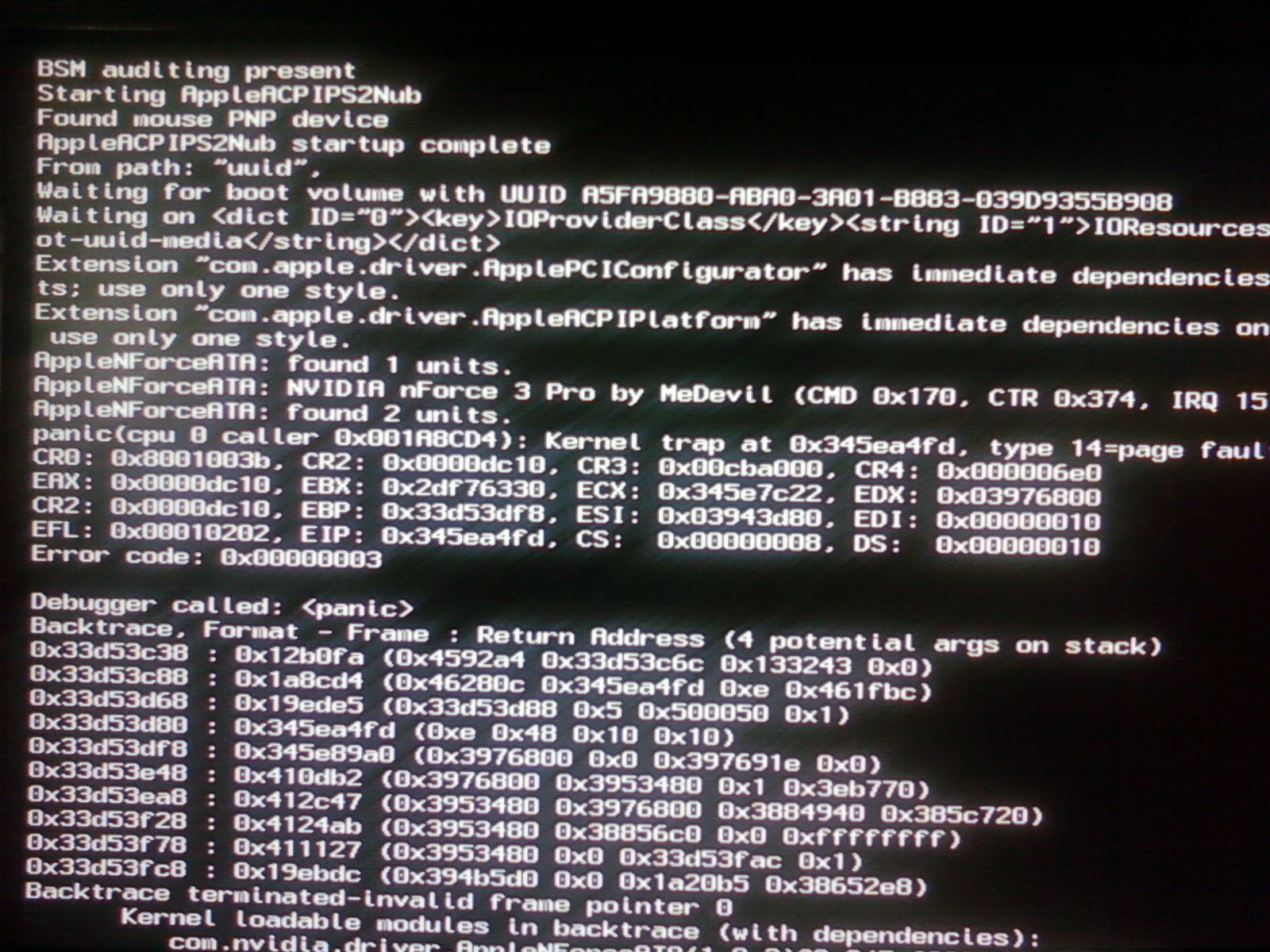

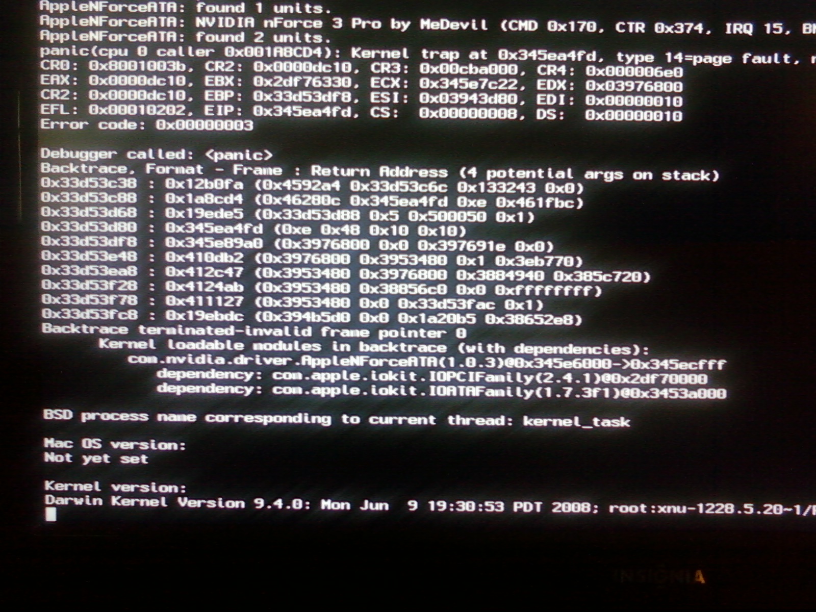

BurtonJEB Posted September 26, 2008 Author Share Posted September 26, 2008 Here is what I came up with using -v. . . I'm so lost hope these pics came through Link to comment Share on other sites More sharing options...
MGJulius Posted September 26, 2008 Share Posted September 26, 2008 Yeah...the kernel panic is coming from the nForce driver. Try the nForce test and see if the same thing happens Link to comment Share on other sites More sharing options...
MGJulius Posted September 26, 2008 Share Posted September 26, 2008 Heres the attached kext and guide (Containts Right Code) Ok i've attached the AppleNForceATA kext from the iDeneb dvd on the thread. Heres how you're gonna install it 1) Unzip the kext and put it on the root of a flash drive 2) Boot your comp from the dvd and install as normal (Do not select any of the nForce chipset packages) 3) After installation reboot you comp but you need to boot back into the installer dvd 4) Open up the terminal (Utilites>Terminal) Note: To make things easier I will be referring "OSX86" to the drive that has leopard on it and "USB" to the flash drive 5) Type in these commands: rm -rf /Volumes/OSX86/System/Library/Extensions/AppleNForceATA.kext Note: This is a precautionary measure. There shouldn't be that kext in the extensions folder but if it was we just deleted it cp -R /Volumes/USB/AppleNForceATA.kext /Volumes/OSX86/System/Library/Extensions/AppleNForceATA.kext Now that we just copied the kext from the USB drive to the HDD, lets repair the permissions sudo chown -R root:wheel /Volumes/OSX86/System/Library/Extensions sudo chmod -R 755 /Volumes/OSX86/System/Library/Extensions Exit terminal, reboot with "-f -v" at the F8 prompt (From the HDD this time), cross your fingers and GOOD LUCK!!!!!!! AppleNForceATA.kext.zip KextInstall.txt Link to comment Share on other sites More sharing options...
