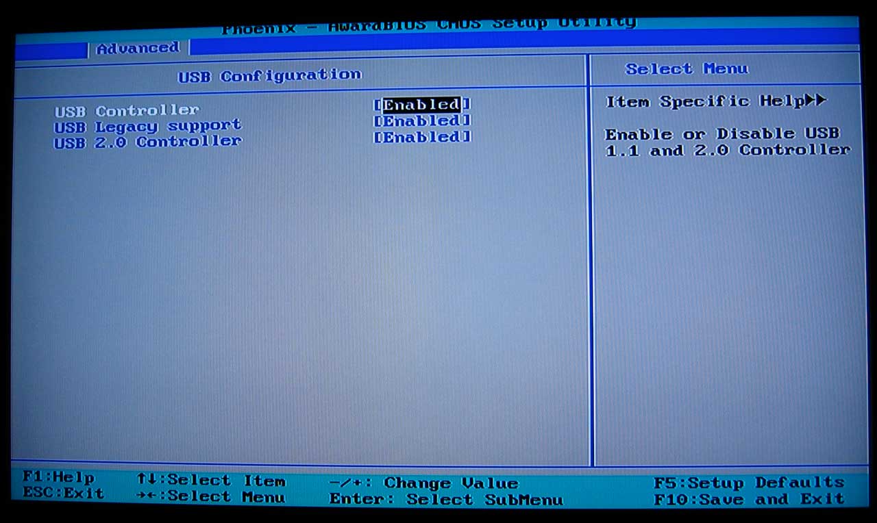

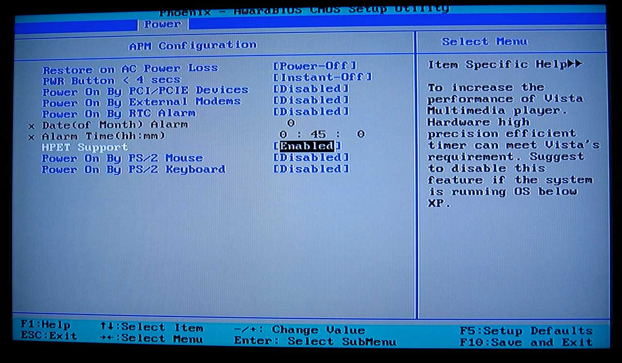

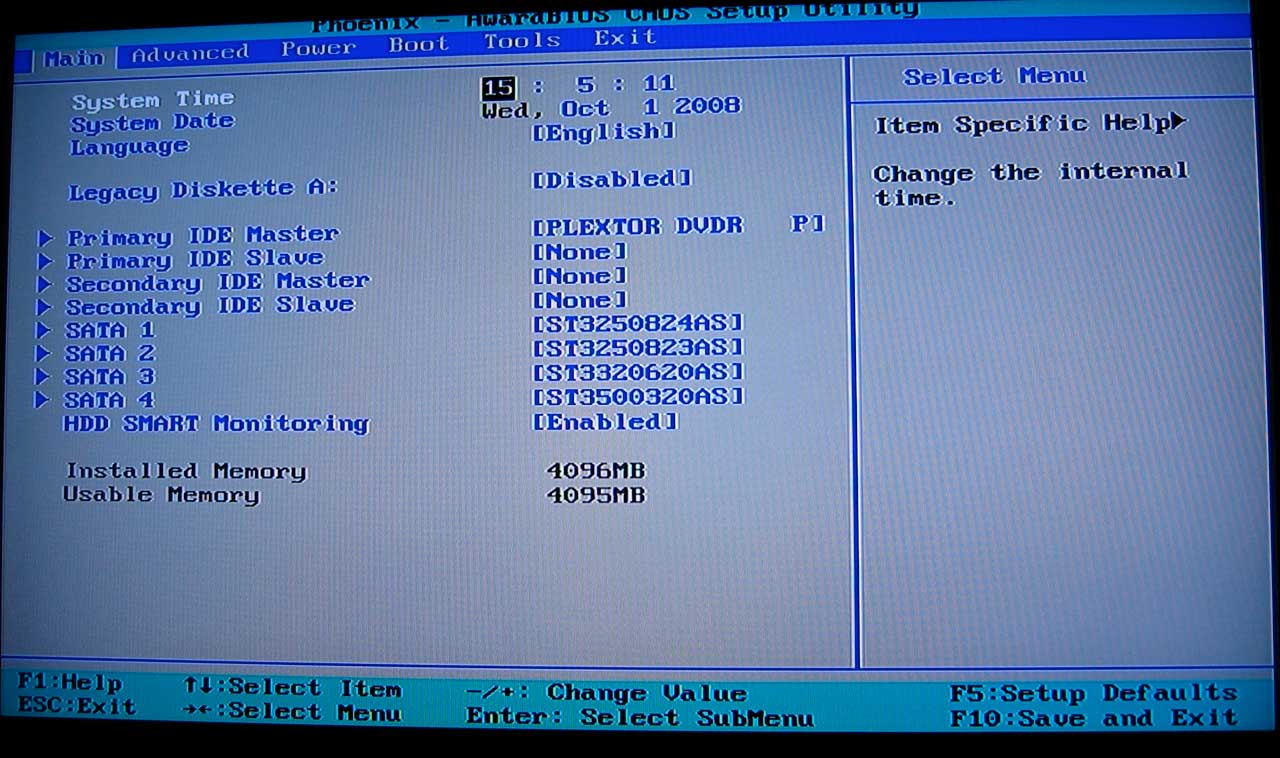

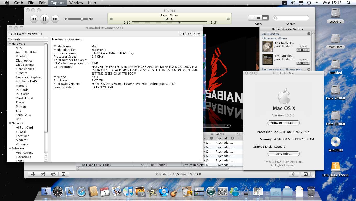

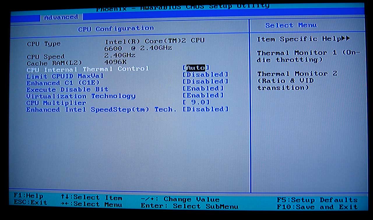

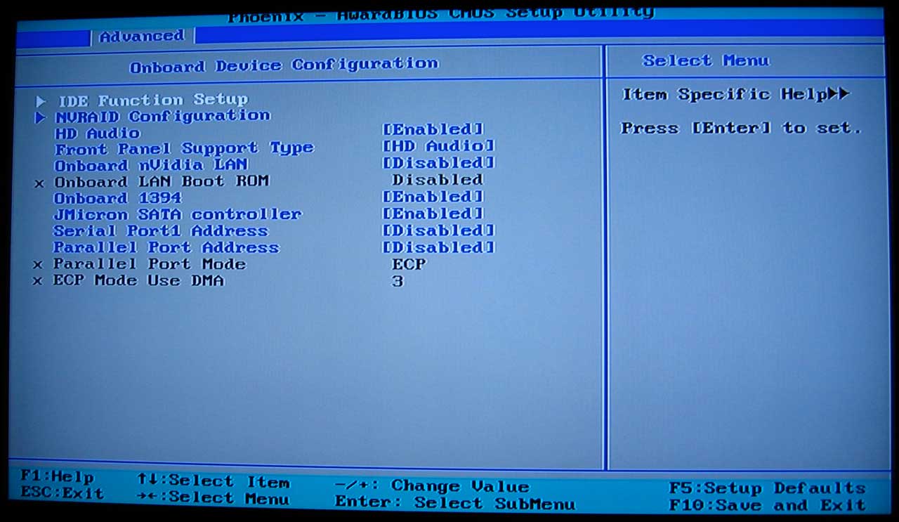

KwyjiboNL77 Posted October 1, 2008 Share Posted October 1, 2008 Like I said, I am running the ASUS 1201 BIOS, have attached screens for settings (they may be out-of-order, but I think the important stuff is in there). I have a fairly stable system but have (reproducible) crashes on the following issues: Importing a very large amount of photos into iPhoto (tried 11000, but would crash somewhere halfway, contributing this to new nForceATA drivers), when I tried to install the Extra Instruments and loops for Garage Band through Software Update it would crash when finished downloading (after reading several forums it seems a more common problem even on real macs, the update seems troublesome), instead installed it off the DVD and works fine (something I should have done in the first place!), and Burning ISO's in Toast is problematic (again seems to be nForceATA related). Haven't tried VMWARE, so cannot comment on that, but everything else I'm running runs fine. I am running iDeneb 10.5.5, with 9.4 modbin Kernel (Vanilla won't work), and the standard SMBIOS for that release (Which is Netkas if I'm not mistaken). I'm quite new to this so if you need more specifics, tell me where to look. Link to comment https://www.insanelymac.com/forum/topic/127387-modbin-94-core-2-duo/#findComment-913188 Share on other sites More sharing options...
