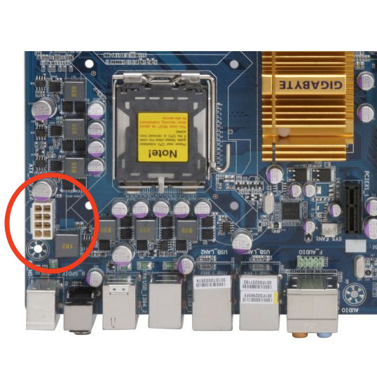

MaaseyRacer Posted September 21, 2008 Share Posted September 21, 2008 One last thing. Will that power supply work with the board? The processor requires 2x 4pin connectors. I have not seen may power supplies under 700W have that. Link to comment Share on other sites More sharing options...
hamidp Posted September 22, 2008 Author Share Posted September 22, 2008 One last thing. Will that power supply work with the board? The processor requires 2x 4pin connectors. I have not seen may power supplies under 700W have that. I can't find any information that says that it requires 2 of those... Link to comment Share on other sites More sharing options...
MaaseyRacer Posted September 22, 2008 Share Posted September 22, 2008 Link to comment Share on other sites More sharing options...
dailyKaos Posted September 22, 2008 Share Posted September 22, 2008 Some motherboards have a plastic bar that goes over four of the pins (atleast my P35 Neo2-FR does). I'm really interested in how this turns out as I'm looking at about the same except Q9300 and 8Gb of that same RAM. Link to comment Share on other sites More sharing options...
hamidp Posted September 22, 2008 Author Share Posted September 22, 2008 Touche. I cancelled the order and placed a new one with a PSU that has a 8-pin connector because I didn't want to risk it, ALTHOUGH apparently it can also work with just a single 4-pin. Thanks! Link to comment Share on other sites More sharing options...
