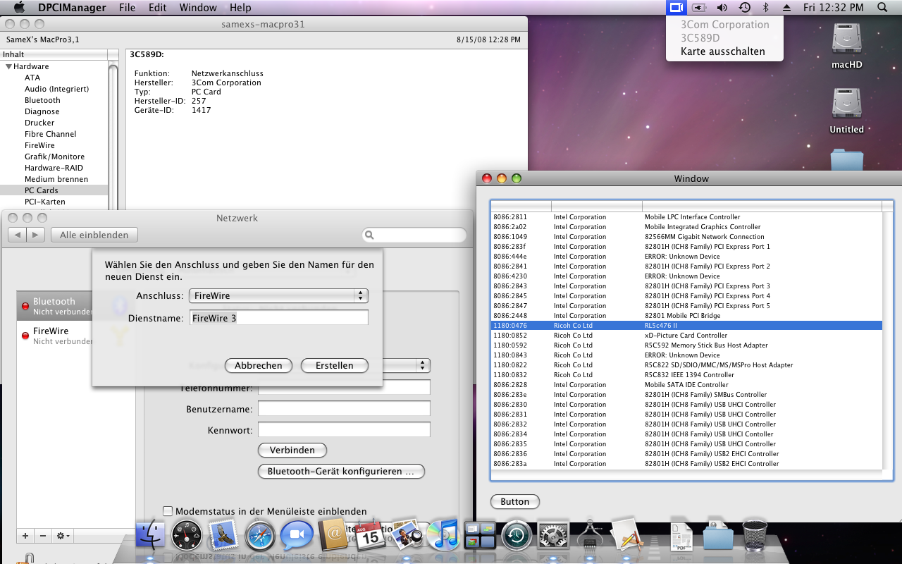

samex Posted August 15, 2008 Share Posted August 15, 2008 Hey Guys, i have sucefully installed Leo4all with Kernel 9.2 Mac doesnt find my Network Cards (WLAN and LAN) I have some PCMCIA Cards (WLAN & LAN ) PCMCIA Driver running succesfully here is the List of the Card that i have 3Com Megahertz LAN 10Mbps - Model : 3CCE589EC - Mac find this Card with Full Name as PCMCIA Card on the taskline . But i have no options in the System Prefereces under "NETWORK" nothing are founded. 3Com Megahertz LAN 10Mbps - Model : 3CXE589EC - Mac find this Card with Full Name as PCMCIA Card on the taskline . But i have no options in the System Prefereces under "NETWORK" nothing are founded. 3Com EtherLink II 10Base-T - Model : 3C589D-COMBO - Mac find this Card with Full Name as PCMCIA Card on the taskline . But i have no options in the System Prefereces under "NETWORK" nothing are founded. BASEline Ethernet adapter - Mac find this Card with Full Name as PCMCIA Card on the taskline . But i have no options in the System Prefereces under "NETWORK" nothing are founded. Dlink - WLAN - DWL-G650M - Mac find a Unknown Card. I think its a Atheros Chipset, i have tried the Howtos from this board but nothing doing. Nokia D211 - GPRS - WLAN CARD- Mac find this Card with Full Name as PCMCIA Card on the taskline . But i have no options in the System Prefereces under "NETWORK" nothing are founded. I think if Mac find this Cards with full Name, it must be find as Ethernet or not?? Wich Card are be running on MAC? Have I any Chance to bring any of this cards to running/working ? I hope somepeople help me here. I sit on the Notebook for 2 weeks. SameX Link to comment https://www.insanelymac.com/forum/topic/121142-wich-network-card-or-wlan-card/ Share on other sites More sharing options...

samex Posted August 15, 2008 Author Share Posted August 15, 2008 wifi is Intel 4965AG , i have found adriver from darwin- iwi4965 , but when i connect to a "unsecure" network its nothing do. The FAQ Write that i only connect to UNSECURE Networks, i found some networks but i cant connect to him. The LAN card is a Intel 82566MM but i have search and search no solution for this card. The PCMCIA cards are my last chance´s i think Here is a Screenshot : Link to comment https://www.insanelymac.com/forum/topic/121142-wich-network-card-or-wlan-card/#findComment-857366 Share on other sites More sharing options...
Guest BuildSmart Posted August 15, 2008 Share Posted August 15, 2008 wifi is Intel 4965AG , i have found adriver from darwin- iwi4965 , but when i connect to a "unsecure" network its nothing do. The FAQ Write that i only connect to UNSECURE Networks, i found some networks but i cant connect to him. The LAN card is a Intel 82566MM but i have search and search no solution for this card. The PCMCIA cards are my last chance´s i think Here is a Screenshot : Sell or through away your 4965 and your PCMCIA cards, buy a Broadcom or Atheros miniPCIe 802.11n wireless adapter to replace the 4965 and you will have wireless capability. Depending on your laptop you may have to buy a Broadcom or Atheros if the manufacturer whitelists the adapters or look for a patched BIOS to remove the whitelist. Link to comment https://www.insanelymac.com/forum/topic/121142-wich-network-card-or-wlan-card/#findComment-857428 Share on other sites More sharing options...
