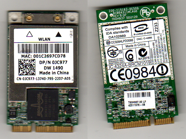

netkk Posted August 9, 2008 Author Share Posted August 9, 2008 The card is supposed to be 802.11a/b/g. It sounds like the card you have does not see the networks that are on the 5ghz band if only some are showing up or you have some AP's configured for 11n 5ghz without 11a compatibility enabled. Does this card bear the Dell name and correct part number? I got the card out of the computer and cheked, and it doesn't bear "Dell" anywhere, but there's a stick which reads "DW 1490" I scanned the card, and I attach the image. Also, I noticed that I can't connect neither with Windows or Linux... Is it possible that the card is broken? It's strange, because gets detected and finds the networks (or most of them) Maybe try deleting out your airport in the system prefs/network and then adding it back in. When i first got my broadcom, it said it wasnt configed, so i had to add it in through the network with the plus sign under your ethernet bluetooth etc... then i was able to search for networks, also try going throuhgh the advanced tab and adding it in manually I tried that already (several times, in fact) with no luck... I also tried to add my network manually but it would say "incorrect password" if the correct password was sent, and "connection timeout" if an incorrect one was sent. Btw, I can see the networks, but I can't connect. Any help would be appreciated. Thank you both so much!! Link to comment https://www.insanelymac.com/forum/topic/120144-dell-truemobile-1490-bcm4311-leopard-1054/#findComment-850520 Share on other sites More sharing options...
Guest BuildSmart Posted August 9, 2008 Share Posted August 9, 2008 I got the card out of the computer and cheked, and it doesn't bear "Dell" anywhere, but there's a stick which reads "DW 1490" I scanned the card, and I attach the image. Also, I noticed that I can't connect neither with Windows or Linux... Is it possible that the card is broken? It's strange, because gets detected and finds the networks (or most of them) I tried that already (several times, in fact) with no luck... I also tried to add my network manually but it would say "incorrect password" if the correct password was sent, and "connection timeout" if an incorrect one was sent. Btw, I can see the networks, but I can't connect. Any help would be appreciated. Thank you both so much!! It does bare the valid Dell part number and model number. You bought this card new so something isn't right with this card if it's being reported as a real apple device when it's a Dell device so let's examine the card and see if we can figure out what's happening there before we go any further. First, find and install the PCIUtils v3.0.0 (found in XLabs). Post the section of output related to the card from the following command: lspci -vvnn Link to comment https://www.insanelymac.com/forum/topic/120144-dell-truemobile-1490-bcm4311-leopard-1054/#findComment-850584 Share on other sites More sharing options...
netkk Posted August 10, 2008 Author Share Posted August 10, 2008 Post the section of output related to the card from the following command:lspci -vvnn Ok, thank you very much. I installed PCIUtils v3, and the relevant section of "lspci -vvnn" output is: 0b:00.0 Network controller [0280]: Broadcom Corporation BCM4312 802.11a/b/g [14e4:4312] (rev 01) Subsystem: Dell Device [1028:0007] Control: I/O- Mem+ BusMaster+ SpecCycle- MemWINV- VGASnoop- ParErr- Stepping- SERR- FastB2B- DisINTx+ Status: Cap+ 66MHz- UDF- FastB2B- ParErr- DEVSEL=fast >TAbort- <TAbort- <MAbort- >SERR- <PERR- INTx- Latency: 0, Cache Line Size: 64 bytes Interrupt: pin A routed to IRQ 16 Region 0: Memory at ecffc000 (32-bit, non-prefetchable) Capabilities: [40] Power Management version 2 Flags: PMEClk- DSI- D1+ D2+ AuxCurrent=375mA PME(D0-,D1-,D2-,D3hot-,D3cold-) Status: D0 PME-Enable- DSel=0 DScale=2 PME- Capabilities: [58] Message Signalled Interrupts: Mask- 64bit- Queue=0/0 Enable+ Address: fee00000 Data: 4094 Capabilities: [d0] Express (v1) Legacy Endpoint, MSI 00 DevCap: MaxPayload 128 bytes, PhantFunc 0, Latency L0s <4us, L1 unlimited ExtTag+ AttnBtn- AttnInd- PwrInd- RBE- FLReset- DevCtl: Report errors: Correctable- Non-Fatal- Fatal- Unsupported- RlxdOrd- ExtTag- PhantFunc- AuxPwr- NoSnoop- MaxPayload 128 bytes, MaxReadReq 128 bytes DevSta: CorrErr- UncorrErr- FatalErr- UnsuppReq- AuxPwr- TransPend- LnkCap: Port #0, Speed 2.5GT/s, Width x1, ASPM L0s, Latency L0 <4us, L1 <64us ClockPM- Suprise- LLActRep- BwNot- LnkCtl: ASPM L0s Enabled; RCB 64 bytes Disabled- Retrain- CommClk+ ExtSynch- ClockPM- AutWidDis- BWInt- AutBWInt- LnkSta: Speed 2.5GT/s, Width x1, TrErr- Train- SlotClk+ DLActive- BWMgmt- ABWMgmt- Capabilities: [100] #14e4 I include as an attachment the whole "lspci -vvnn" output, in case it might help. One thing I noticed is that the chip on the card reads 4311, and here lspci reports 4312... I don't know if that's important. Thank you so much again!!!! lspci.txt Link to comment https://www.insanelymac.com/forum/topic/120144-dell-truemobile-1490-bcm4311-leopard-1054/#findComment-851344 Share on other sites More sharing options...
