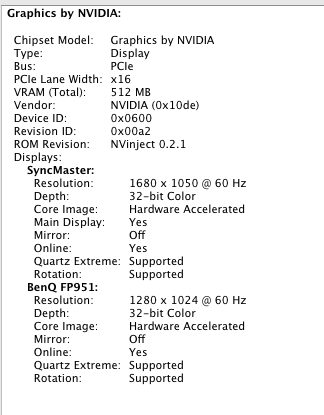

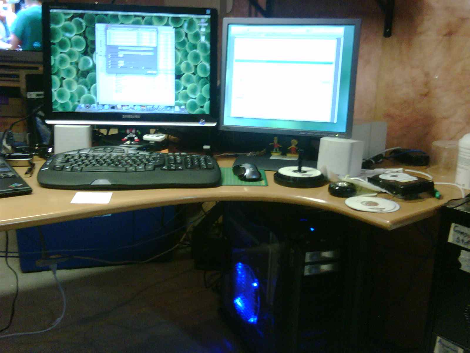

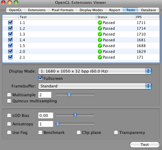

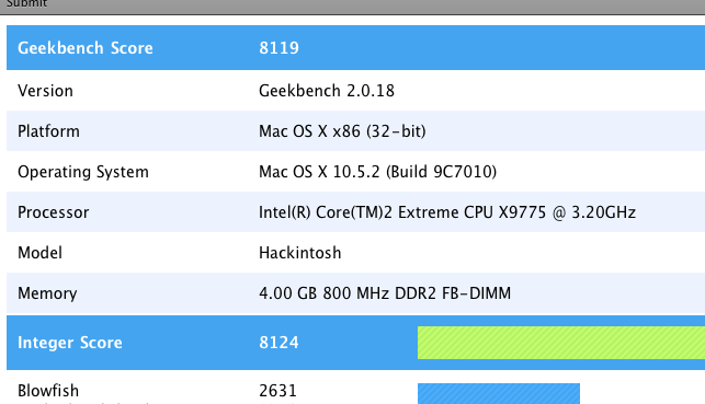

Mckitrick Posted July 25, 2008 Share Posted July 25, 2008 Hi Gang! Thanks to realityiswhere we managed to get a Skulltrail working great with Kalyway 10.5.2 It's an Intel D5400XS Mobo with two 9775 CPU's - NO Overclocking There are two pieces of 2G FBRAM which I had to MacGyver the heatsinks since I bought them for a MacPro not realizing just how big the darned heatsinks were. The RAM manufacturer (Techworks) was very friendly via email and they tried to be helpful but apparently the slim heatsinks would have to be ordered from Japan. I just took out the dremel tool and went to town (I'm either brave or dumb). I didn't need a working leopard install to get it going It's a vanilla kernel on nforce The original ATI X1950 Pro caused misery at first trying cpus=1 -x -v didn't do much so I replaced it with a Galaxy 8800GTS Here's some fun pics! Link to comment Share on other sites More sharing options...
