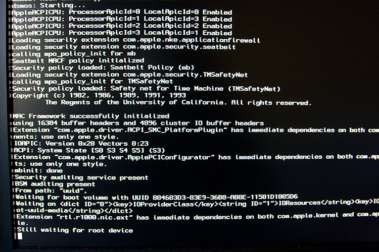

A bit more info... immediately before I get the "Still waiting for root device" I get this message: "Extension "rtl.r1000.nic.ext" has immediate dependencies on both com.apple.kernal and com.apple.kpi components; use only one style.".... could this have anything to do with it?
To see an image of what the install does (and where it stops), see the attached image.
The screen shot you link to is not available. Attach the screenshot to your post not a link which does not work.
Anyway 2 things from what can be deciphered in your post
1. First remove 2GB RAM for the install, you can install later after you have it running successfully (JMicron issue)
2. Your CPU is 45nm which may have issues with the default kernel and PC-EFIv8 in Kalyway 10.5.2. You can get rid of the PC-EFIv8 problem by patching the iso with Zef's Chameleon PPF Patch. As for the kernel, try others on the disc such as netkas or modbin. I am not sure of Kalyway 10.5.2, but Leo4allv3 does come with multiple kernels to avoid this problem.

Sorry about the image - I have uploaded it now. Can you see anything obvious in there?
I will try removing 2GB of the RAM as you recommend and if that makes no difference I'll experiment with the Leo4allV3's various kernals... although I should try the Chameleon PPF Patch first of all I guess.
The screen shot mostly points to the SATA Controller. I think your motherboard is based on ICH10 and you may need SATA set to AHCI. Vista should have no issues with AHCI as it is supported natively (unlike XP)
Other option is to get Leo4allv3 which has a modified AppleIntelPIIXATA.kext which supports ICHx chipsets in IDE mode
