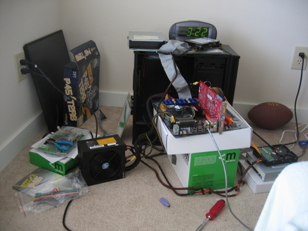

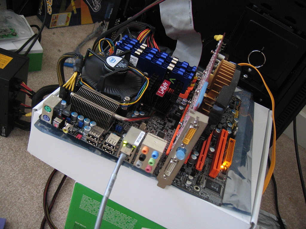

bing Posted November 29, 2008 Share Posted November 29, 2008 lol, OCing in OSX is limited. Guess I shoulda figured that. I got a bit further. Coincidentally enough I started by going to non-OC settings of 9*333. AHCI=ON JMicron=ON Used an IDE DVD drive and IDE disk. Had a couple EBIOS errors but it kept chuggin' along (literally, I thought my poor old DVD drive was going to let go the magic smoke it was just grinding away for what seemed like forever.) Anyway, got all the way to where I presume the install switched to GUI and the screen went funky blue/purple speckles. Couldn't see any mouse movement, nothing. Fun stuff. I suppose it's because I have a HD3850 installed. The only other video card I have is a really old TI4200-AGP. Maybe I should get a 7300GS, or ? Link to comment Share on other sites More sharing options...

bing Posted November 29, 2008 Share Posted November 29, 2008 Used the -x switch, got a GUI. But alas, no mouse/keyb. Just about gave up on it for the night, as I have only the wireless Logitech mouse/keyb combo I was using, so I was stuck... I was using a ps/2<>usb adapter for the keyb, the mouse is ps/2 only. I pulled the keyb cord, and replaced it using the usb plug. Voila! Both keyb AND mouse work! lol... Onward! Link to comment Share on other sites More sharing options...

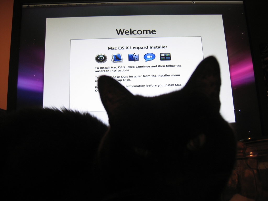

bing Posted November 30, 2008 Share Posted November 30, 2008 Progress... Thanks to thenameisgabe for the PM help........ I tried to install 3 or 4 times from a DVD made with ImgBurn, kept dying with an error: Install Failed "contents of the 'AdditionalSpeechVoices' package." googling around it seems a somewhat common problem, with no real solution but guesses ranging from simply re-burning new media to bad RAM. I went down the hardware road for awhile, unfortunately, booting w/ a single stick of old slow RAM, etc. Finally, today, I re-burned the image using PowerISO and the subsequent install went fine. I am stuck tho. Booting the new install via DFE to follow munky's boot-from-efi-partition guide, I can't get a desktop, just garbled screen. Tried the -x & -f boot flags, same problem. So frustrating. Any clues appreciated. Link to comment Share on other sites More sharing options...

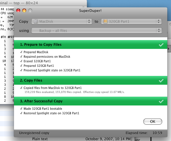

thenameisgabe Posted December 1, 2008 Share Posted December 1, 2008 The only program I know that can clone is diskutility and some mac clone programs. The way you can do this (you need large drives to store images). Make an image of your IDE drive, then restore it to the SATA drive. Of course, you need like 3 drives to do this, or an external USB. Keep in mind tha tyou need to have the buffer drive formatted as HFS+, because mac can't write to NTFS and fat32 has a filesize limit. You can do all this from diskutility on the install CD. Safe mode and single user are two different things. Safe mode is like windows safe mode, just loads standard system kexts. Single user mode runs the system as root, with only a terminal and nothing else. Everything must be done manually. I don't know why your system won't boot CD with AHCI on, considering that there are people here with SATA DVD who have done that (Hyper X being one I think). I personally have a IDE DVD drive, which works fine. I would just reinstall to the SATA drive, cloning will render munky's method useless, because you will not take the EFI partition along for the ride, since it stays hidden in Disk Utility. Good luck. Link to comment Share on other sites More sharing options...
bing Posted December 1, 2008 Share Posted December 1, 2008 The only program I know that can clone is diskutility and some mac clone programs.... Link to comment Share on other sites More sharing options...
thenameisgabe Posted December 1, 2008 Share Posted December 1, 2008 haha, nice. Just make sure you carried the EFI partition along, or else munky's method will be useless. You can use the terminal to check if its there, its the first part of munky's tutorial. Link to comment Share on other sites More sharing options...

bing Posted December 3, 2008 Share Posted December 3, 2008 I installed the 10.5.2 ComboUpdate from 10.5.0.... SuperDuper! does not copy the EFI partition. Neither does Carbon Copy Cloner, despite reports to the contrary. I've done two recent clones using CCC, and each required multiple reboots due to system crashing during the copy operation. Not sure if the system as a whole is unstable, or if it's limited to CCC itself. I will try SuperD again, next clone. I've been rebooting so often that if it's a problem with general stability, I wouldn't have noticed. But I will soon enough as I'll be running it full-time. I am using the EFI partition to boot, did all the steps manually on the fresh disk prior to reboot after the cloning, at least I copied the kexts from the known-good stale disk to the fresh one, that saved a bit of time. I will have to script this if a complete clone solution isn't found. I read Ghost works w/ HFS+ partitions, but I just dropped coin to upgrade Acronis, and I'm not a fan of Norton products anyway. I have the history of commands for this procedure, if anyone wants it, PM me. The kexts I used are as follows: ACPIPS2Nub.kext dsmos.kext IntelCPUPMDisabler.kext SMBIOSEnabler.kext LegacyIOAHCIBlockStorage.kext LegacyAppleAHCIPort.kext SMBIOSResolver.kext I think (4) are from the GRUB-DFE ISO, (2) are from the AHCI link Gabe provided, and the last one I needed to solve a "_CFGetHostUUIDString: unable to determine UUID for host. Error: 35" error condition. Graphics are up, miraculously. Chipset Model: ATI Radeon HD 3800 Type: Display Bus: PCIe PCIe Lane Width: x8 VRAM (Total): 512 MB Vendor: ATI (0x1002) Device ID: 0x9505 Revision ID: 0x0000 ROM Revision: 113-B1480A-236 EFI Driver Version: 01.00.236 Displays: SyncMaster: Resolution: 1920 x 1200 @ 60 Hz Depth: 32-bit Color Core Image: Hardware Accelerated Main Display: Yes Mirror: Off Online: Yes Quartz Extreme: Supported Rotation: Supported Display Connector: Status: No display connected I used a combo approach. The following tutorial (the 10.5.2 path...) got me 90% of the way. GFX-EFI Tutorial for NVIDIA GeForce 8800GT 512MB (G92), A complete guide with support files At step 6 I got stuck for a bit. I didn't read ahead carefully and after installing the Leopard Graphics Update, I rebooted, only to met by the dreaded disco screen. I rebooted using '-x', and installed lastExile's Updated ATI Radeon HD 3850 -- Device ID:9505 package from here: ATI Radeon HD pkg installers 10.5.x (Current 10.5.5) Rebooted with '-s' and completed the last of step 6 with the following: rm -rf /System/Library/Extensions.mkext rm -rf /System/Library/Extensions/Caches/ rm -rf /System/Library/Caches/ Rebooted again, this time with '-f', and found a beautiful 1920x1200 desktop. Quite nice after being stuck at 1024x768 for so long. I didn't like using the Installer, I'd rather to have manually copied the kexts and such. I'd like to understand that part of it better. What else does the installer do? Not knowing bugs me. But oh well. I'll probably reinstall to a different disk from scratch just to make sure I've got the whole process down, and I can go into that further at that time. It never takes nearly as much time the second time around. Some random thoughts. Apple still doesn't include a focus-follows-mouse option?! W.T.Fook? Tried MondoMouse, didn't like it. Using Zooom now, it's still a broken implementation as far as I can tell, but it's better than nothing. http://steve-yegge.blogspot.com/2008/04/se...use-debate.html It's nice to be running an OS with b a s h as an integral feature again. I use to use Linux quite a bit, so it's coming back slowly... I like all the control available for each piece of the GUI, fonts specifically. That said, a lot seems hidden by the GUI, and that bugs me. For example, and I know this is probably simple, but, how do I see the whole system disk file structure from down at the root level in Finder, instead of just Apps/Lib/Sys/Users? Anyway, I guess that's what bash is for. I like the Console app, nice, instead of having to find the log I want in a shell and using "tail -f" or whatever. Firefox runs OK, not as well as under 'doze though, and my favorite add-on -MouseZoom- doesn't work. That's a real drag. I'll look into a gestures package of something to duplicate the functionality, I guess. Haven't been able to get VineServer to work with TightVNC on the 'doze machine. Found a little app for viewing QAM TV feeds off the HDHomeRun, need to make that work soon. I don't want to shell out for EyeTV, as I'll probably move to FIOS soon, and then the HDHR will be hitting eBay. I like installing software from a .dmg file, the process in general is so graceful compared to 'doze though I miss having a centralized app to uninstall stuff. Front Row is one sweet looking app, though I only looked at it for two minutes.... Should I tempt fate and upgrade to 10.5.5? Not right now. Link to comment Share on other sites More sharing options...
