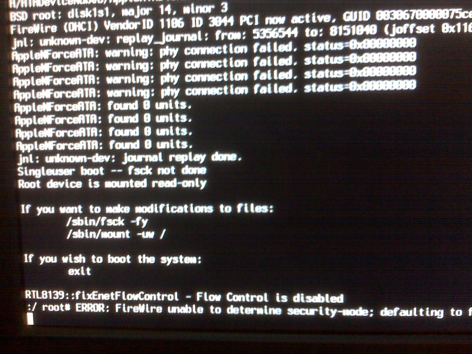

MasterBeta Posted June 11, 2008 Share Posted June 11, 2008 Okay, so. I downloaded the Kalyway 10.5.3 Combo Update. After installing the combo update, noting that the readme said not to restart, OSX promptly froze. Fifteen minutes later, it had not unfrozen, so I restarted. Now I cannot boot into OSX... as I anticipated and feared. The boot shows standard verbose processes, no kernel panics or errors, but then it suddenly will restart the computer with no warning. Is there any way to rectify this problem, or am I going to have to reinstall the system? I really hope not, I don't want to have to lose my data. Link to comment https://www.insanelymac.com/forum/topic/109943-1053-combo-update-problem/ Share on other sites More sharing options...

Whalid Posted June 11, 2008 Share Posted June 11, 2008 MasterBeta, I had a problem too. I had to manually copy one extension (that I have a backup) to te extension folder. You have to post what the problem is, so we can try to help you. First try to boot in single user mode (-s) and see if you can access your machine. If that doenst work, boot darwin with -x -v and look at WHERE your system is halting (the name of the last file that freezes your machine). Than post back here. If you can, take a picture of the screen with your cell and post, so we can check cheers Whalid Link to comment https://www.insanelymac.com/forum/topic/109943-1053-combo-update-problem/#findComment-779477 Share on other sites More sharing options...
MasterBeta Posted June 11, 2008 Author Share Posted June 11, 2008 Okay I'll try that and report back my findings..I just found out that the combo update was for Intel only so I'm not expecting much..I'm running an AMD machine and the readme didn't specify. Is there any way to rollback an update if need be? EDIT: Single-User Mode worked! (disregarding the firewire error message, I can still use unix commands and see and navigate through all my directories) What should I do now? Link to comment https://www.insanelymac.com/forum/topic/109943-1053-combo-update-problem/#findComment-779913 Share on other sites More sharing options...

Whalid Posted June 12, 2008 Share Posted June 12, 2008 It seems that the problem is the AppleNForceAta.kext. Do you use an Nforce chipset on your machine? cheers Whalid Link to comment https://www.insanelymac.com/forum/topic/109943-1053-combo-update-problem/#findComment-780652 Share on other sites More sharing options...
MasterBeta Posted June 12, 2008 Author Share Posted June 12, 2008 Yeah I do. Link to comment https://www.insanelymac.com/forum/topic/109943-1053-combo-update-problem/#findComment-781109 Share on other sites More sharing options...
Whalid Posted June 12, 2008 Share Posted June 12, 2008 You should try replacing this kext. Search for a replacement. Maybe this can help you: http://forum.insanelymac.com/index.php?showtopic=35985 Link to comment https://www.insanelymac.com/forum/topic/109943-1053-combo-update-problem/#findComment-781271 Share on other sites More sharing options...
