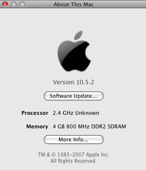

jayroh Posted June 8, 2008 Author Share Posted June 8, 2008 Hey guys! First of all, thanks for the replies. Second of all I'm happy to report that everything has worked out with GREAT success. The first issue was definitely because I had my SATA hd plugged into the wrong location. Things were plugged into the secondary SATA controller (the blue ones) instead of SATA0 and SATA1 on the black SATA controllers on the board. That was purely my fault. After reading up more and more on the board I figured out that that secondary (blue) sata controller needed to be disabled. Great - that was all set. (I don't *need* the external SATA port w/the antec case - no big deal). Second (and I'm not even sure this was an issue) I set the HD's to be AHCI instead of IDE. Third issue, after a lot of banging my head against the wall, was to make absolutely sure that I had the partition for the main system drive formatted using MBR instead of GUID. After this - things looked great. I was optimistic. Installing w/Kalyway turned out to be a simple process once I selected the nvinject driver for a 512M video card ... I have an EVGA 8800GT 512M card and it's using the full 1920x1080 resolution on my Dell 24" monitor. Looking *so* great. As an aside - the audio drivers included with the BADAXE2 guide that floats around here are working great. Lastly - the Kalyway 10.5.3 update was installed without fail and I have a 100% brand new 10.5.3 system up and running at home on all of my Newegg-provided hardware. (attached image was before the update) Link to comment https://www.insanelymac.com/forum/topic/109197-trouble-installing-kalyway-on-new-badaxe2-d975xbx2/#findComment-776061 Share on other sites More sharing options...
