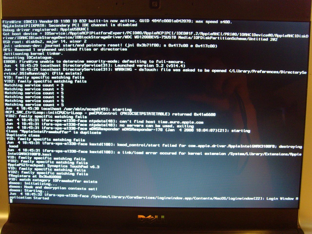

Ifor Williams Posted June 4, 2008 Share Posted June 4, 2008 hi, i was wondering if anyone could shed some light on this, i've been trying for the past few days to install 10.5.2 on my m1330 but just can't get it to work, its driving me crazy!! ive been using iaktos v2.0 to install, and i can boot using -x after it says it encountered an error and pauses for 5 seconds. i booted using -v and it hangs after saying the login window app started. im dual booting with vista, but the dual boot works fine, any ideas!? ive included a screenshot of where it stalls... Link to comment https://www.insanelymac.com/forum/topic/108723-m1330-tried-everything-wont-boot-normally/ Share on other sites More sharing options...
YzorYzor Posted June 4, 2008 Share Posted June 4, 2008 Hmm.. the stage at which it gets stuck indicates it could be a video driver problem. I had this problem for ages, I solved it by very carefully choosing only what is absolutely necessary while installing leopard. Install even without video drivers if necessary and try booting into safe mode with -s or -x; also choose only the necessary Chipset drivers. I don't know about iatkos, I was using leo4allv3 and I had this problem. After installing some 20 to 30 times with different options finally it worked. Link to comment https://www.insanelymac.com/forum/topic/108723-m1330-tried-everything-wont-boot-normally/#findComment-770974 Share on other sites More sharing options...

Ifor Williams Posted June 4, 2008 Author Share Posted June 4, 2008 just checked now, its "Mobile Intel® 965 Express Chipset Family", ill boot up iaktos again, see if that had the intel drivers built in... edit: deleted the 950 and 3100 kexts in /System/Library/Extensions and it boots up properly!! Link to comment https://www.insanelymac.com/forum/topic/108723-m1330-tried-everything-wont-boot-normally/#findComment-771031 Share on other sites More sharing options...
