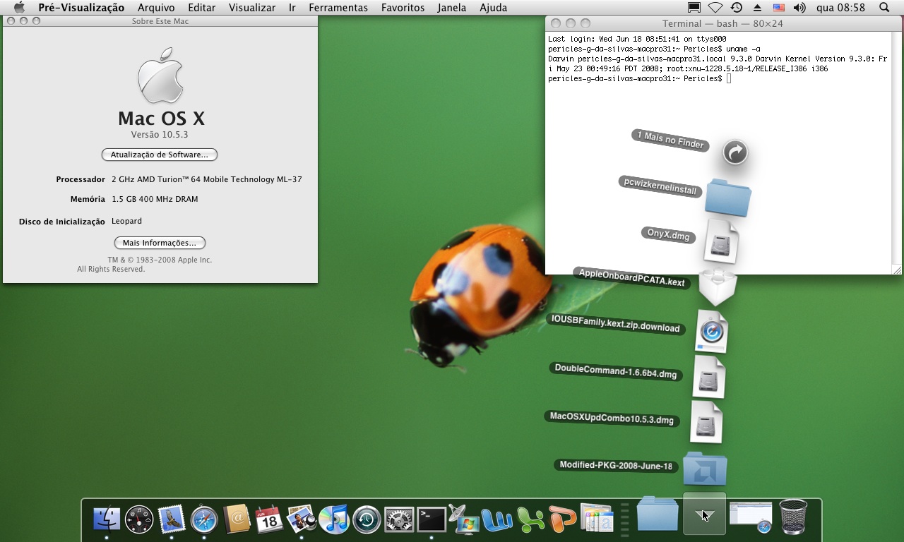

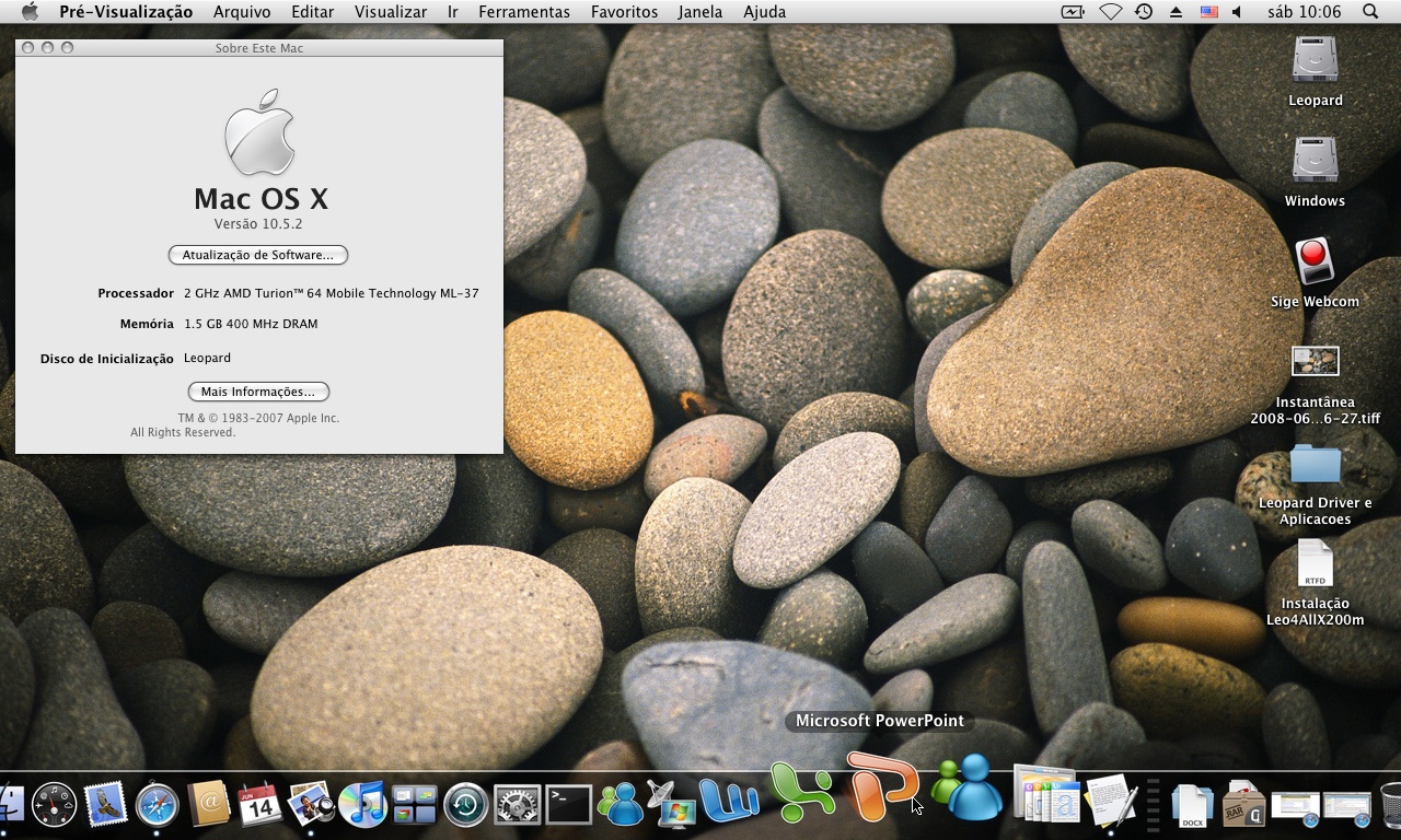

Pericles Silva Posted June 14, 2008 Share Posted June 14, 2008 SUCESS!!!!! Yes, works great!!! Here my specs and what's working!!! Machine: ACER Aspire 5040 Processor: Turion 2.0 Ghz ML-37 - Running ok in "About this Mac". Processor fan running ok (when i use the JaS 10.4.8, the fa is running full time and very hot). RAM: 1,5 Gb Ram DDR 400 - Running ok in "About this Mac". HD: 80Gb (Particioned with Windows XP -30GB and OS-X - 50Gb, dual boot, working great) Lan: Realtek 8169 - Working ok, no patch needed!!! Wireless: Atheros 5005 - Need to use the 10.4.5 Kext. After install the kext, the Wireless are detected like a Airport, but no way to activate it. The solution: Open your Safari and run Network Diagnostic. So, you can find your wireless network. Works great. No signal icon (appears no signal) in taskbar. Using this tutorial: (http://forum.insanelymac.com/index.php?showtopic=33089) Thanks Ergosteur!!! Graphics Card: X200M Ati - Working ok, after use the Calisto003b (fixed). Resolutio 1280 x 800. No QE/CI, but here comes something interesting: the Dock, minimizing windows, etc., work to slow. So i find the App Mac Pilot, and disable some features, like the 3d Dock Style, etc., and my Leopard running great! Install the Divx codec and the Pirian (to subtitles, because i'm from Brazil) and th movies, (DIVX) works great! No way to play DVD... yet! In my bios, i set the graphics memory to 256mb, and are running ok, but in System Overview, appears just 48mb... i think if some guru work in this (like Callisto, etc) can make some diference to X200M users like us... Screen Savers does not work.. just the Mac Logo and Name Computer... in the 10.4.8 works ok... in Leopard, apperas a error message: Can't load the package... well, no problem... Hergoes the link: (http://omni.110mb.com/callisto/) Power Management: When run the install DVD, i select the Normal Kernel, and my battery runs out in something like 20 minutes. Wheel, another install time and i select the Kernel Sleep... surprise: battery now, if i unplug the charger in 100%, goes up to 1:30 hours (). But, if i turn on the laptop without the charger plugued, the battery goes in 30 minutes... Maybe because this is a AMD machine... Sleep Mode: not working. If i put here in sleep mode using AC or in battery mode, the machine shutdown... no problem, but when i try to wake up, pressing the keyboard or mouse, the lap turns on, but just a black screen... i have to shut down pressing the Power button, and start again... USB: working wverything fine... no problem... Pen-drives, usb mouses, works great! Card Reader: no try yet! CDRom/DVD Drive: Works great!!! Recognize my DVD rom without problems!!!! Keyboard: Using the USInternational.bundle, i can use my keys for Brazilian Portuguese... no problem!!! APPS: I have installed and working without problems: - Microsoft Office 2008 Corporate Edition - Toast Titanium 7.0.1 - Microsoft Messenger 7 - Remote Desktop Connection - Divx Player and Codec - Logmein Codec - Firefox with Megaupload Update - Mac Pilot: the cream is this APP... after disabling 3d features on dock, the system speed up so much!!!!! Here stay the tip: disable the 3d Dock Style... evetything goes great!!!! Som my thanks to ToxiMac, for this great release, and to another guy who help me, Mark, in Marc's Blog (http://marc88.blogspot.com/2007/03/osx86-install-guide-for-x200-users.html). So, works great!!! The only things need some research are Video Drivers (QE/CI, or full memory), Sleep Mode and Battery Life... in the rest, working great!!!! Link to comment https://www.insanelymac.com/forum/topic/104657-ati-sb-200400450-targeted-install-disk-leo4x200iso/page/2/#findComment-783305 Share on other sites More sharing options...
Pericles Silva Posted June 15, 2008 Share Posted June 15, 2008 Well people.. last night, i try to update the kernel and OS X Version to 10.5.3... no luck... when start install, freeze up in 19%.. well, nothing to do, restart... after restart, the unlike KERNEL PANIC. I use the Zepyrhot APP and i think this happen because some kext (remember, i'm a X200M user) conflict with the board. Whell, i think the X200 users wait for Toxicmac (our hero) and Eddie11c (our big hero) to make some patch to x200M users... here stay my request to all the developers don't forget us!!! There is to many X200M users around here!!!! Again, thanks to all! I will put some info here about my experience with Leopard... Another thing: Video playback (Divx) works ok, using 1280x800x32, but just running in a windows mode. In full screen, there is some relay in the video... If someone know how to change the amount of memory in System Overview, i think there is some boost using all memory. I set 256mb in my bios and appears just 48mb in Graphics Memory. Thanks to all!!! Slice, Prasys... stay in touch, my friends!!! We need your help!! Toxicmac, come back, my friend!!! If someone have some question and if i could help, please, post it here!!! Let's help us!!!! Sorry about my english... brazilian portuguese native language!!!! Cheers!!! Link to comment https://www.insanelymac.com/forum/topic/104657-ati-sb-200400450-targeted-install-disk-leo4x200iso/page/2/#findComment-784999 Share on other sites More sharing options...
