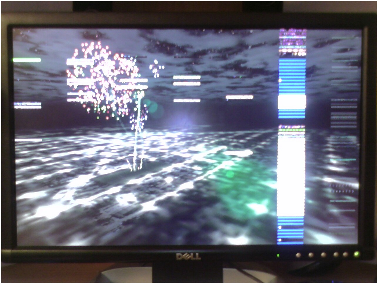

romey-rome Posted February 27, 2006 Share Posted February 27, 2006 This happens whenever there's something graphic intensive running. Screen-savers, CineBench, Quicktime. It does this & locks up... Any ideas? 10.4.4 MSI 945g NEO-F (GMA950) Intel D 920 1 gig RAM...don't think anything else is relevant. Thanks Link to comment https://www.insanelymac.com/forum/topic/10338-ugrr-crashing/ Share on other sites More sharing options...
romey-rome Posted March 1, 2006 Author Share Posted March 1, 2006 I think I'm coming to the conclusion that this is a power shortage. I have an Antec 380W PS with 3 HDs, a CD-ROM, and an external USB powered HD. The higher I set my FSB, the more frequently this crash occurs. I already put on a bigger HSF, & put the RAM through several tests... Any thoughts? Link to comment https://www.insanelymac.com/forum/topic/10338-ugrr-crashing/#findComment-66142 Share on other sites More sharing options...
EqUaTe Posted March 1, 2006 Share Posted March 1, 2006 Try removing your overclock. That's a symptom of an unstable OC, and also with power-shortages. Your PSU is probably struggling a bit, but remove your OC and you'll probably be fine. Link to comment https://www.insanelymac.com/forum/topic/10338-ugrr-crashing/#findComment-66338 Share on other sites More sharing options...
romey-rome Posted March 1, 2006 Author Share Posted March 1, 2006 I didn't have it overclocked originally. I just started to OC so see if it would affect it at all. I have a Pentium 920 running @ stock settings & it is less frequent, but still happens. Link to comment https://www.insanelymac.com/forum/topic/10338-ugrr-crashing/#findComment-66393 Share on other sites More sharing options...
