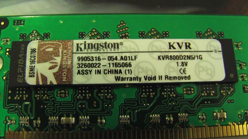

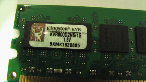

I did what you told me and took a pic of each type of memory I have. The ones I bought when building the computer, those of the bigger stick, have the same model number. The one I bought later has the smaller stick. I was told that the N5 / N6 is related to latency.

2x N5 Sticks paired. (appear as Dual Channel Interleaved)
1x N5 Stick.
1x N6 Stick.
I had 2x N5 Sticks paired and 1x N6 alone. (appear as Dual Channel Assymetric).
All of them show the same thing. Mac always recognizes them as 667MHz.
