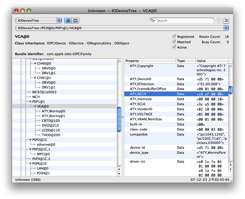

    InsanelyMac Protégé
  • Members
  • Pip
  • 33 posts
  • Gender:Male
  • Location:Ho Chi Minh - Viet Nam
  • Interests:Computer Sciene , Games , Anime & Manga
I don't have "ATIRNDRV.kext"... where can I get it?
You can extract it from your Tiger DVD by pacifist or grab it here ( mine is from 10.4.10 Kallyway )
Why you don't use pc_efi_v5 & upgrade to 10.4.11 . Im running great with 10.4.11 Vanilla kernel .

<plist version="1.0">
<dict>
	<key>CFBundleDevelopmentRegion</key>
	<string>English</string>
	<key>CFBundleExecutable</key>
	<string>ATIinject</string>
	<key>CFBundleIdentifier</key>
	<string>com.max.ATIinject</string>
	<key>CFBundleInfoDictionaryVersion</key>
	<string>6.0</string>
	<key>CFBundleName</key>
	<key>CFBundlePackageType</key>
	<string>KEXT</string>
	<key>CFBundleSignature</key>
	<string>????</string>
	<key>CFBundleVersion</key>
	<string>1.0.0d1</string>
	<key>IOKitPersonalities</key>
	<dict>
		<key>ATIinject</key>
		<dict>
			<key>IOClass</key>
			<string>com_max_ATIinject</string>
			<key>IOMatchCategory</key>
			<string>IOFramebuffer</string>
			<key>IONameMatch</key>
			<string>display</string>
			<key>IOPCIMatch</key>
			<string>0x00001002&amp;0x0000ffff</string>
			<key>IOProbeScore</key>
			<integer>20000</integer>
			<key>IOProviderClass</key>
			<string>IOPCIDevice</string>
			<key>entriesToAdd</key>
			<dict>
				<key>@0,AAPL,boot-display</key>
				<integer>1</integer>
				<key>@0,ATY,EFIDisplay</key>
				<string>LVDS</string>
				<key>@0,compatible</key>
				<string>ATY,Wormy</string>
				<key>@0,device_type</key>
				<key>@0,display-dither-support</key>
				<key>@0,display-dual-link</key>
				<integer>2</integer>
				<key>@0,display-link-component-bits</key>
				<integer>6</integer>
				<key>@0,display-type</key>
				<string>LCD</string>
				<key>@0,inverter-current</key>
				<integer>0</integer>
				<key>@0,name</key>
				<key>@1,AAPL,boot-display</key>
				<key>@1,ATY,EFIDisplay</key>
				<string>DFP1</string>
				<key>@1,compatible</key>
				<key>@1,device_type</key>
				<key>@1,display-dither-support</key>
				<key>@1,display-dual-link</key>
				<key>@1,display-link-component-bits</key>
				<key>@1,inverter-current</key>
				<key>@1,name</key>
				<key>AAPL,backlight-control</key>
				<key>AAPL00,Coherency</key>
				<key>ATY,Copyright</key>
				<string>Copyright ATI Technologies Inc. 2005</string>
				<key>ATY,DeviceID</key>
				<integer>29141</integer>
				<key>ATY,EFIVersion</key>
				<string>1.3</string>
				<key>ATY,VendorID</key>
				<integer>4098</integer>
				<key>CRT1.EDID</key>
				<data>
				AP///////wAebZ1DRQALAAUOAQNuIht46i7lpFdKnCUR

hi all
i got a good news and a bad one.
use this atiinject.kext/contents/info.plist i can work with ext-LCD with my F3JP .
ext-LCD is LG1730P using DVI-port now, in this case be MainScreen. F3JP is sencondly.
bad news is :
everytime i click the button is "detect displays" , i take a BLANKscreen everyone.
from QE/CI full-res started. it's still there.
I hope all people x1700 be continue for test with multi-screen.
thx
john
071208
