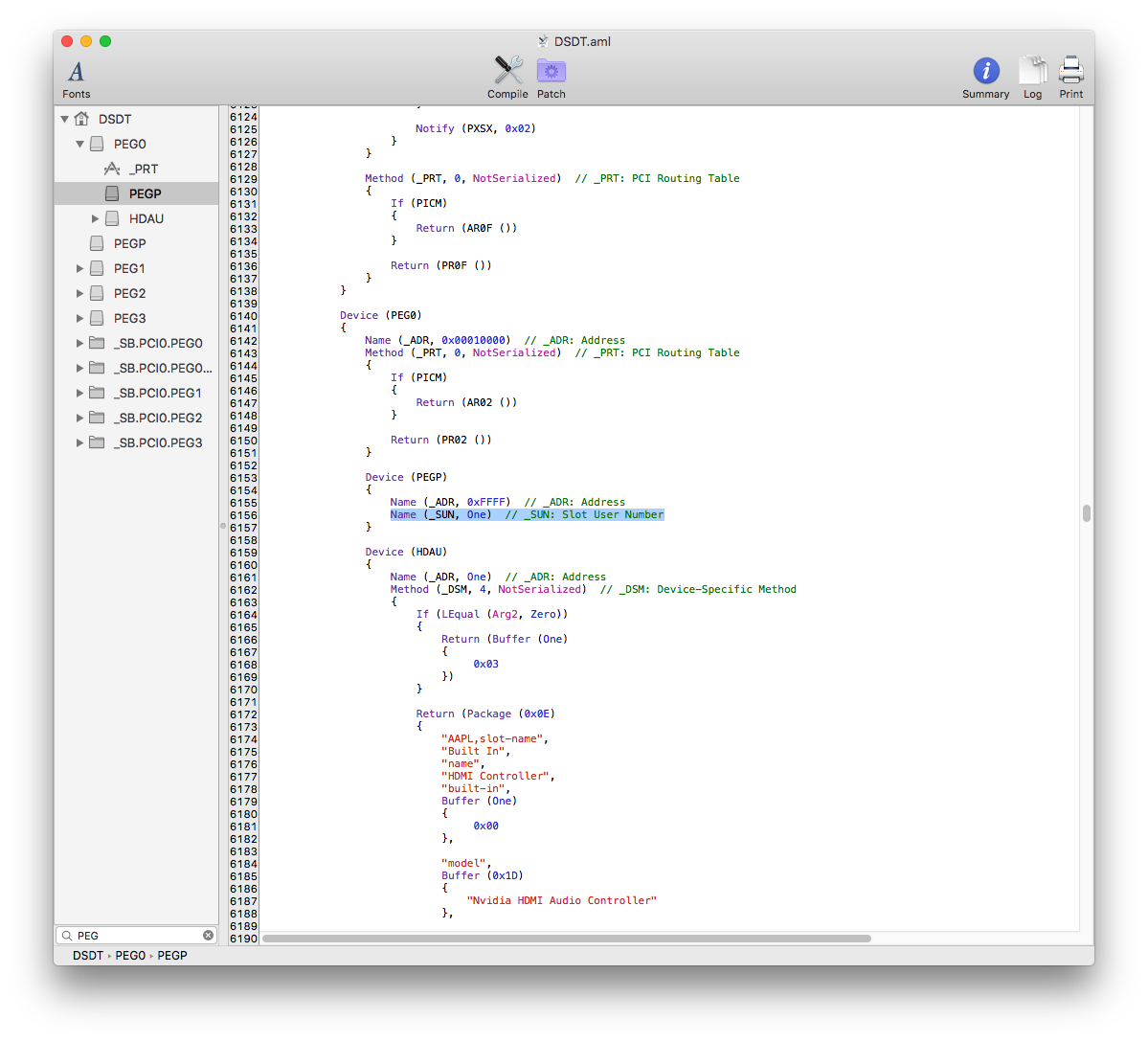

kaoskinkae Posted December 20, 2017 Author Share Posted December 20, 2017 thanks for everything almost everything understood less where it comes out Atheros 9380 Wireless Network Adapter: RP04 Audio Controller: HDEF Intel 7 Series Chipset Family SATA Controller: SATA Intel 7 Series Chipset Family USB xHCI Host Controller: XHCI Intel Corporation, 7 Series Chipset IMEI Controller: IMEI Intel Corporation, 7 Series Chipset USB Enhanced Host Controller #1: EH01 Intel Corporation, 7 Series Chipset USB Enhanced Host Controller #2: EH02 Marvell 88SE9172 SATA Controller: SATA NVIDIA GeForce GT 640: PCI Slot 0 Nvidia HDMI Audio Controller: PEG0 Qualcomm Atheros AR8151 v2.0 Gigabit Ethernet: RP07 Realtek RTL8168C/8111C PCI Express Gigabit Ethernet: RP02 VIA VL800 USB xHCI Controller: RP05 except where pci slot 0 comes from 1 Link to comment Share on other sites More sharing options...
MaLd0n Posted December 20, 2017 Share Posted December 20, 2017 except where pci slot 0 comes from remove Name (_SUN inside device and put what u need Name (_SUN, One) // _SUN: Slot User Number 1 Link to comment Share on other sites More sharing options...
kaoskinkae Posted December 20, 2017 Author Share Posted December 20, 2017 NVIDIA GeForce GT 640: PCI Slot 0 I say where it is located in the DSDT that I can not locate it.Then you can change Built In for PCI slot 4 for Airpor Extres, PCI slot 3 for RTL8182C Link to comment Share on other sites More sharing options...
MaLd0n Posted December 20, 2017 Share Posted December 20, 2017 peg0/pegp u can apply all u need, changes, etc e.g pci 3 Name (_SUN, 0x03) // _SUN: Slot User Number but take it easy with conflicts or if u prefer just use it "AAPL,slot-name", "PCI Slot 1" "AAPL,slot-name", "PCI Slot 2" etc etc Link to comment Share on other sites More sharing options...
kaoskinkae Posted December 20, 2017 Author Share Posted December 20, 2017 perfect NVIDIA GeForce GT 640: PCI Slot 0 where it is in the indicated DSDT 1 Link to comment Share on other sites More sharing options...
MaLd0n Posted December 20, 2017 Share Posted December 20, 2017 done! nice work! enjoy! 2 Link to comment Share on other sites More sharing options...
