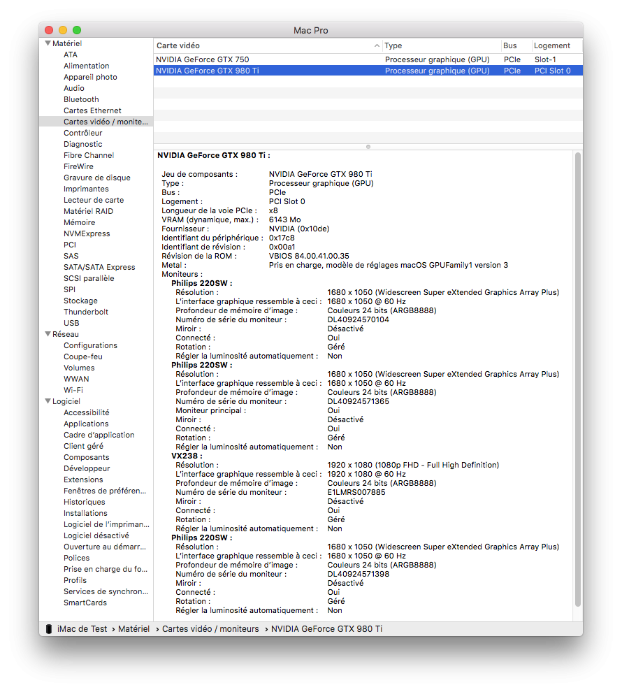

blackhole63 Posted November 26, 2018 Share Posted November 26, 2018 So, I got confirmation today from nVidia (from technical service), my GTX980Ti can only run 4 screens simultaneously. So, to operate my remaining 3 screens, I turn to my "plan B" which is to add a second graphics card, a GTX750 1GB with 4 video outputs (2xDVI, 1xHDMI, 1xVGA) and without 6-pin connection for the feeding (this is another model than the one mentioned earlier in this topic). What makes me my: - GTX980Ti on the PCIe-16x port (top port), - GTX750 on the PCIe-8x port (middle port), - Apple Broadcom BCM94360CD Wifi / BT Card on top PCIe-1x port, - Orico PME-4U PCIe USB3.0 PCIe card on the middle PCIe-1x port I also disabled the Clover patches in "Kernel & Kexts Patches" for USB and deleted the kext USBInjectAll to replace it with my USB injector. I come back to you (@MaLd0n), because: I already wish to thank you for your work!!! And because I have questions about including the addition of my second GPU. - Why, in the info "PCI" (photo attached), my 2nd graphics card (GTX750) appears in the column "slot" in "Slot-1" while my GTX980TI and my iGPU appear in "PCI Slot x" (0 and 3)? Should not it appear in "PCI Slot 1" ... ??? - What is the patch "com.apple.driver.AppleMikeyDriver" (Patch Assertions) ...? I understood that it was for audio but I do not understand what it really is. - I also want to add my 2 previously mentioned M.2 SSDs (1xNVMe and 1xSATA), will they be seen in the "PCI" section? For all this, must I give you a "Send_Me" again with "RunMe.app"? Thanks in advance! Link to comment Share on other sites More sharing options...
MaLd0n Posted November 26, 2018 Share Posted November 26, 2018 14 minutes ago, blackhole63 said: So, I got confirmation today from nVidia (from technical service), my GTX980Ti can only run 4 screens simultaneously. So, to operate my remaining 3 screens, I turn to my "plan B" which is to add a second graphics card, a GTX750 1GB with 4 video outputs (2xDVI, 1xHDMI, 1xVGA) and without 6-pin connection for the feeding (this is another model than the one mentioned earlier in this topic). What makes me my: - GTX980Ti on the PCIe-16x port (top port), - GTX750 on the PCIe-8x port (middle port), - Apple Broadcom BCM94360CD Wifi / BT Card on top PCIe-1x port, - Orico PME-4U PCIe USB3.0 PCIe card on the middle PCIe-1x port I also disabled the Clover patches in "Kernel & Kexts Patches" for USB and deleted the kext USBInjectAll to replace it with my USB injector. I come back to you (@MaLd0n), because: I already wish to thank you for your work!!! And because I have questions about including the addition of my second GPU. - Why, in the info "PCI" (photo attached), my 2nd graphics card (GTX750) appears in the column "slot" in "Slot-1" while my GTX980TI and my iGPU appear in "PCI Slot x" (0 and 3)? Should not it appear in "PCI Slot 1" ... ??? - What is the patch "com.apple.driver.AppleMikeyDriver" (Patch Assertions) ...? I understood that it was for audio but I do not understand what it really is. - I also want to add my 2 previously mentioned M.2 SSDs (1xNVMe and 1xSATA), will they be seen in the "PCI" section? For all this, must I give you a "Send_Me" again with "RunMe.app"? Thanks in advance! post new SEND_ME with NVME etc Link to comment Share on other sites More sharing options...

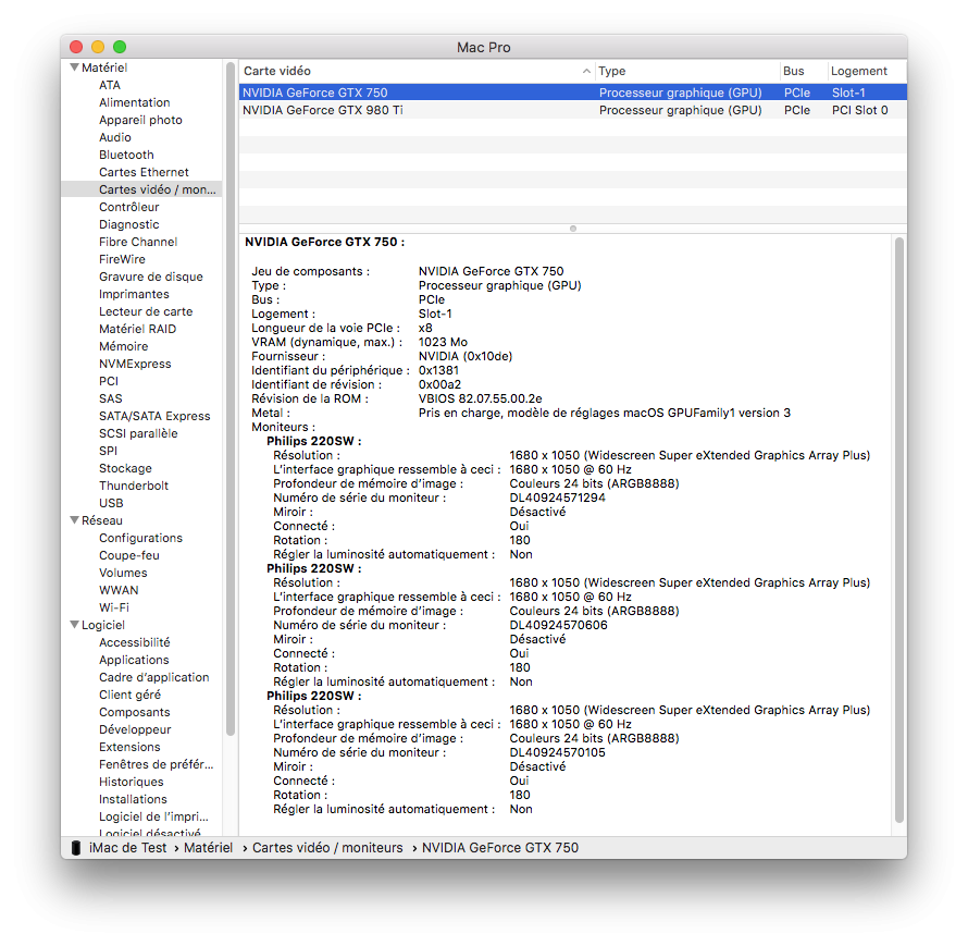

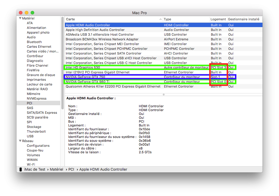

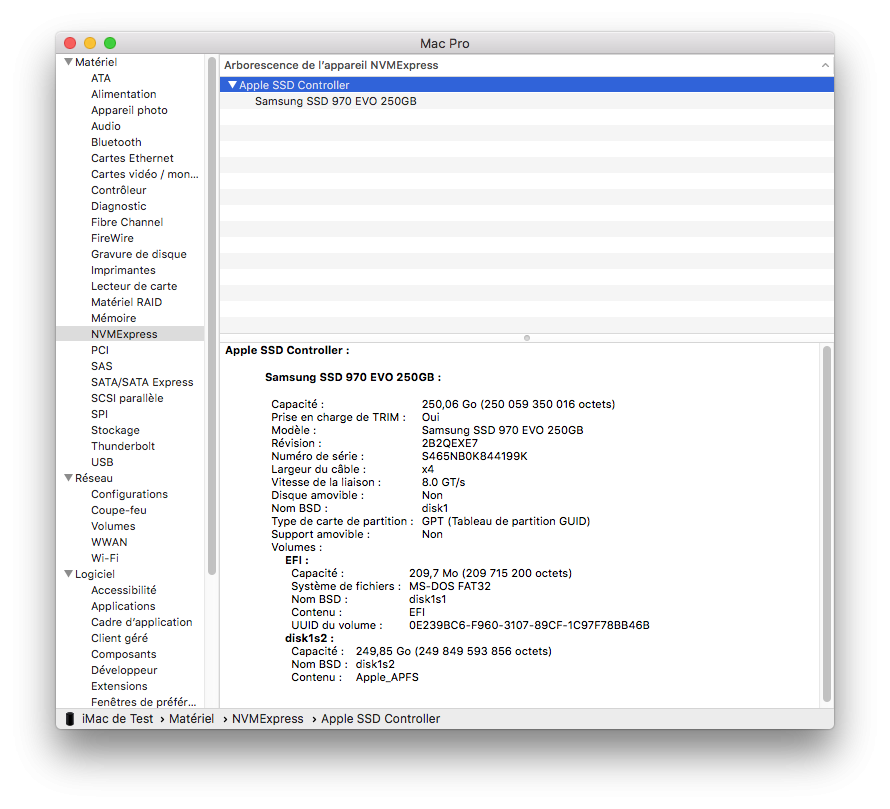

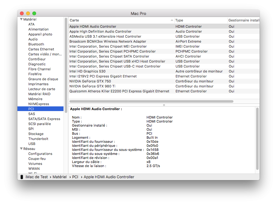

blackhole63 Posted November 27, 2018 Share Posted November 27, 2018 Thank you for helping me because everything related to DSDTs and SSDTs I do not know anything ... !!! So here is the new "Send_Me" + some pictures. Currently, to operate the 3 screens on the GTX750, I am forced to plug them in hot. I start with my 4 screens on my GTX980Ti and once on the desktop, I connect the 3 screens on the GTX750. If not my 7 screens bugs (artifacts, glitch, freezes, black-screens, these symptoms are random but each time my Hack is not usable) I have not connected the SSD M.2 SATA (it's voluntary), so when I want to add the latter, what should I do ... ??? Send me iMac-de-Test.zip Link to comment Share on other sites More sharing options...
MaLd0n Posted November 27, 2018 Share Posted November 27, 2018 2 hours ago, blackhole63 said: So here is the new "Send_Me" + some pictures. take one shot DSDT.aml.zip extract new SEND_ME after reboot Link to comment Share on other sites More sharing options...

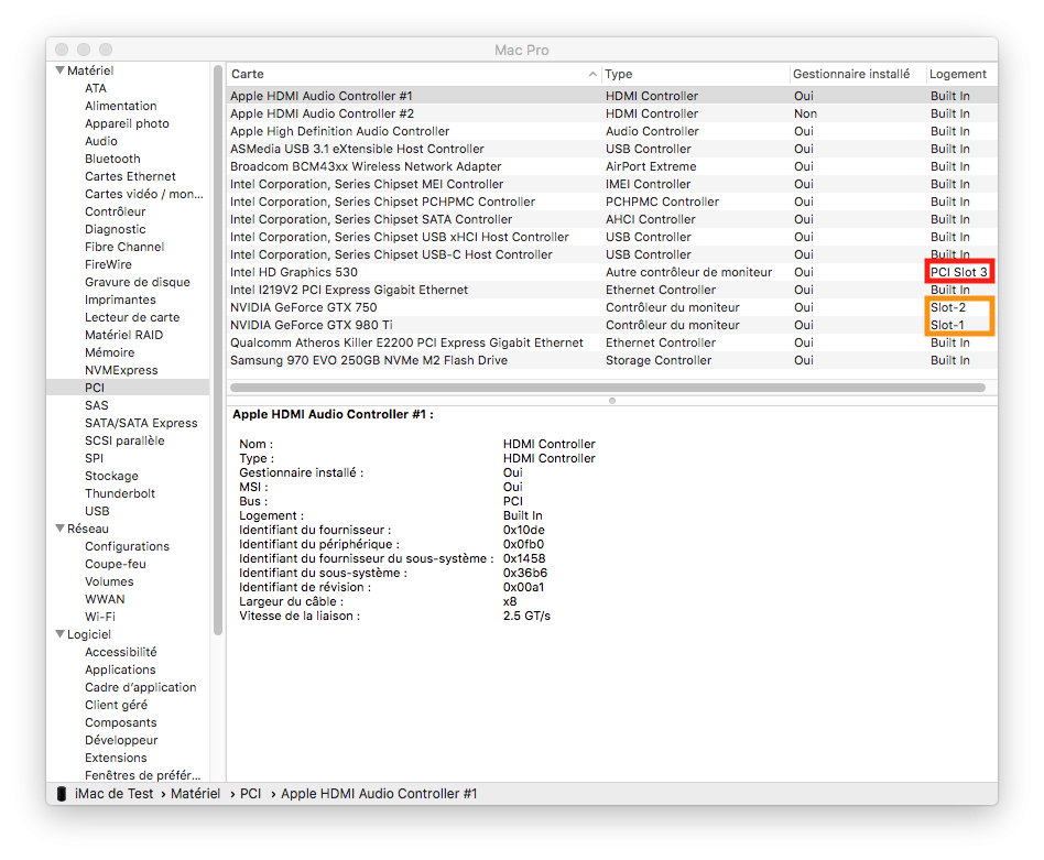

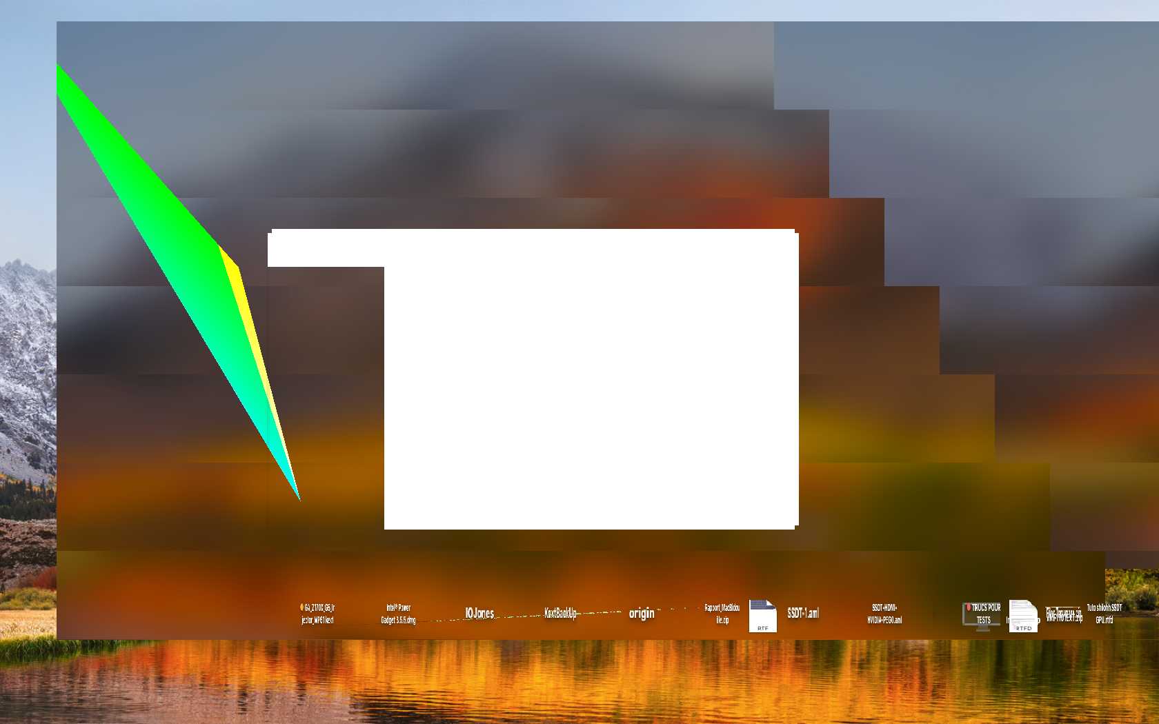

blackhole63 Posted November 28, 2018 Share Posted November 28, 2018 Here are new photos with your new DSDT: - Info "PCI", with my 2 GPUs recognized a "Slot-1 & Slot-2" and my iGPU in "PCI Slot 3". - Example of my graphics problems if I start with my 7 screens connected "cold", while if I boot as previously explained (hot connection of the 3 screens on the GTX750), I have almost no problems. I do not understand where these problems can come from ... And that annoys me ... Send me iMac-de-Test.zip Link to comment Share on other sites More sharing options...
MaLd0n Posted November 29, 2018 Share Posted November 29, 2018 On 11/28/2018 at 3:28 AM, blackhole63 said: Here are new photos with your new DSDT: - Info "PCI", with my 2 GPUs recognized a "Slot-1 & Slot-2" and my iGPU in "PCI Slot 3". - Example of my graphics problems if I start with my 7 screens connected "cold", while if I boot as previously explained (hot connection of the 3 screens on the GTX750), I have almost no problems. I do not understand where these problems can come from ... And that annoys me ... Send me iMac-de-Test.zip no idea, bro but 7 screen lol Link to comment Share on other sites More sharing options...

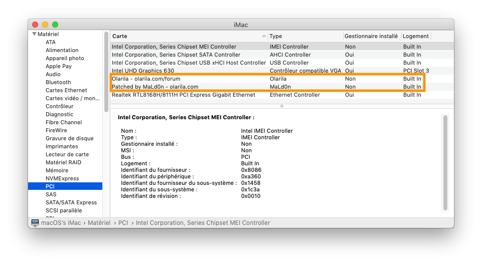

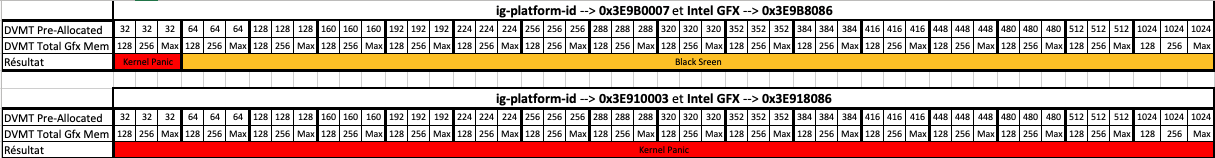

blackhole63 Posted December 3, 2018 Share Posted December 3, 2018 So, I just tried your Clover folder and unfortunately, it does not boot... I tried all the values "DVMT-Pre-Allocated" and "DVMT Total GFX Mem", and modify the values "ig-platform" and "IntelGFX", trying all the possible combinations, and I get either a KP, a black-screen. (See photo attached) The only way to boot is to set the value "0x12345678" in "IntelGFX". With the latter, it boot but I have no QE / CI (HD630 always seen with 6Mo). And in addition, with your DSDT, in the info "PCI" of the "Hardware" section, I have 2 values "about you", !!! You will also find attached a new "Send_Me" with your EFI file. The boot was done, with the manual modification of the "IntelGFX" value during the Clover boot (Options/Graphics Injector/FakeID) as mentioned above (So No-QE / CI). Send me macOSs-iMac.zip Link to comment Share on other sites More sharing options...
MaLd0n Posted December 3, 2018 Share Posted December 3, 2018 4 hours ago, blackhole63 said: And in addition, with your DSDT, in the info "PCI" of the "Hardware" section, I have 2 values "about you", !!! Send me macOSs-iMac.zip DSDT.aml.zip ur video problem is just a correct config, nothing about DSDT or Clover folder u need a correct config check here https://www.insanelymac.com/forum/topic/335018-intel-fb-patcher-v165/ 1 Link to comment Share on other sites More sharing options...
blackhole63 Posted December 4, 2018 Share Posted December 4, 2018 Impeccable for the DSDT !!! For the iGPU, I just posted in the topic that you told me! --> HERE Thank you again for your time and your investment! Link to comment Share on other sites More sharing options...
