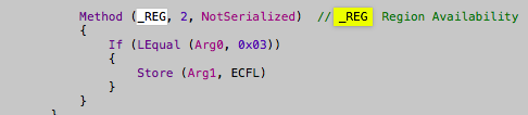

If you look at the original DSDT (the one in origin folder) there's no such code. I wonder if somebody tried to patch it before us.
Original:

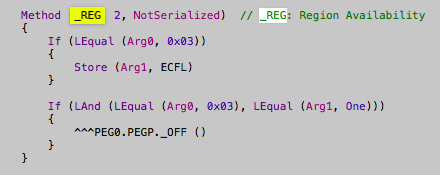

Patched:
Clearly, that was a very bad try to disable the dGPU (as you said, his gpu is under PCI0.RP05). I applied the patch to the DSDT located in patched folder, because i saw a PNLF device (i'm not aware of hacks that support natively brightness, so i imagine he added that), but maybe it was better to start from the original.
